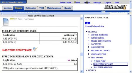

My fuel prressure is 40 psi and bleeds down to about 38 and holds steady How do I know if it's the pimp or regulator?
Saturday, September 27th, 2008 AT 10:51 AM
  • 75,992 POSTS
See below fuel pump psi specs
https://www.2carpros.com/forum/automotive_pictures/12900_fuelpump_1.jpg
Saturday, September 27th, 2008 AT 2:32 PM
ROB1972
  • 5 POSTS
I know my pump pressure is out ofg specs, should I eplace the pump?
Saturday, September 27th, 2008 AT 6:20 PM
  • 75,992 POSTS
EFI system don't like incorrect fuel pressures-reommend replacement
