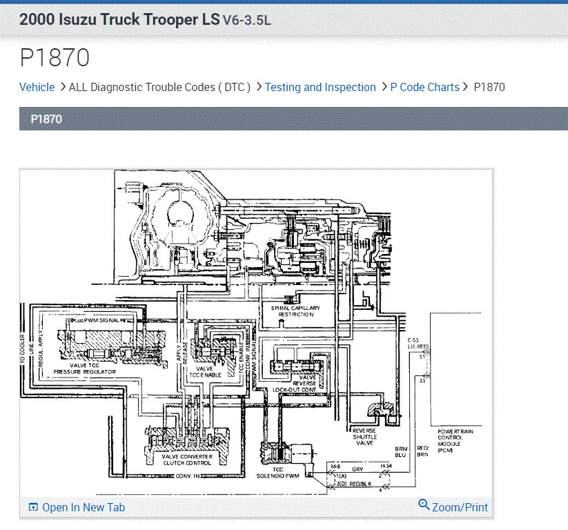

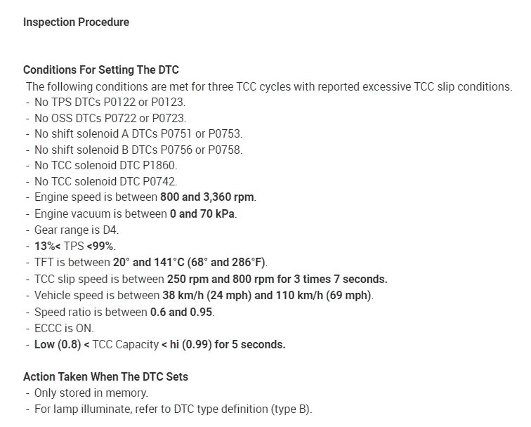

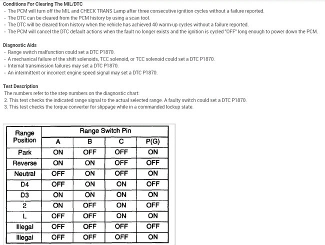

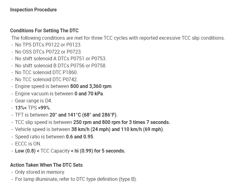

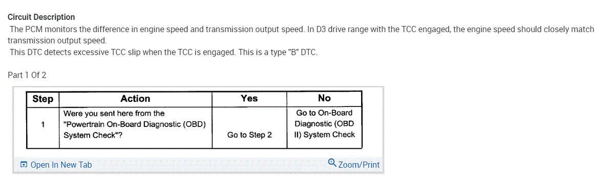

The code indicates that when the vehicle is in fourth gear and the torque converter clutch is engaged (overdrive), there is excessive slippage. This is based on information from the input and output speed sensor.
The code can be set by things like low transmission fluid, if you are towing in overdrive, or if there is an internal fault with the transmission.
Pay attention to driving at highway speed to see if you notice any slippage when the vehicle is in overdrive.

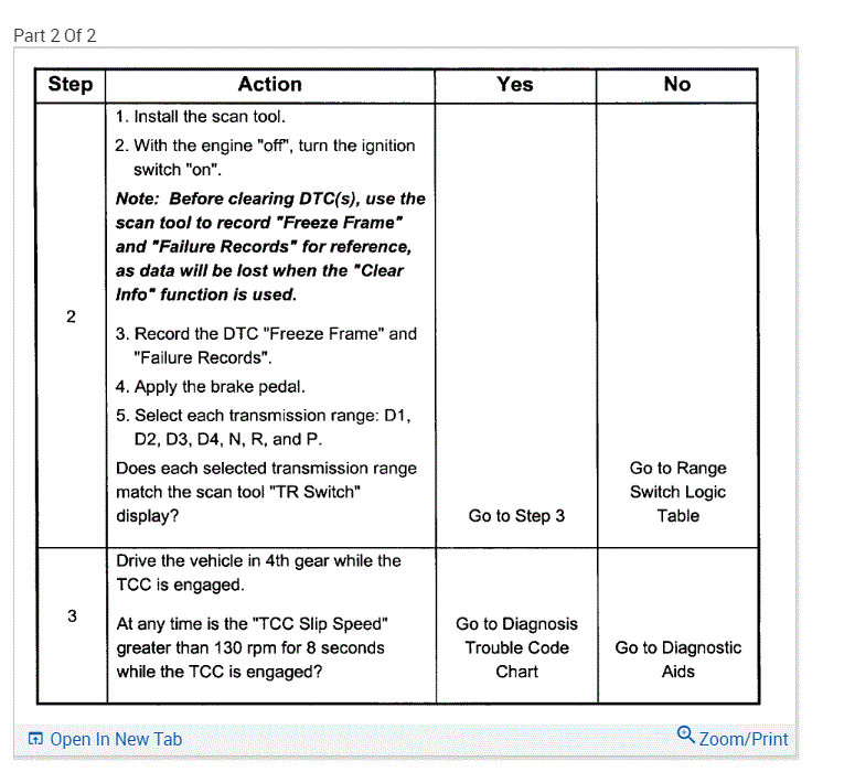

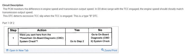

Also, let me know if you have a scan tool that can communicate with the powertrain control module. If you do, I have diagnostics for the code I would be happy to send you. Actually, I just included them below.

would you recommend that I show the diagnostics to my mechanic, or will he likely have access to such?

Chances are he will have a manual with the directions. However, it wouldn't hurt to print them and take them with you.
