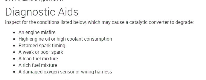

Check engine light has stayed on. Code that is coming from it is p0420. Even after cleared. Rebuilt motor has been put in, catalytic converter has been replaced twice, and a new fuel cap has been put on. Car never overheats or makes it to the middle hot/cold line. Can be slow to accelerate when getting on the freeway sometimes, more noticeable when A/C is on. No other symptoms are noticeable.

As I believe you are aware, the code deals with a catalytic converter issue. The converter isn't performing to expectation. I have to ask if after the new catalytic convert is installed if the light stays off for any period of time because there are things that can cause the converter to fail prematurely.
Take a look at the attached pic.

Based on what you described, it sounds like something is causing it to fail prematurely.
What I would suggest trying are a few different things. First, I would check fuel pressure to confirm it is within the manufacturer's specs. Here is a link that explains in general how it is done:
Please let me know which 4 cylinder engine this has. It could be a 1.4L turbo or a 1.8L non-turbo. If you can get that to me, I can check the specifications and get back to you with the specifics.

Let me know if you have access to a live data scan tool. If you do, start the engine and check what the short term fuel trims and let me know.

I understand. What I would try is checking fuel pressure to make sure there isn't excessive pressure causing problems with the converter.
