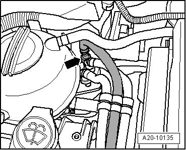

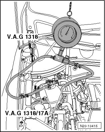

Check engine light is on. Ran the codes got; p0300, p0301, p0302, p0303, p0304. Changed the spark plugs and the coil packs and it is still on. My car needs inspected ASAP! It drives fine to my knowledge. Please help!

Hi and thanks for using 2CarPros.com. Well, as I am sure you already know, you have a misfire on every cylinder. I have to ask first, have you reset the check engine light since the work was completed? It will not automatically reset. If you have and the same codes came back, there are a lot of different things which can cause a misfire.
First, follow these directions to determine if there is a vacuum leak:
If no leak is found, follow these directions for checking fuel pump pressure:
Fuel Pressure Test
Fuel Pressure, Checking
CAUTION!
Fuel supply line is under pressure! Wear protective goggles and protective clothing to prevent injuries and contact with skin. Before removing from hose connection wrap a cloth around the connection. Then release pressure by carefully pulling hose off connection.
Remove fuel supply line - arrow - and catch escaping fuel using a rag.
¤ Press in securing ring to disengage the fuel line.
Install the fuel injector pressure gauge (V.A.G 1318) with the adapter set (V.A.G 1318/17A).
Open shut-off valve of pressure gauge set.
Switch ignition on often until fuel pressure on pressure gauge no longer rises.
Read off fuel pressure on pressure gauge. Specified value: 3.5 to 6.0 bar.
If fuel pressure is OK, check retaining pressure => [ Residual Pressure, Checking ]. See: Powertrain ManagementComputers and Control SystemsTesting and InspectionComponent Tests and General DiagnosticsDiagnostic ProceduresFuel Pump, CheckingResidual Pressure, Checking

I have attached the pictures which correlate to the aforementioned directions.
Low or high fuel pressure can cause a misfire problem. Also, an engine vacuum leak can do the same. That is why I need you to start with these two components.
Let me know what you find. Also, if you never cleared the trouble codes (check engine light) do that first and see if the same codes return.
