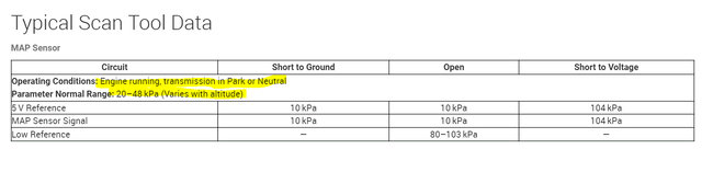

Hey Joe, I don’t have a live scan tool however the scan tool that I’m using the freeze frame shows the MAP sensor at 86K PA which I’m converting to 12.87 PSI.

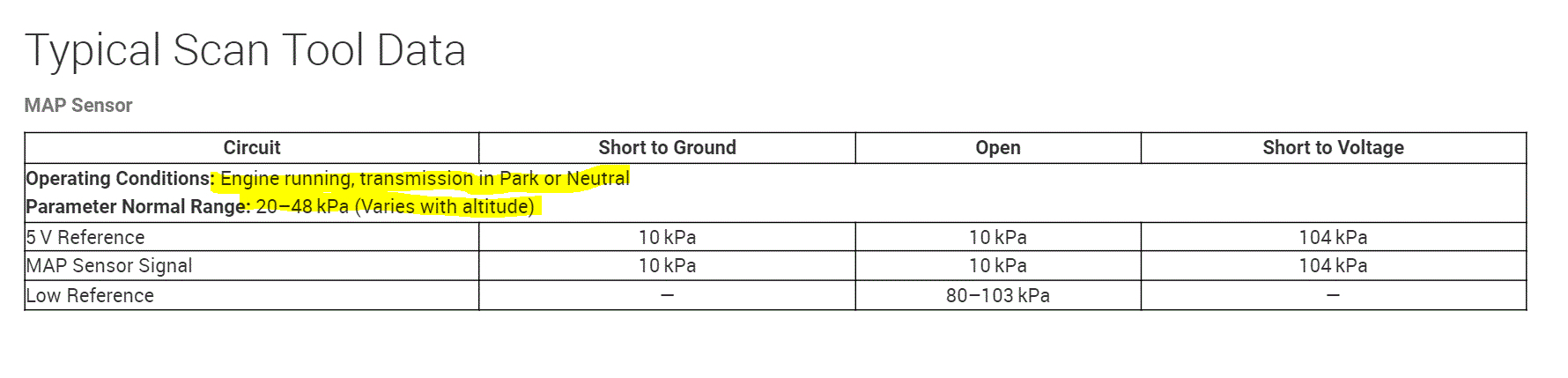

With the engine running, the reading on the scanner should be approximately 8 to 9 inHg which is approximately 4 PSI. I'm questioning if the sensors you got are good.
Take a look at the attachment. It indicates the normal range of 20 to 48 kPa based on altitude. That works out to 2.9 PSI to 6.9 psi. You are double that.
See pic below.

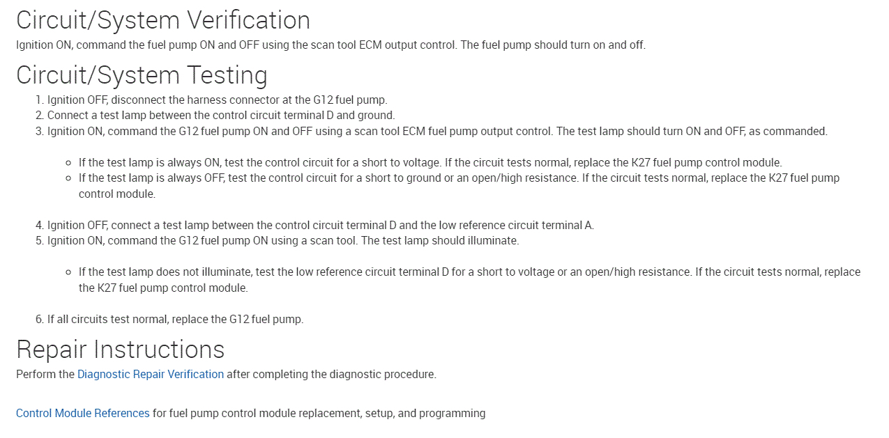

  • 109,951 POSTS

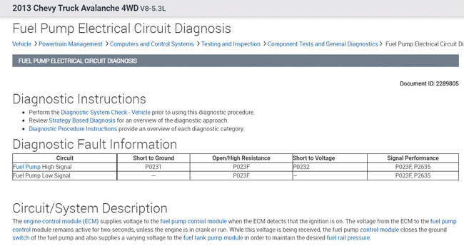

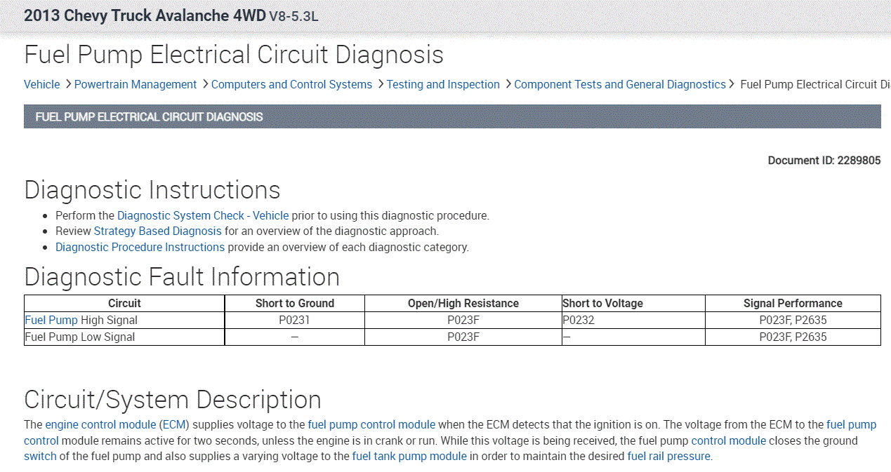

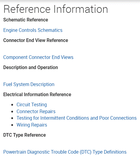

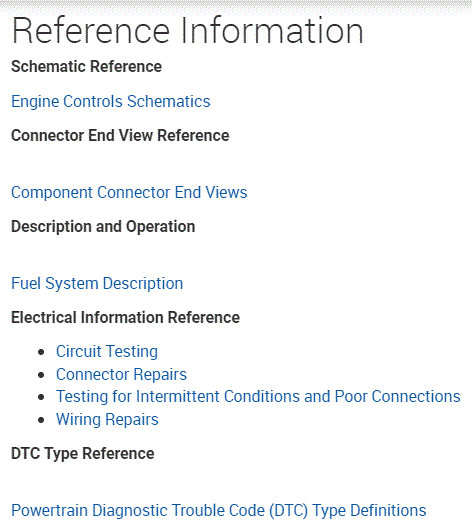

I suspect you are correct. However, even a partially plugged fuel filter can cause the issue. Also, there is a fuel flow control module mounted above the spare tire. Basically, this module is what controls fuel pressure by changing the voltage to the pump based on need.
I attached a description below along with a test you can perform to confirm if it is good or not. However, this should have set a diagnostic trouble code.
Take a look through the pics below and let me know if you have questions.

Is it always the same code and nothing different? With the engine idling the MAP reading should be between 19-42kPa or 2.7 and 6 PSI. Does it fall within the parameters?

The MAP sensor isn't reading correctly. It needs to be between 19 and 42 kPa. Have you replaced it?
