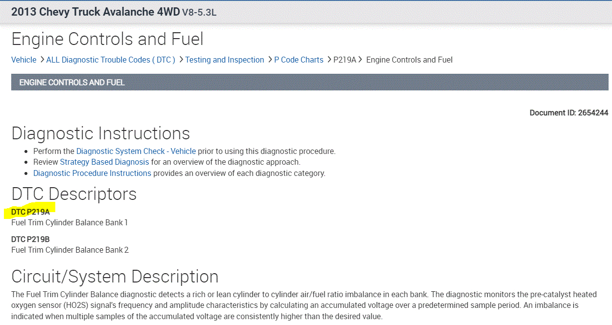

Thanks for answering my questions. DTC is P219A lean bank one. I believe that this is a generic code and opens up a lot of possibilities. Correct me if I am wrong, I believe that ltft 1 is at idle, ltft 2 is recorded from 0 to 15 mph , ltft 3 is from 15 to 30 mph and ltft 4 is from 30 to 50 mph.I ruled out a vacuum leak because the ltft went from 4% in 1 and 2 to maxed out at 33% in 3 and 4. The vehicle has a very slight rough idle when at a stoplight, however there are no issues when driving. No backfire no hesitation no stalling. If I go to WOT it takes off and hauls ass. My next attempts will be replacing the fuel filter and then checking out the fuel pump or fuel pressure regulator. I am guessing that the ECM is adding fuel to the engine after the vehicle reaches higher speeds.
Mar 30, 2022 at 12:22 AM
  • 110,244 POSTS
The fuel filter is a good idea. If it is restricting fuel delivery, it certainly can cause a lean mixture. As far as the regulator, here is a link that explains how to check the fuel pressure and the regulator:
Since the lean mixture is only bank 1, I have to ask. Are there any exhaust leaks? If you have one upstream, it can create a lean signal to be provided by the downstream sensor.

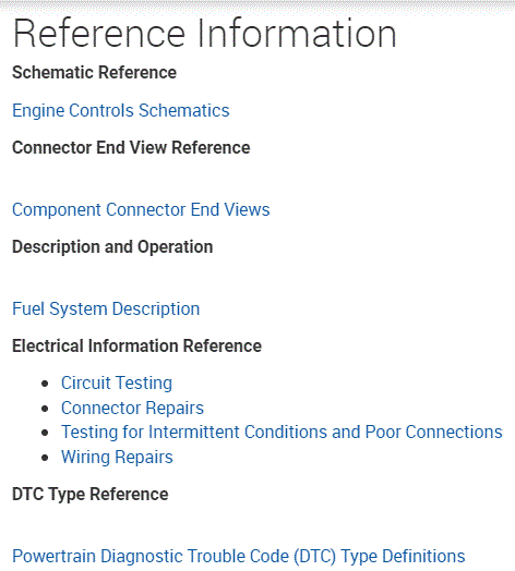

  • 110,244 POSTS

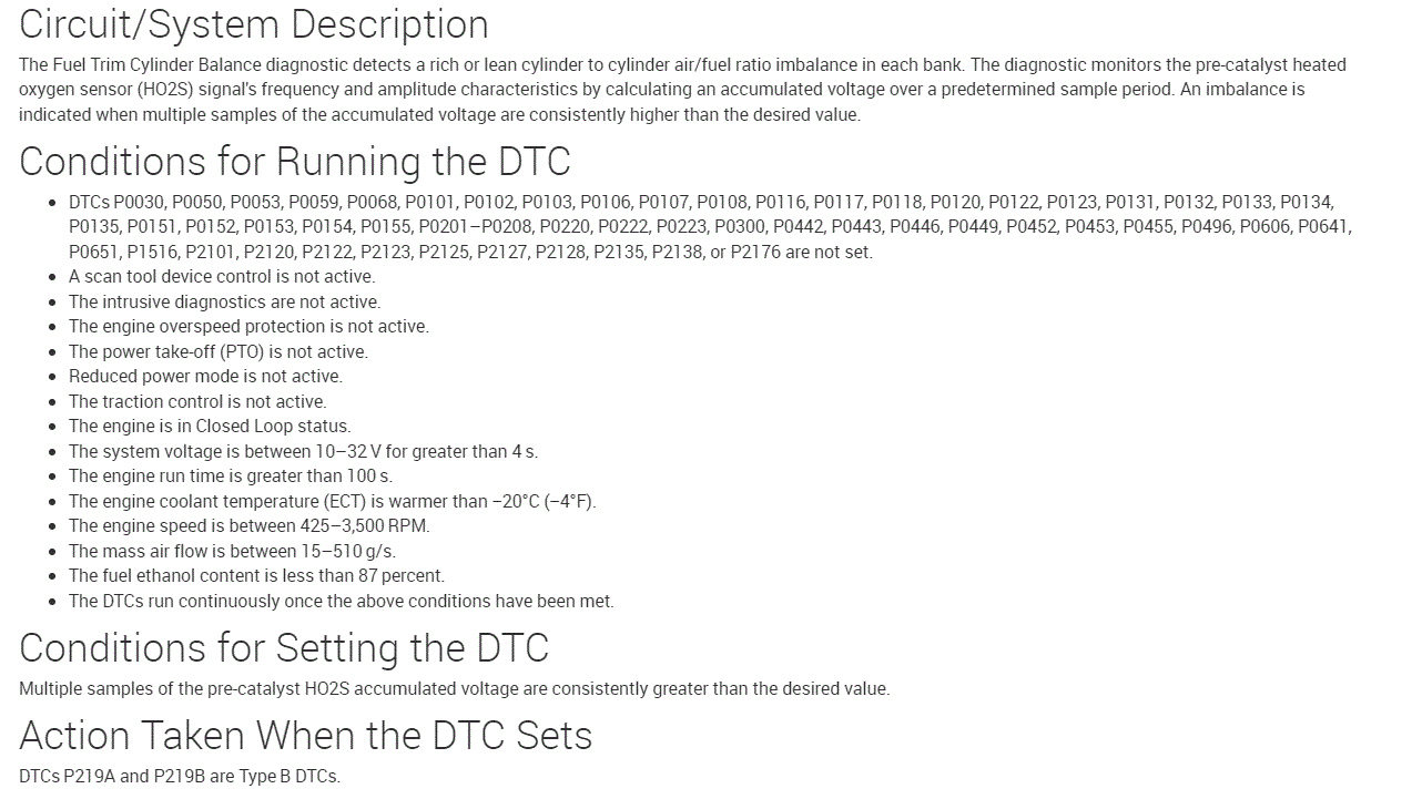

A vacuum leak would cause a lean fuel mixture. Do you know what the short-term fuel trims are? Also, since it is only one side, make sure you don't hear a ticking sound from in front of the catalytic converter (manifold) which can cause a lean mixture.
I attached the description and possible causes below. Note: that one is an exhaust leak pre catalytic converter. That's why I'm suggesting it could be an issue.
Also, toward the end of the descriptions are directions specific to circuit testing. Take a look through them and let me know if you feel comfortable doing them.
Mar 31, 2022 at 11:10 AM

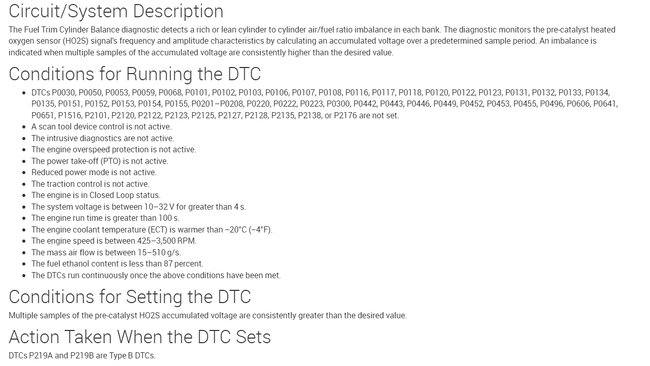

  • 110,244 POSTS
Interestingly, the P2200 isn't listed on this year and model. See pic 1.
The code itself indicates that NOx gases readings are out of parameters. In most cases, the code is set due to a faulty catalytic converter. However, that usually happened due to a different problem such as a misfire, rich fuel mixture, high fuel pressure, and the list goes on.
Again, both the P219A and the P2200 are related to bank one, so that is where the issue is.
So, I have a question. Are there any exhaust leaks? Do you have an infrared thermometer?
If you do, allow the engine to reach operating temperature. Check the temperature of the exhaust pipe before and after the bank 1 converter. See if there is a big difference in the temperature. If there is, chances are it is the converter.
If there is an exhaust leak before the converter, it will indicate a lean fuel mixture causing the computer to compensate by adding fuel. (The high fuel trim 33%)

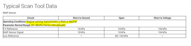

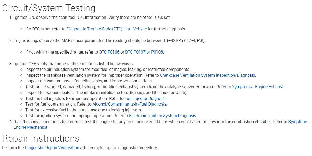

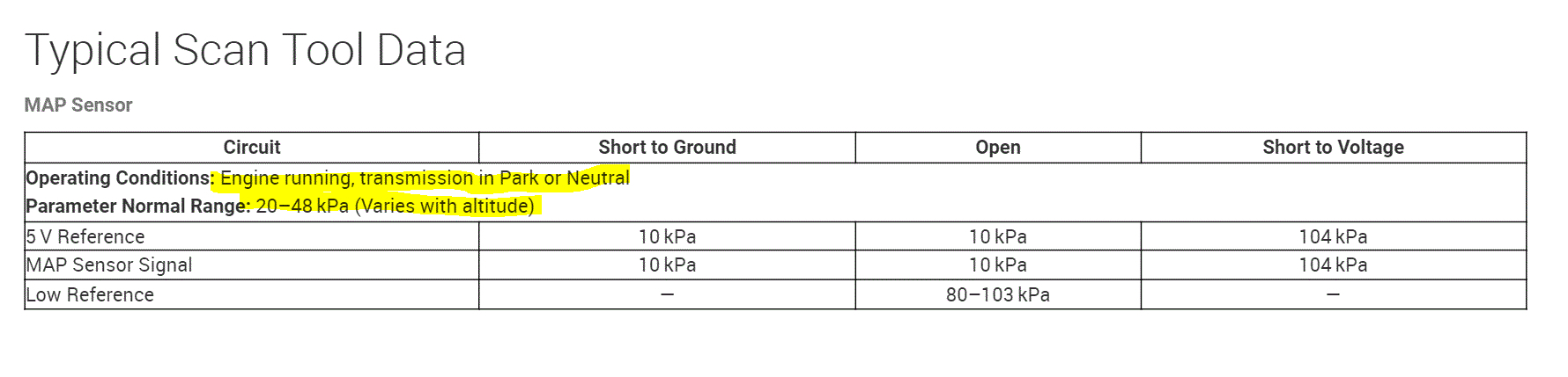

  • 110,244 POSTS
With the engine running, the reading on the scanner should be approximately 8 to 9 inHg which is approximately 4 PSI. I'm questioning if the sensors you got are good.
Take a look at the attachment. It indicates the normal range of 20 to 48 kPa based on altitude. That works out to 2.9 PSI to 6.9 psi. You are double that.
See pic below.
Apr 23, 2022 at 1:59 PM

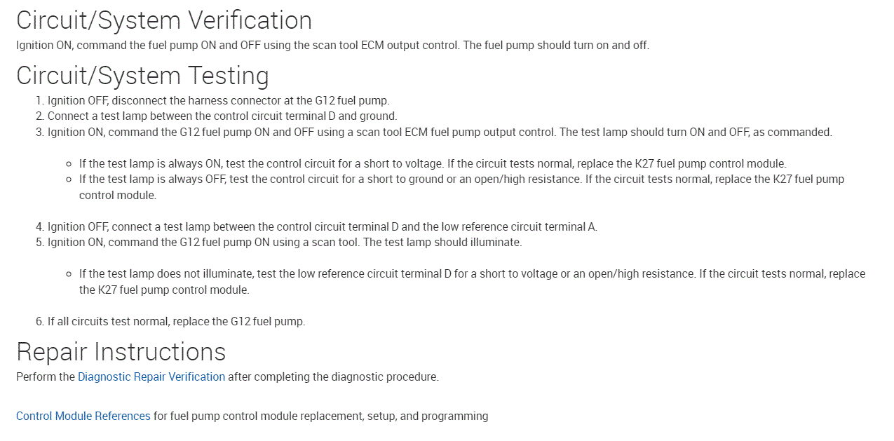

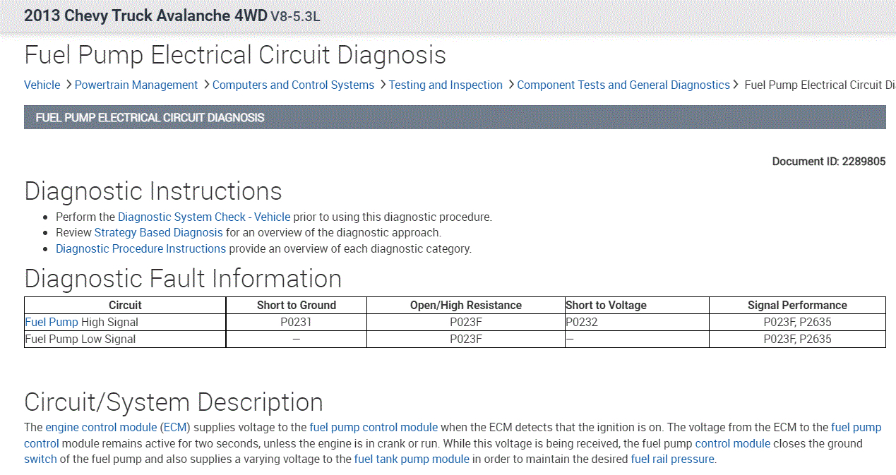

I went to O’Reilly‘s auto parts and borrowed their fuel pressure test kit. I think we may have found the problem. Let me run this by you. I applied the pressure gauge and key on engine off the pressure went to 60 PSI and then immediately fell down to 40 once I started the engine the fuel pressure went up to about 52 and then fell down to 42 and I could not get it the fuel pressure above 42. I put a load on the motor, and I tried to snap throttle I could not get it above 42 PSI. what do you think? I am thinking it's a bad fuel pump, however I will not sure how to test the fuel pressure regulator.
May 3, 2022 at 6:23 AM

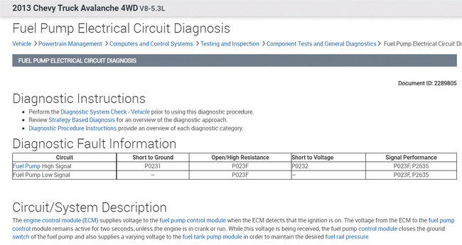

  • 110,244 POSTS
I suspect you are correct. However, even a partially plugged fuel filter can cause the issue. Also, there is a fuel flow control module mounted above the spare tire. Basically, this module is what controls fuel pressure by changing the voltage to the pump based on need.
I attached a description below along with a test you can perform to confirm if it is good or not. However, this should have set a diagnostic trouble code.
Take a look through the pics below and let me know if you have questions.
May 3, 2022 at 10:49 AM

Is it always the same code and nothing different? With the engine idling the MAP reading should be between 19-42kPa or 2.7 and 6 PSI. Does it fall within the parameters?
Also, do you notice any ticking from the exhaust pre-cat which could indicate a leak?
May 27, 2022 at 12:50 PM
CARL DEKKER
  • 26 POSTS
I always get the same two codes the first is p 219a and then the second code is the one that caused the freeze frame, and it is p2200. I have a kPa 8 7 on the manifold pressure sensor. I do not have a live reading but if you recommend a code reader for active live reading I will purchase one.
Jun 2, 2022 at 12:35 AM
  • 110,244 POSTS
The MAP sensor isn't reading correctly. It needs to be between 19 and 42 kPa. Have you replaced it?
