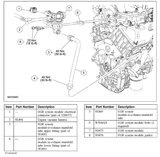

Thank you for your reply. I took those codes from a real basic reader. I will use a more detailed reader and see if I can get the voltage changes that you suggested. Not sure where the EGR solenoid is or what it looks like? Could you help me out with that one? Thanks
Greg
Jan 4, 2023 at 7:23 AM
  • 110,194 POSTS
Hi Greg, I attached a pic below showing the EGR and components. Take a look at them and let me know if that helps.
See pic below.

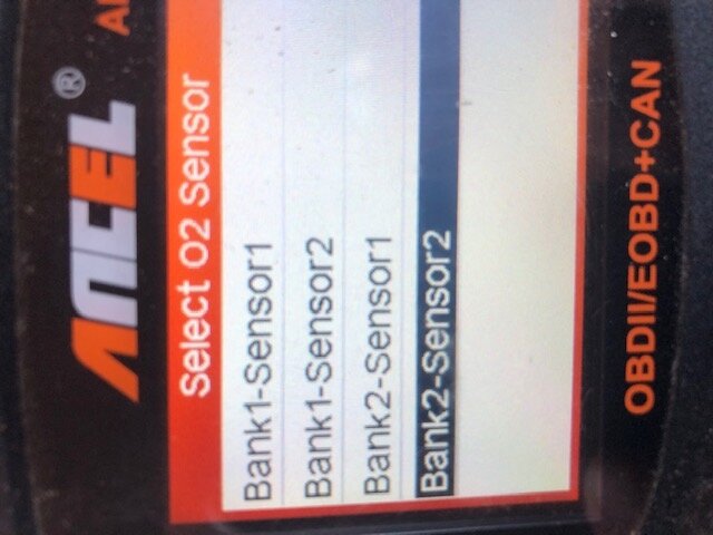

Not sure if this GIF will go through or not. Let me know. My reader does not do fuel trims.
Jan 7, 2023 at 1:30 PM
  • 110,194 POSTS
Yes, the pic did attach. It shows oxygen sensors. Are you able to check the voltage for each sensor?

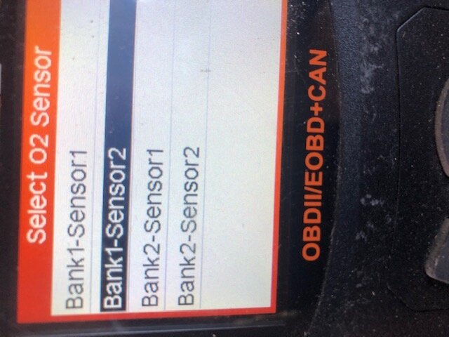

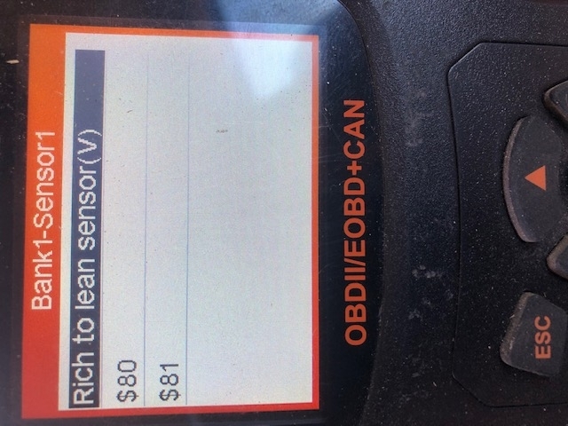

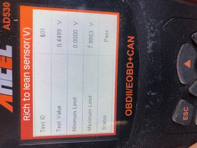

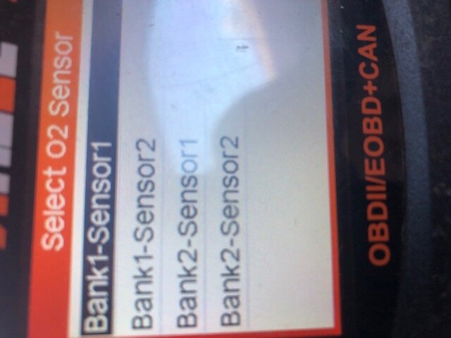

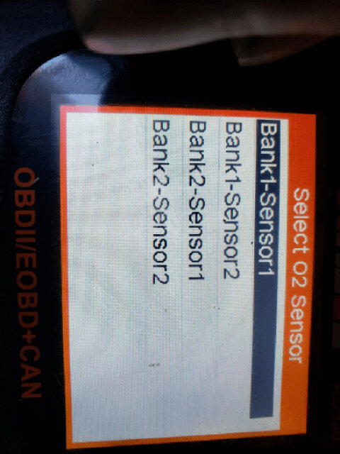

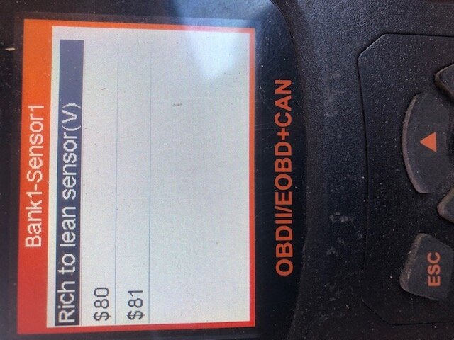

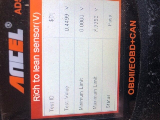

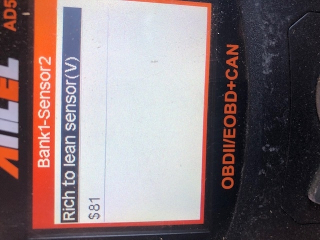

Hello Joe, I am attempting to send Bank 1 Sensor 1 reading. Let me know if you receive it and I will forward the other readings. Thank you.
Jan 12, 2023 at 11:12 AM
PAINT 4440
  • 14 POSTS

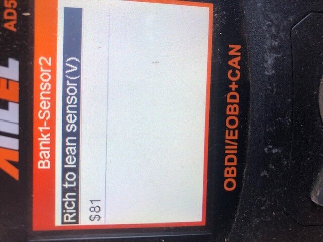

Joe, Bank1,Sensor 2.
Jan 12, 2023 at 11:19 AM

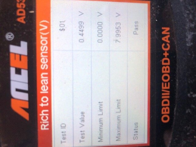

PAINT 4440
  • 14 POSTS

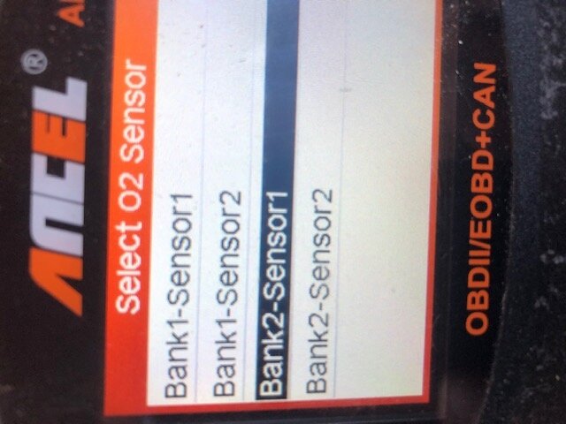

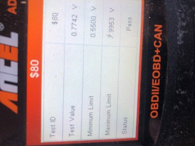

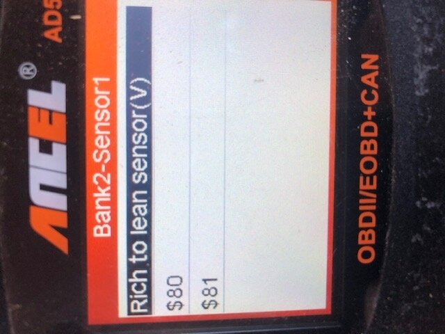

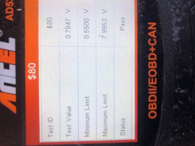

Joe, Bank 2, Sensor 1.
Jan 12, 2023 at 11:25 AM
PAINT 4440
  • 14 POSTS

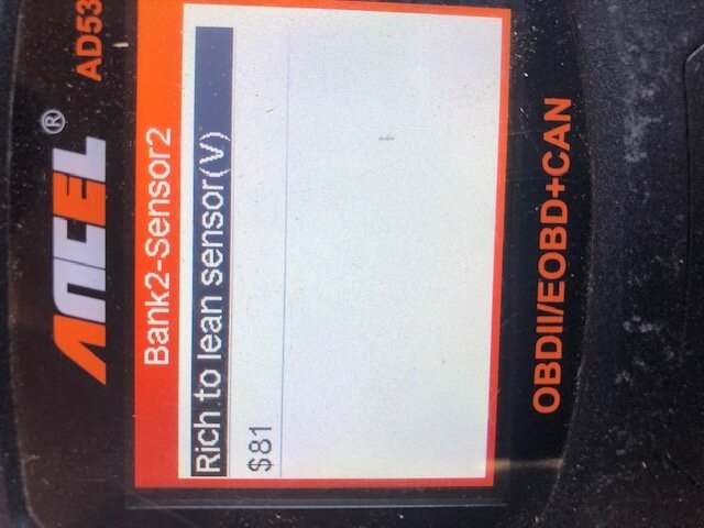

Joe, Bank 2, Sensor 2.
Jan 12, 2023 at 11:28 AM
  • 110,194 POSTS
I got them. I'm not familiar with your scanner, but everything appears okay. While the engine is running, do the voltages change when you hit the throttle? Also, were you able to get the short-term fuel trims?

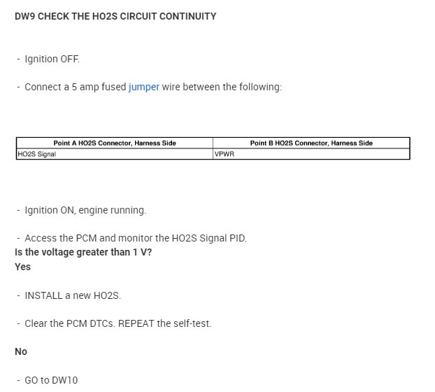

  • 110,194 POSTS
The fuel trims are good. Did you not if the voltages changed when you hit the throttle? They are at the outer limits, so I'm curious how they reacted.

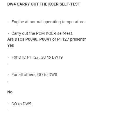

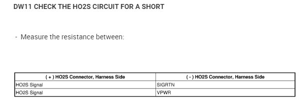

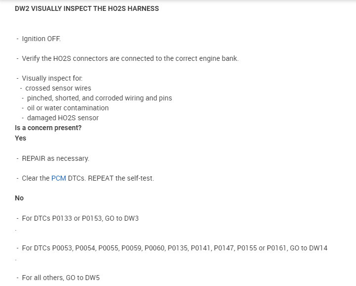

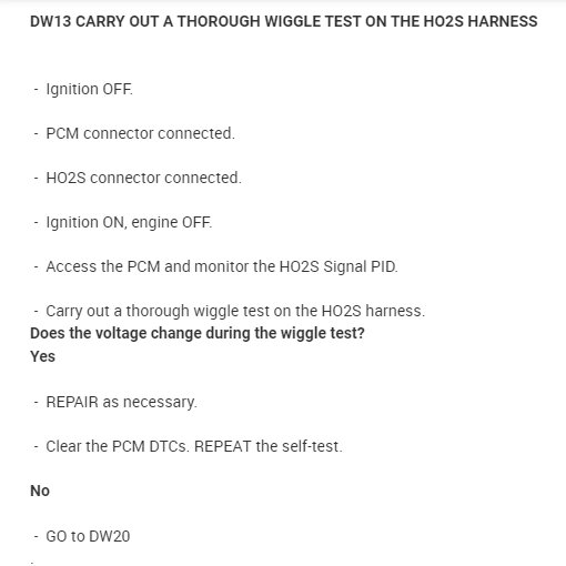

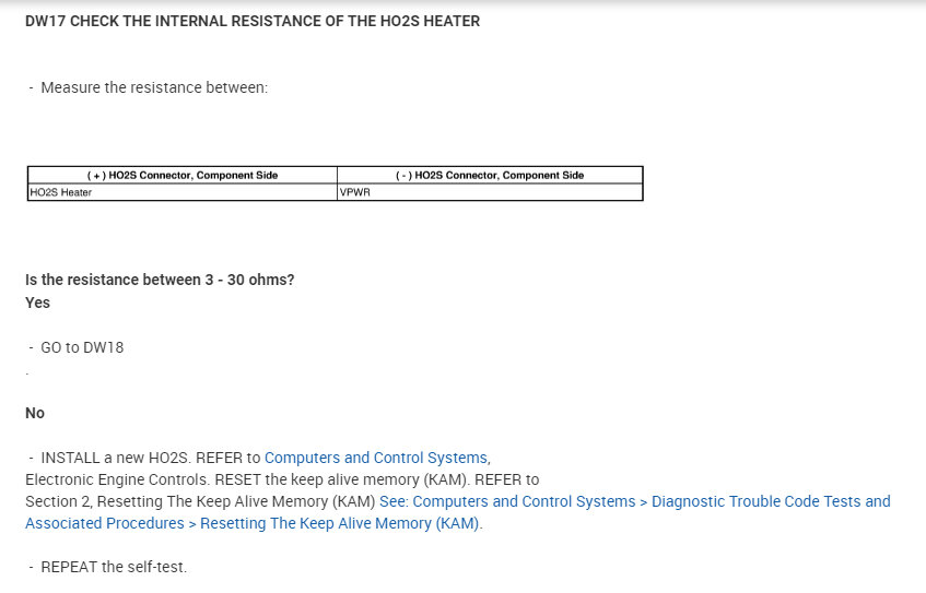

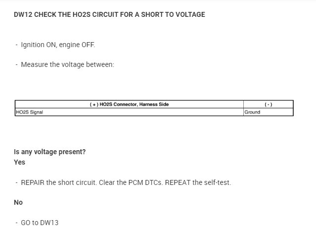

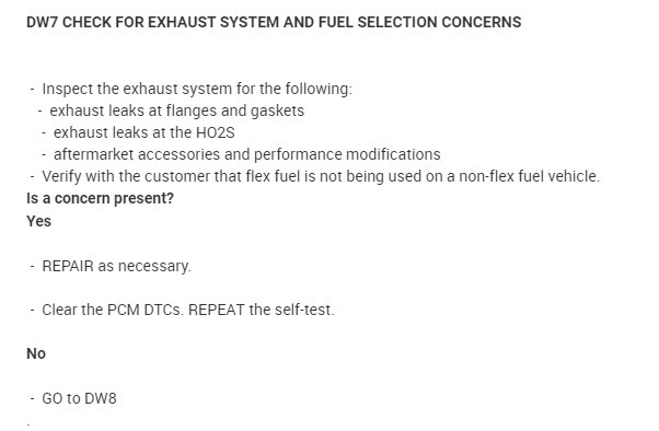

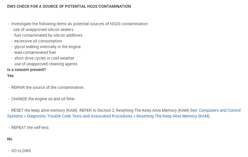

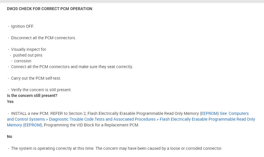

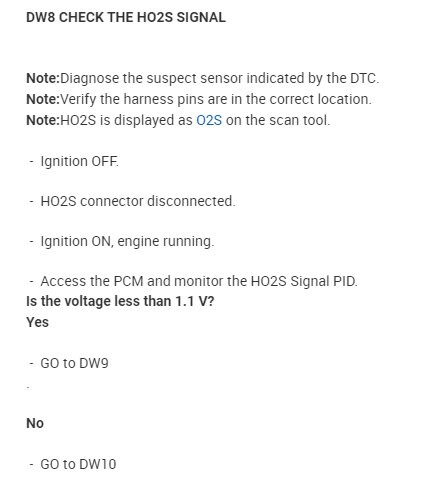

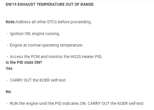

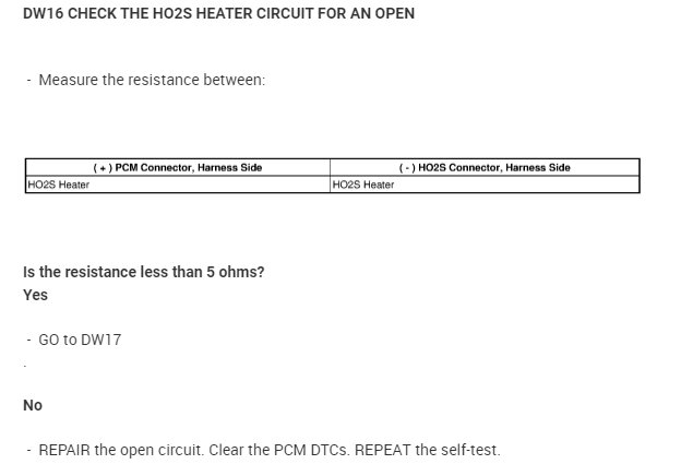

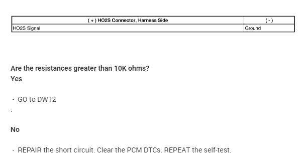

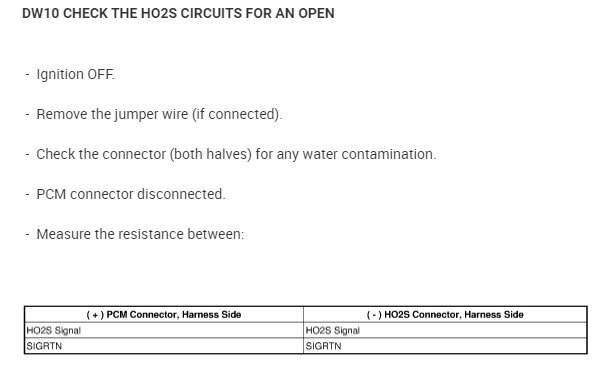

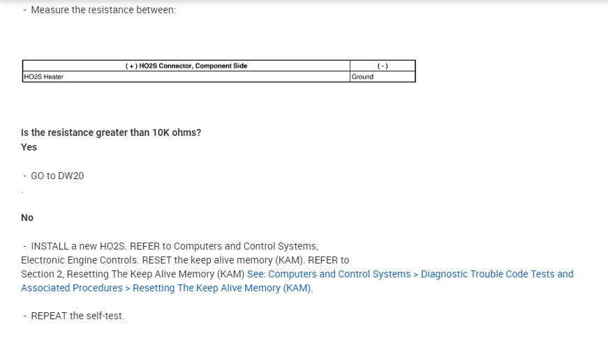

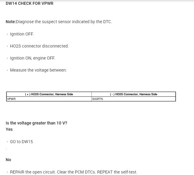

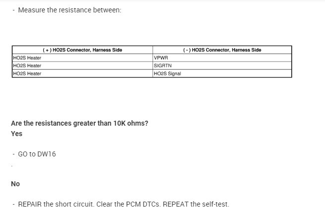

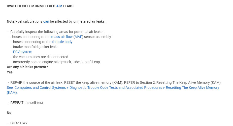

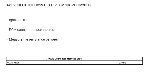

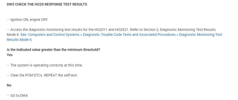

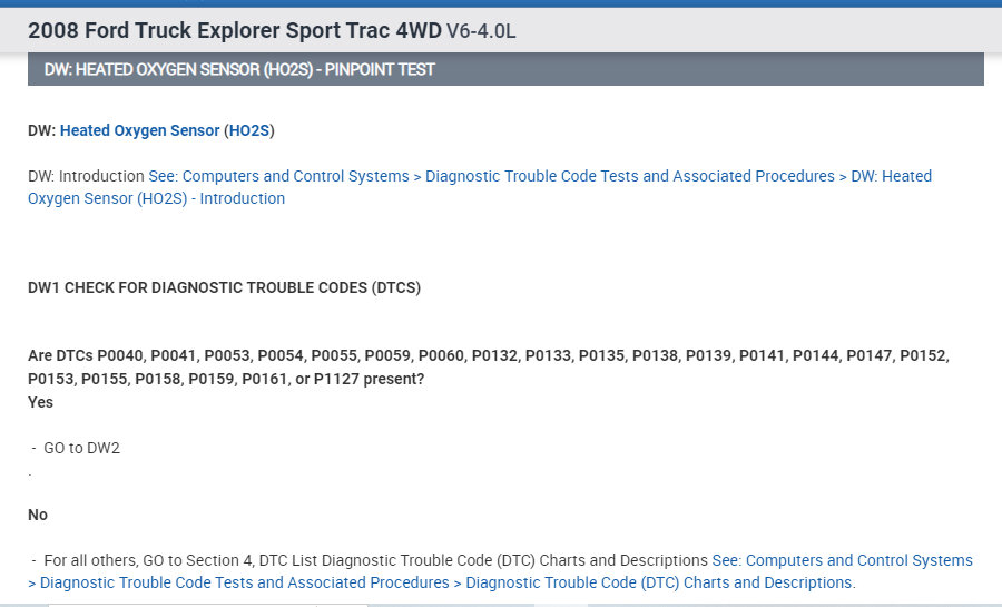

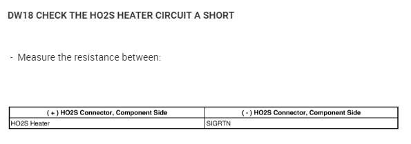

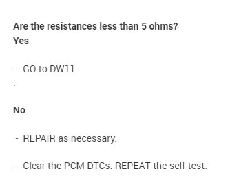

I went through the manual again. I attached the diagnostics below that we need to follow. Don't be overwhelmed. Take a look through them and let me know if you are comfortable performing them.
Take care and let me know your thoughts.
Feb 19, 2023 at 10:18 PM

I haven't started checking out the list of diagnostic info you sent but let me run something by you and get your opinion. Is it possible for a bad or going bad PCM OR ECM to throw faulty codes? The reason I ask is on this rig you can check your average mpg running through a sequence on the dash. The last time I checked this it was going bonkers. Anywhere from 8 to over 50 mpg. So, I am wondering if the computer is bad?
Thanks,
Greg
Feb 27, 2023 at 7:31 AM
  • 110,194 POSTS
Yes, the PCM could cause a false code. However, the code diagnostics are usually related to checking the PCM.
