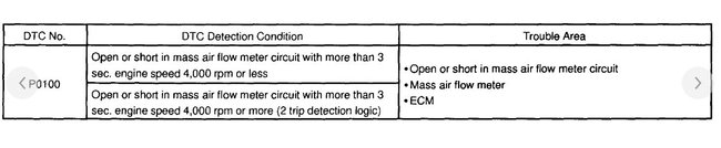

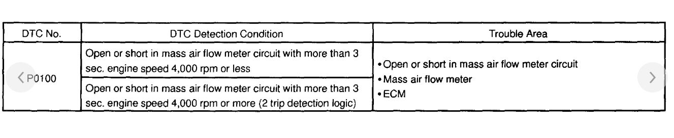

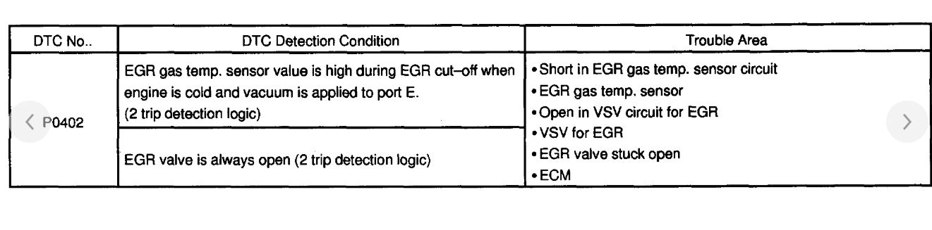

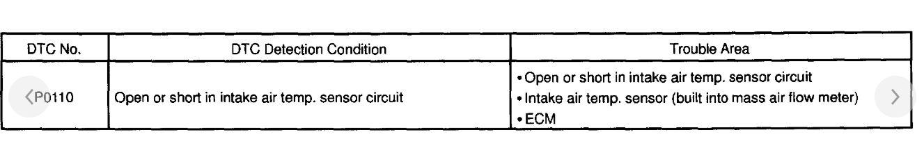

My truck seems to be running fine with no apparent issues but the CEL came on so I took it to both Autozone, then to O'reily for reading codes. Both places showed only one code: P0402. I took it to my Toyota dealer, they had codes P0100, P0110, and P0402. They reset CEL and insisted that if light comes back on then the MAF sensor ($1,100.00) needs replaced. After about 80 miles it came back on. I decided to try cleaning the MAF sensor and reset CEL. Again, it came back on. I have heard that by disconnecting the MAF sensor while the engine is running and the engine shuts off, then the MAF sensor is okay, and does not need replaced. Is this true? I did this and my engine does shuts off immediately after disconnecting MAF sensor. I have also heard that a P0402 code usually means that the EGR valve is stuck open and the dpfe sensor is probably faulty and to test that first. I would hate to replace the expensive MAF sensor, only to find out the problem lies elsewhere. Any suggestions?
Oct 15, 2018 at 9:42 AM
Good morning.
You cannot clean the mass air flow sensor. The carbon burns on to the sensor and there is no cleaner that can remove burned on carbon. There is also no reset for the sensor as well.
The test disconnecting it is not a valid test at all.
Below is some possibilities for the 402 code that needs to be checked.
Also some possibilities for the mass air flow sensor codes
The EGR system recirculates exhaust gas, which is controlled to the proper quantity to suit the driving conditions, into the intake air mixture to slow down combustion, reduce the combustion temperature and reduce NOx emissions. The amount of EGR is regulated by the EGR vacuum modulator according to the engine load.
If even one of the following conditions is fulfilled, the VSV is turned ON by a signal from the ECM.
This results in atmospheric air acting on the EGR valve, closing the EGR valve and shutting off the exhaust gas (EGR cut-off).
Under the following conditions, EGR is cut to maintain driveability.
- Before the engine is warmed up.
- During deceleration (throttle valve closed).
- Light engine load (amount of intake air very small).
- Engine racing.
