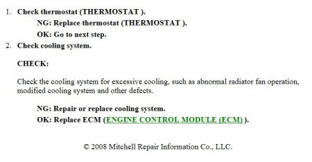

my light came on so i bought a code reader,it sowed 2 codes one was PO128 and the other said pending the disk that came with said air/fuel sensor so I replaced the 200.00 part reset the check light. well the light came back on showing the same code.
Apr 11, 2009 at 8:17 AM
KHLOW2008
  • 41,814 POSTS

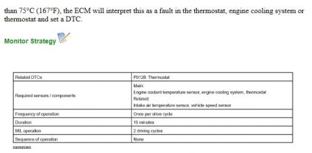

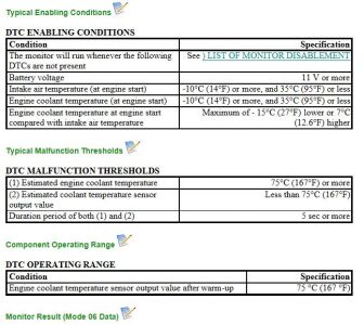

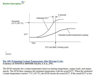

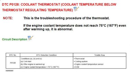

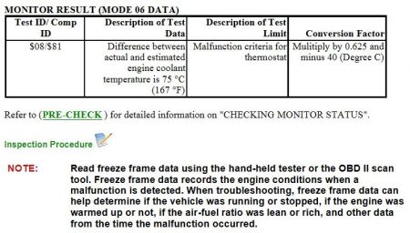

Hi reap88, What is the other code that is present? Here are the diagnostics for P0128.
https://images.2carpros.com/forum/automotive_pictures/192750_P0128_04Tacoma01a_1.jpg
https://images.2carpros.com/forum/automotive_pictures/192750_P0128_04Tacoma01b_1.jpg
https://images.2carpros.com/forum/automotive_pictures/192750_P0128_04Tacoma02a_1.jpg
https://images.2carpros.com/forum/automotive_pictures/192750_P0128_04Tacoma02b_1.jpg
https://images.2carpros.com/forum/automotive_pictures/192750_P0128_04Tacoma03a_1.jpg
https://images.2carpros.com/forum/automotive_pictures/192750_P0128_04Tacoma03b_1.jpg
