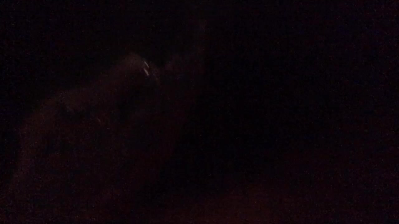

Alright here is the noise from the pump. I recorded from right under the tank. and towards the end I put my phone against the tank a few times and you can hear a change in pitch, not just in the video I could hear it myself too. like a signal or something from my phone was changing the pitch/frequency of the noise.
Apr 5, 2018 at 12:12 PM
Okay, I would replace the pump.
