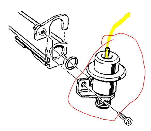

Both engine and low coolant pressure lights are on. The battery and spark plugs were recently replaced as well as adding new coolant. The car shakes a little bit, but it starts up. Upon checking the coolant tank, I saw a bit of oil mixed in.

No, I don’t see that it mirrors it. I did a diagnostic test and 2 codes appeared. P0001 and P0306. When I tried to start the car, it wouldn’t start, and the battery drained. Once I did the jump start, the car was running again. Even before the battery was replaced, the battery would get drained.

The P0001 is a fuel volume pressure sensor, which isn't relevant on this vehicle. The fuel pressure regulator on your vehicle is vacuum operated.
Since we have that code, do me a favor and locate the regulator on the fuel rail. There will be a vacuum hose going to it (see pic 1). Remove the vacuum hose and check to see if there is any evidence of fuel in it. Also, for a test only, start the engine and confirm there is a vacuum to that hose.
If there is a vacuum and no evidence of fuel in the vacuum hose, we need to check the fuel pressure to see if it is high, which would indicate the regulator is bad.
Here is a link that explains how that is done:
You will need a fuel pressure gauge, but most parts stores will lend one to you.
Next, the P0306 indicates a misfire on cylinder 6. That can be caused by several things. For example, the vehicle may be in need of a tune-up. Or the fuel pressure could be causing it.
What I would suggest is this. Since the misfire could be the result of fuel pressure, start there. The P0306 could be a result rather than the issue.
I realize this sounds like a lot. However, if you have questions, I will do my best to help from here, so don't worry about answering questions.
Take care and let me know what you find.
