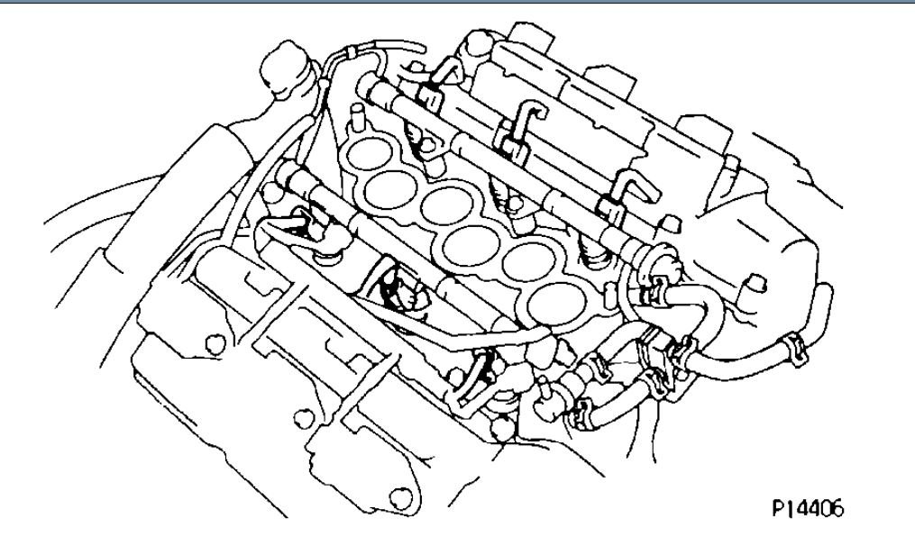

1. Remove the Intake Chamber assembly.

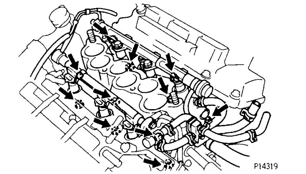

2. Disconnect Injector connectors.
Disconnect the heater hose from the Intake Manifold.
ImageZoom/Print
Remove the 9 bolts. 2 nuts, 2 plate washers and Intake Manifold assembly.

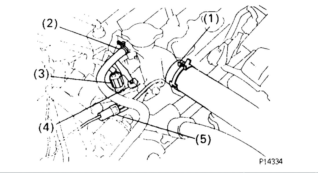

Disconnect the following hoses and connectors:
- Radiator inlet hose. (1)
- Engine coolant reservoir hose. (2)
- Engine Coolant Temperature Sensor connector. (3)
- Engine Coolant Temperature Switch connector. (4)
- Ground strap connector. (5)

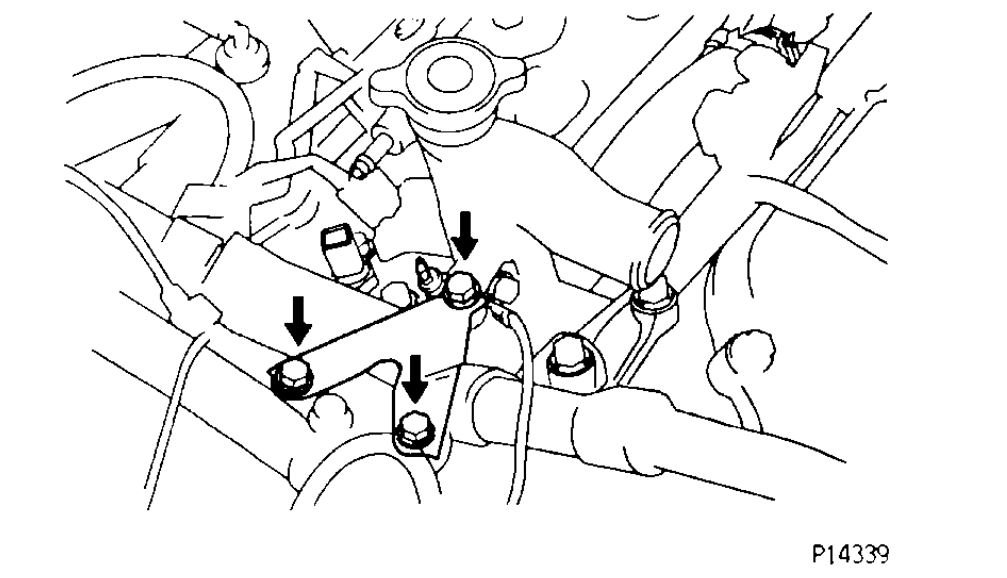

Remove the 3 bolts and right hand mounting stay.
Remove the wire band.

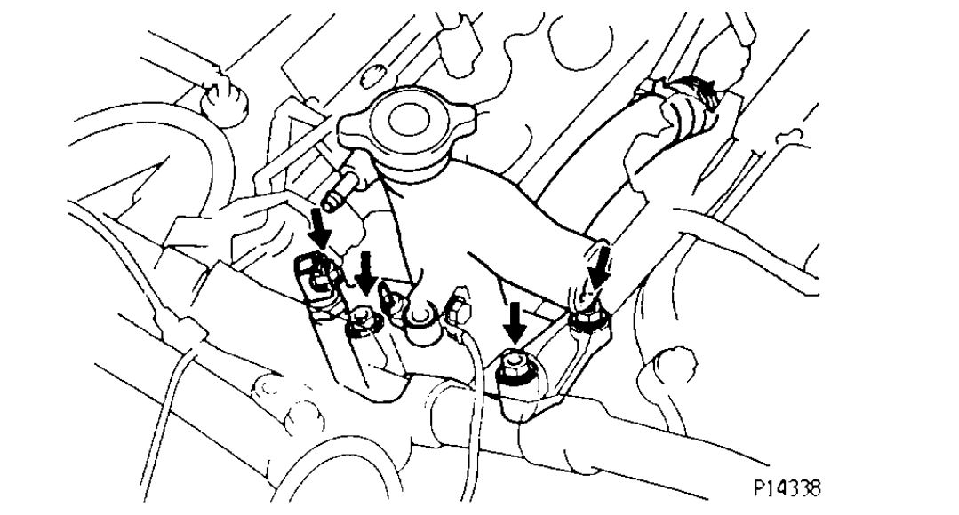

Disconnect the water bypass hose from the inlet housing.
ImageZoom/Print
Remove the 2 bolts, 2 nuts, 2 plate washers and water outlet.
Remove the 2 gaskets.
