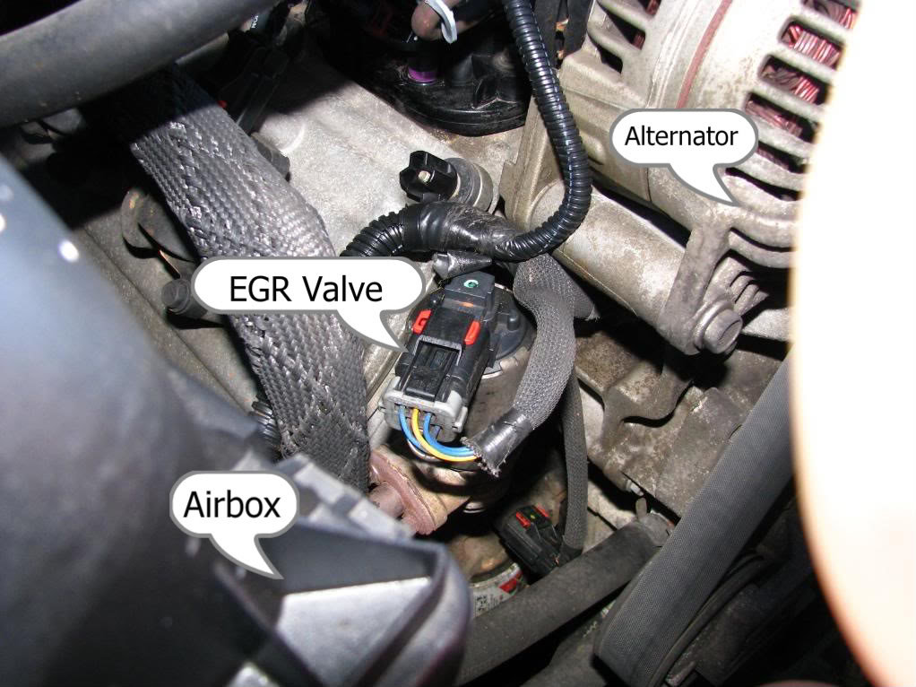

The check engine light keeps coming on. My son changed all four sensors and the EGR valve and a code comes up P0405. He also cleaned the carbon out we change the air filter and still comes on. I sometimes drive it for a day with out it coming on. And pop here it comes. Need to get my truck inspected please help.

The code indicates an EGR issue. Here is a video on how to check it:
https://www.youtube.com/watch?v=DqUCbbKdWf4
I have also attached a picture of one to help you locate it. Note: The code is generic. However, I would recommend confirming it works properly. Also, make sure the wiring to the EGR is in good condition, not damaged, corroded. A poor connection can cause a false reading to the ECM.
One last thought, remove the EGR and make sure there is not a carbon build up.
