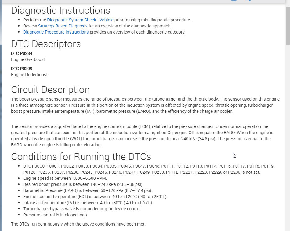

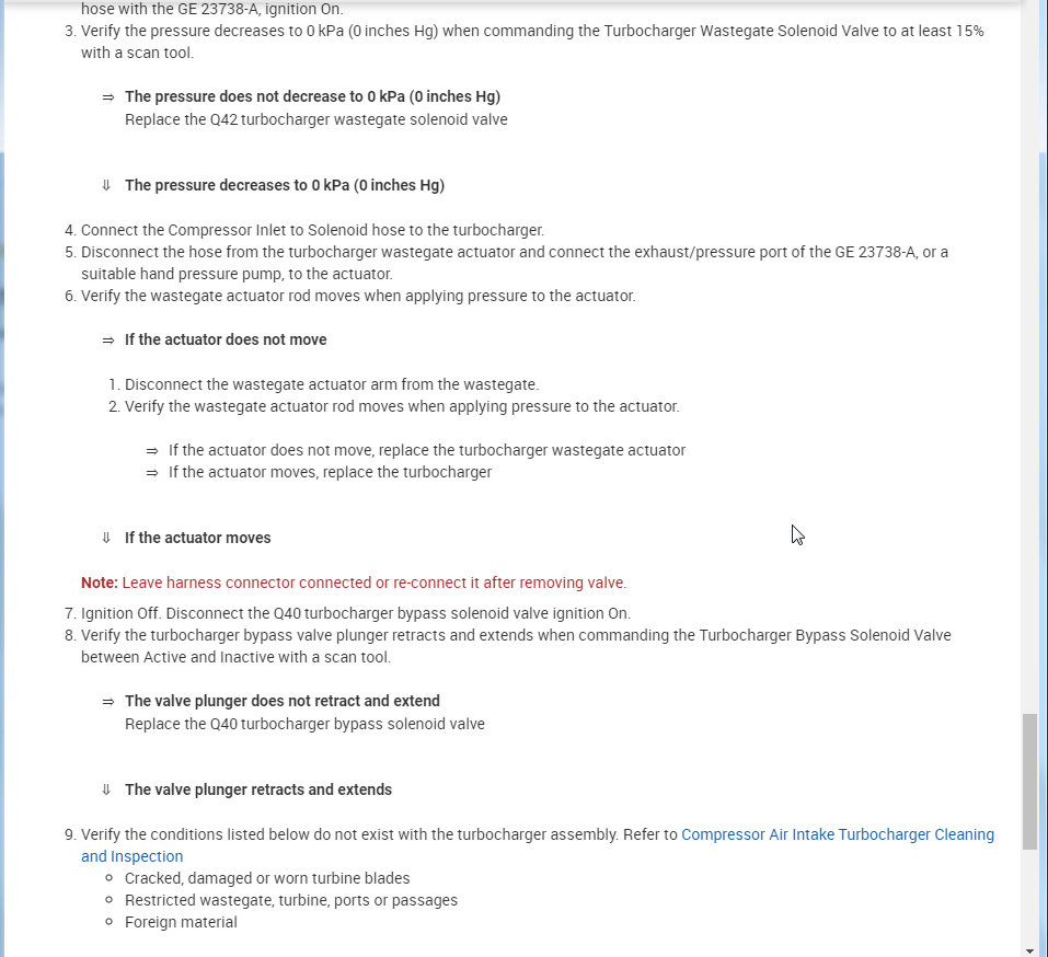

P0299 code came on for turbo under boost. Can I put a aftermarket turbo on it and not have the check engine light come back on?
Oct 16, 2020 at 10:52 AM

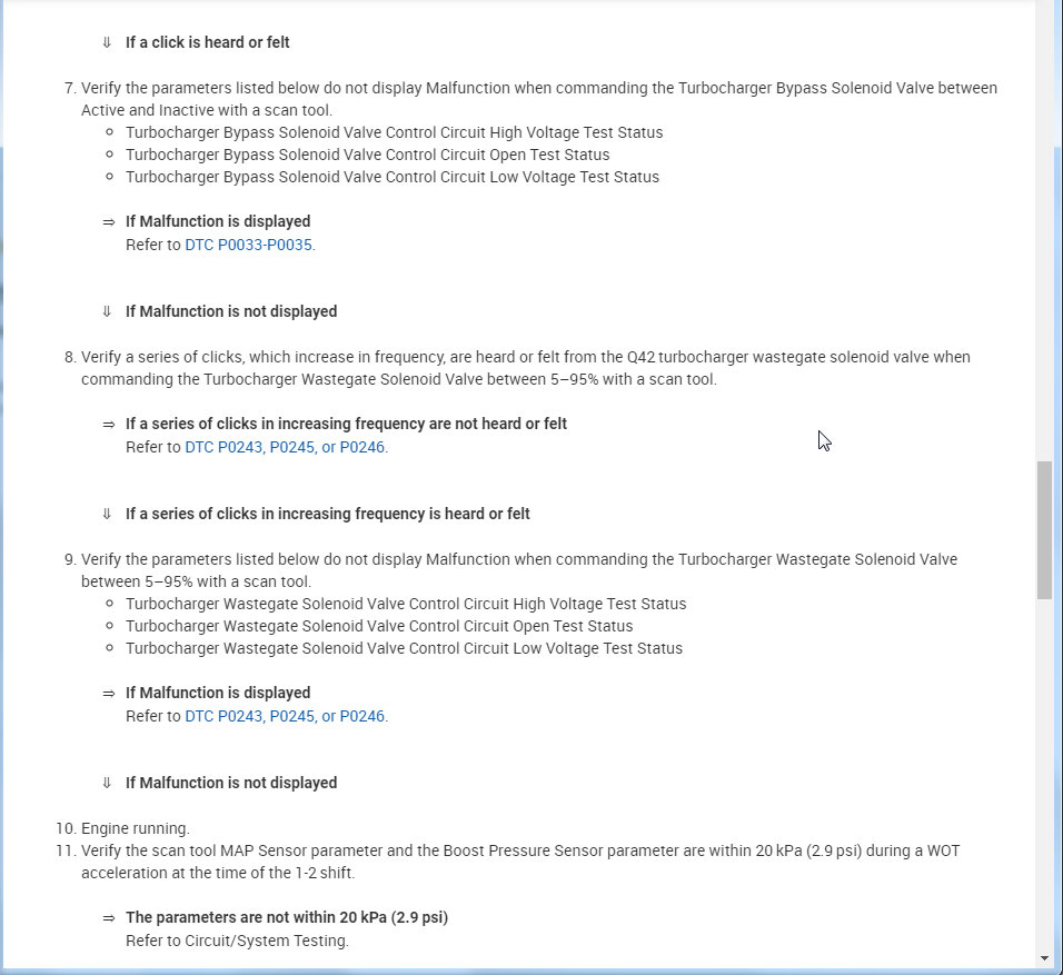

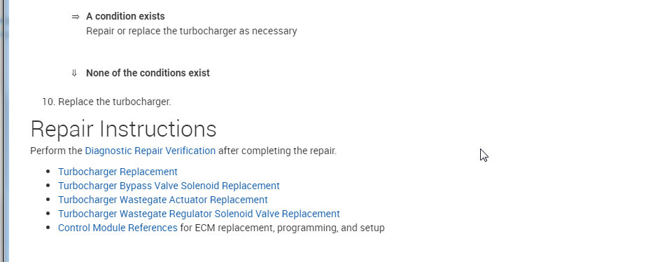

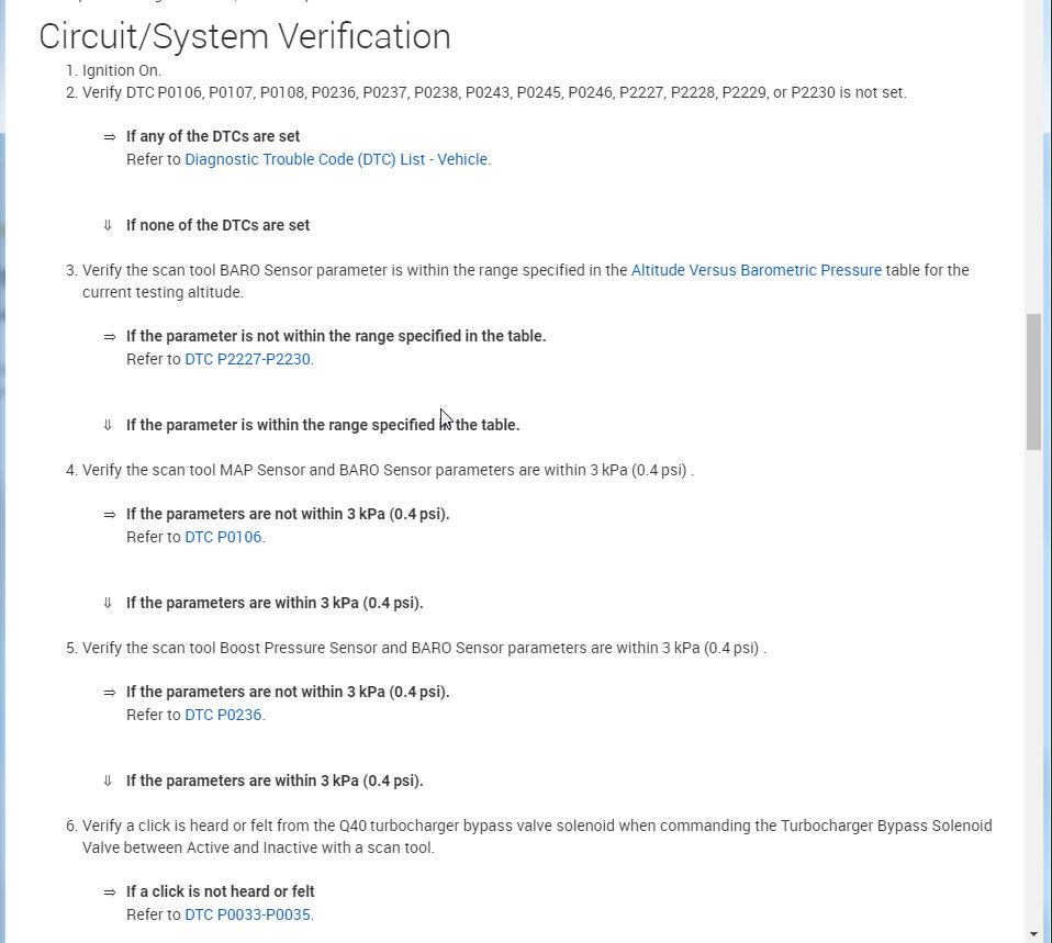

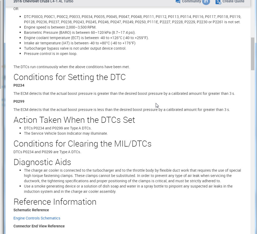

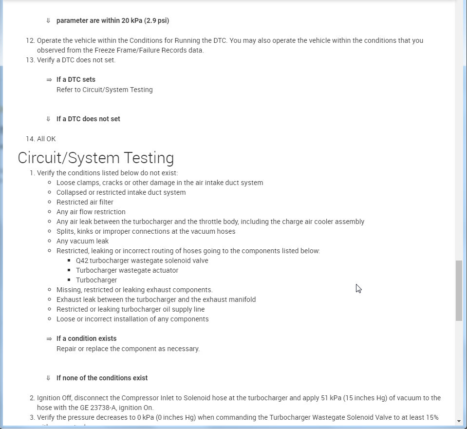

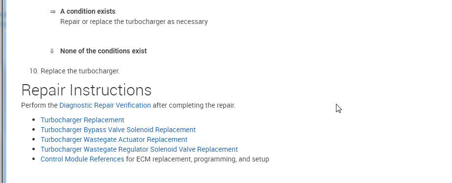

You could if the turbo is the cause of it. I would suggest running through this test and make sure that is the issue. If it turns out to be the turbo then putting an aftermarket would correct it.
Let's run through this and see what turns up. Thanks
