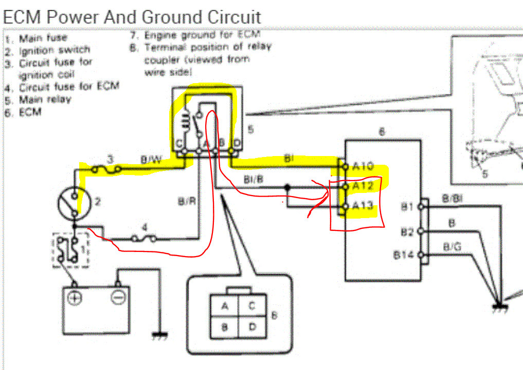

Hi. Yes, you are correct, as per that line of the chart. But the *(asterisk) by the 0 is all important.
At the bottom of the chart said the asterisk reads that voltage should be less than 0.50.
When I probed the main relay A10 (blue wire from ECM), key on, I got 0.80 volts.
So, what is that telling us?
Voltage to and from main relay are correct? Or not?
Question, with key on and main relay connected, and ECM connected to wiring Harness how much voltage I should see at main relay terminal B and D.
I know that with the main relay disconnected and blue wire (which is A10 at ECM wiring harness plug) grounded, I get full battery voltage at ECM wiring harness terminals A12 and A13.

I just read through the schematic again. When the key is placed in the run position, pin A10 at the ECM provides a ground path allowing 12v to actuate the relay. When this happens, the relay closes, and power is sent to A12 and A13. Based on what I am seeing, there should be 12v. Is that what you are getting? I see no resisters that would lower that voltage.
See pic below.

Hi, voltage at ECM pins A12-&-A13 is indeed full battery voltage.

The A10 pin from the PCM provides a ground path. It receives 12v when the PCM signals it closed. So, if you checked that circuit, you shouldn't have gotten power unless the relay was in place. So, based on what you are saying, everything is correct and should work as designed.
I have one more question before I say the ECM is the likely cause. If you remove the relay and check pin A10 for continuity to ground with the key off, what do you get?

Key Off,
Remove Main Relay,
Probe Blue Wire at Said Relay to Ground,
Ohms=3.283 million,
Plug Relay in and turn on key,
Voltage=0.80 VDC.
If it helps, the fuel pump relay is not being activated when key in in run position.
I can make the fuel pump run (listen to fuel filler) and Fuel Pressure is present at Rail.
I do have a test (yes-no) chart in my service manual that I performed twice just to be sure I was doing it correctly.
The net result was open circuit in ECM.

The ECM should complete the circuit from the relay (A10). It doesn't sound like that is happening. So, it seems the ECM is suspect.

Hi, I installed a remanufactured ECM. Key on, all dash lights on, starts and runs great. Open and closed loop both function they should.
