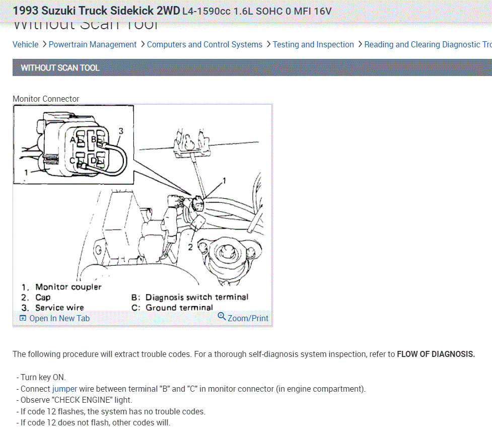

It sounds like you may have two issues. The first thing I would like to do is check for diagnostic trouble codes. This vehicle has an OBD1 system that doesn't require a scan tool.
Follow the directions in this link and let me know what codes are found:
https://www.2carpros.com/articles/suzuki-code-retrieval-and-definitions-1986-1995
I will watch for your reply.

The manual I have "sic" only says to diagnose the check engine light circuit if the light is not on.

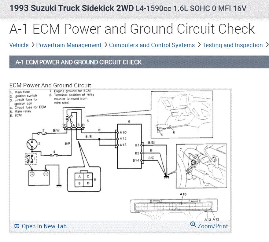

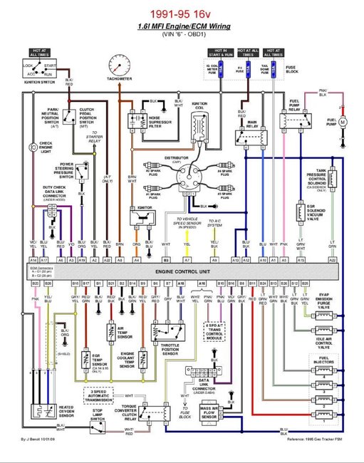

If you are jumping B and C in the connector, that's how it's done. I attached directions from the manual for you just to confirm how it's done.
Additionally, the remaining pics are diagnostics. See if they help.

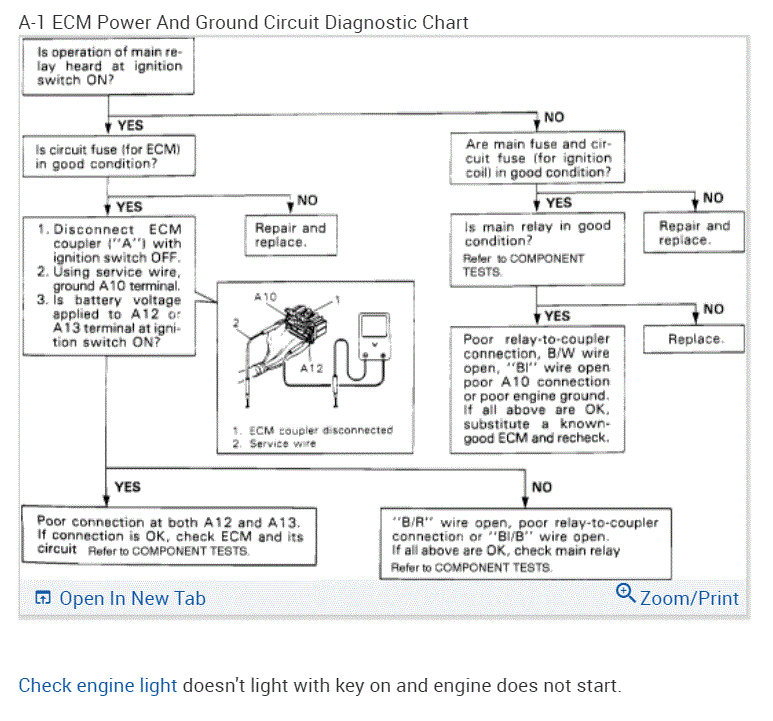

Hi, I got the main relay checks done as per the diagram pictures you sent.
Battery voltage is present where it should be. At the relay and wiring harness plug both shows B+ voltage.
the relay clicks and I can feel it as well in my hand when turning the key to run position.
I fallowed the flow (yes-no) chart twice and got the same results.
Poor connections at A12 and A13-OR-ECM and it's circuit.
I inspected the plug ends and carefully, bent-let's-say, the connections for A12 and A13 to ensure a tight connection.
No corrosion visible in any way.
upon repeating the flow chart test, I got the same results.
..."check ECM circuit"...

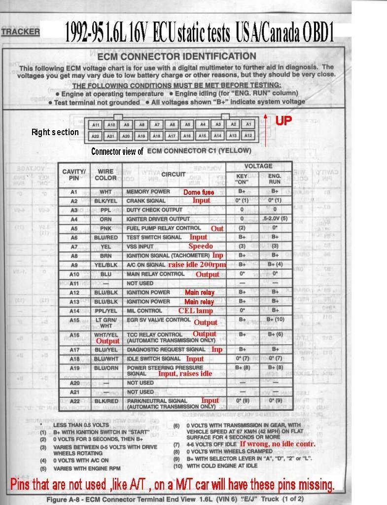

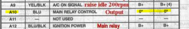

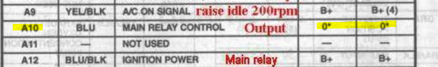

I found this on the internet.
May 17, 2022 at 3:19 PM
ED-EDD-EDDY
  • 27 POSTS
I have this picture as well. Note that cavity pin A10 claims B+ voltage should be 0.50VDC or less. I got 0.80VDC. The main relay "clicks" when turning the key to run. So, is ECM working properly then? If so, then why no CEL light and, OD/Off light blinks.
I looked for TCM diagnostic plug so I could "jump" it and retrieve any codes. No plug exists.
I'm stumped.
Curt
May 17, 2022 at 4:59 PM
ED-EDD-EDDY
  • 27 POSTS
I cannot find a diagnostic flow chart for just the CEL circuit. The Chilton manual I have for Suzuki's just says "If no CEL is lit with key on then diagnose the circuit. But no details. It is not a burned-out bulb as I can make it come on by using the Noid light reset switch.
Any ideas would help. Thanks, Curt.
May 17, 2022 at 5:10 PM
  • 110,194 POSTS
Does it indicate "B+"? That indicates battery voltage at the battery itself, so it should be 12v.
As far as the OD light, do you remember having any specific issues with the transmission? For example, did you notice slipping?

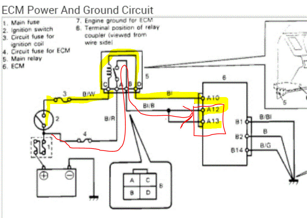

The last picture I posted is of the wiring harness at the ECM. The person who posted it claims that those are the voltages one should be seeing at the harness when probing it.
May 18, 2022 at 7:58 AM
  • 110,194 POSTS
Based on what you are telling me, it does seem there is an internal short in the ECM. I do have a question. I looked at the last pic you sent. A10 shows 0 and not B+.
Everything I have been taught has always indicated B+ is the direct battery power supply. I'm not sure what the other person is indicating.

Hi. Yes, you are correct, as per that line of the chart. But the *(asterisk) by the 0 is all important.
At the bottom of the chart said the asterisk reads that voltage should be less than 0.50.
When I probed the main relay A10 (blue wire from ECM), key on, I got 0.80 volts.
So, what is that telling us??
Voltage to and from main relay are correct? Or not?
Question, with key on and main relay connected, and ECM connected to wiring Harness how much voltage I should see at main relay terminal B and D.
I know that with the main relay disconnected and blue wire (which is A10 at ECM wiring harness plug) grounded, I get full battery voltage at ECM wiring harness terminals A12 and A13.

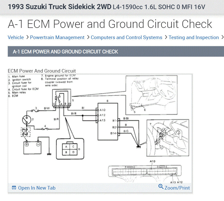

I just read through the schematic again. When the key is placed in the run position, pin A10 at the ECM provides a ground path allowing 12v to actuate the relay. When this happens, the relay closes, and power is sent to A12 and A13. Based on what I am seeing, there should be 12v. Is that what you are getting? I see no resisters that would lower that voltage.
See pic below.

Hi, voltage at ECM pins A12-&-A13 is indeed full battery voltage.

The A10 pin from the PCM provides a ground path. It receives 12v when the PCM signals it closed. So, if you checked that circuit, you shouldn't have gotten power unless the relay was in place. So, based on what you are saying, everything is correct and should work as designed.
I have one more question before I say the ECM is the likely cause. If you remove the relay and check pin A10 for continuity to ground with the key off, what do you get?
