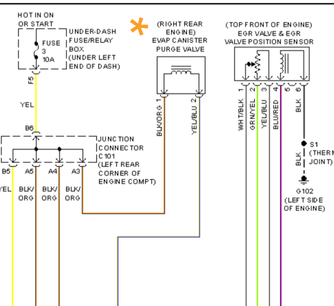

OBD II codes P0456, P0302, P0303, P0304, P0300.
Aug 26, 2020 at 2:11 AM
AL514
  • 5,654 POSTS
Hello, the P0456 is a small EVAP leak, this can be the canister purge valve, the vent valve, a leaking purge line, leaking charcoal canister, bad gas cap seal. Most likely it's the purge valve, because of the other codes p0302, p0304 are cylinder 2,3,4 misfires. P0300 is random misfire. You can try pinching off the purge line going to the intake, erase the codes and see if any come back. That's a quick check.

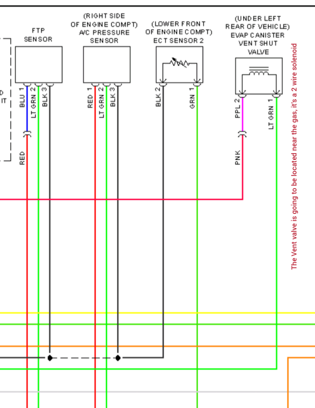

AL514
  • 5,654 POSTS
Here's the wiring diagrams for the purge valve and vent valve, this will aid in locating the correct solenoid (valve).

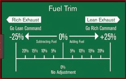

Okay, do you have any ability to monitor live data with that scan tool? I am hoping you can tell us what the o2 sensor data is telling us. We need to see if this is a rich or lean condition which will point us in the best direction for figuring out what is causing the misfire. I suspect the evap code is a separate issue but let's start with the basics.
If the exhaust is rich then the fuel is not burning which indicates a lack of spark. If it is lean it indicates a fuel issue.
Let me know this and we can keep going to next steps. Thanks
