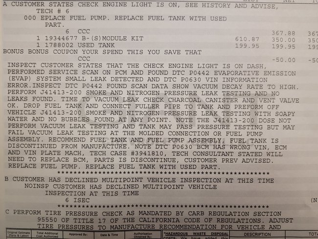

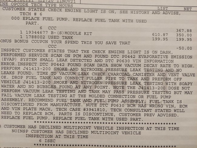

Hopefully, you were able to review the attachments that I sent of the tech's notes. Some of it I don't understand especially the one note that mentioned the vacuum was too high
Jan 6, 2022 at 1:32 AM

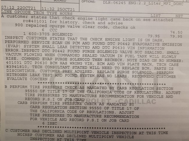

I did read them. They all make sense, and the testing is sound. The problem that I have been saying all along is they can perform the tests but if they are not understanding the results then they are going to be recommending all sorts of different parts.
This is typical when the tech working on the vehicle is just performing the test but does not understand why they are performing the test.
Unfortunately, what they are saying is there is a code for an evap leak, but they are doing all this testing and they find no leak. So, they recommend a part anyway. If they found no leak, then why are they telling you to replace a part? They can't answer that because they are just guessing at what it must be, and they have been wrong up until this point.
So, the tech notes are great to have but unfortunately, they do not lead us to what it could be because I suspect that they missed something in these tests. They are not going to write that down because they don't know what they missed.
For example, they smoke tested the system and found no smoke but didn't look in the crank case to see if the purge was leaking. All we know is they found no leaks so we assume they looked everywhere they should have but they didn't. We know this was the exact case here because they already guessed at the purge and that was not it.

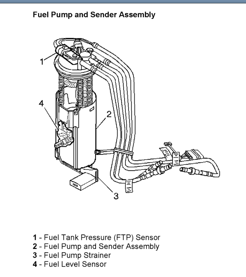

I did notice that there was no mention at all about the fuel tank pressure sensor. Do you know if it's mounted on the fuel pump or mounted on the tank or inside the tank?
Jan 6, 2022 at 9:19 AM
Yep. I think we covered that prior. You are correct. This is part of the fuel pump assembly but that is why we need to find out if it was part of what they replaced as they can get a pump that you swap it over.

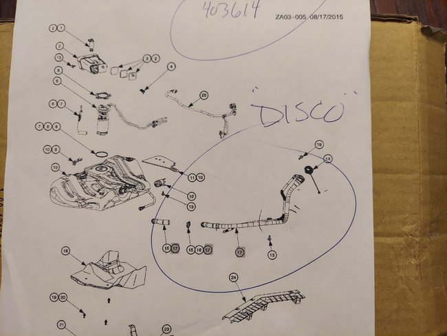

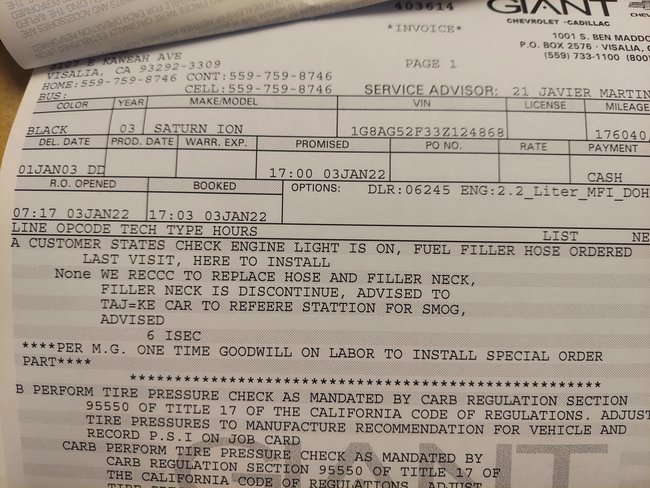

Those are good notes. That shows that the pressure sensor that I mentioned earlier was replaced.
Also, that he is monitoring the pressure as I said he needed to and finding that it is dropping. This means the code is accurate and that the pressure is dropping and there is in fact a leak.
If they narrowed it down to a filler neck then that is great but again, all these other parts were not needed.
I hope they gave you your money back.
As for the part, I would start contacting salvage yards because I am sure you will be able to find one that way.

Just to update you, I talked to a smog shop, and they said that even with the light on that it could still pass smog. so, I cleared the light and drove it 25 miles and the light stayed off and had it smogged which it passed...I have driven it a total of 65 miles and the light still hasn't come back on yet...so I'm good for another two years. Thank you for putting up with me and all the advice you gave me.
Jan 14, 2022 at 9:03 AM
Haha. That is great news. Best outcome we could have had at this point.
So glad it worked out for you. Thanks for the update.
