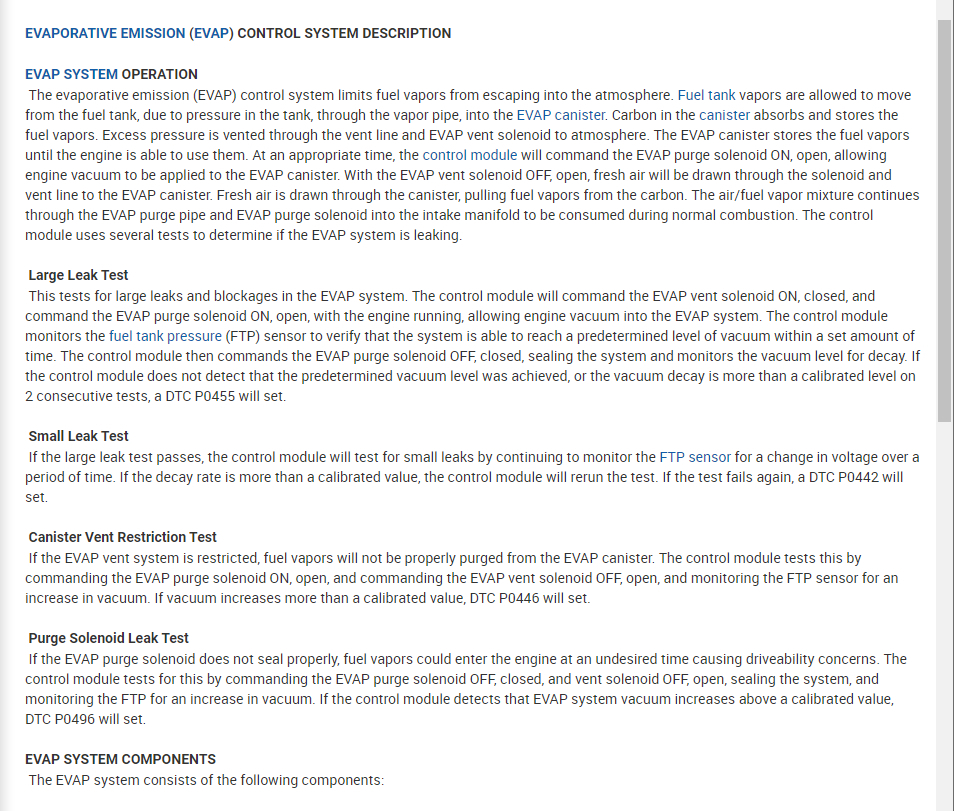

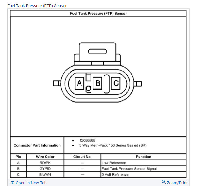

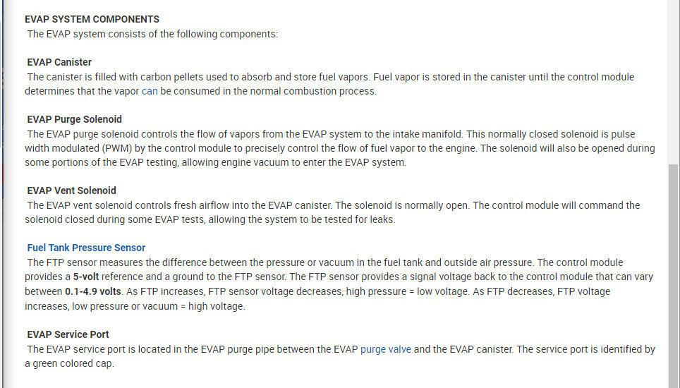

Did you remove the oil fill cap to find out if the smoke was leaking out of the crank case? Also, we need to remove the air intake tube to see if it is coming out of the intake. Basically, I suspect you have a leaking purge valve.
I understand that the shop told you all the valves are operating but this is commonly missed.
However, if this was not and the system truly has no leaks then the likely cause is the fuel tank pressure sensor is faulty.

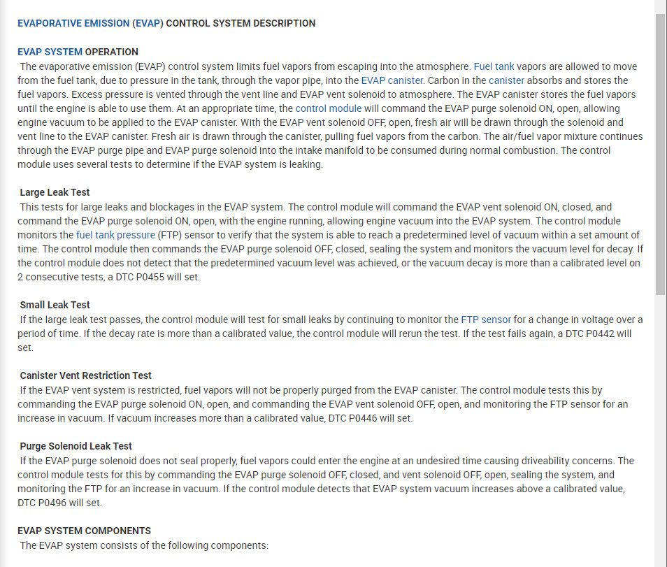

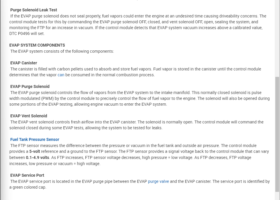

Basically, we need to monitor the voltage and find out what it is doing in order to know for sure.
I am attaching all the info below on this system and sensor.
Please run through this and let me know what questions you have. Thanks

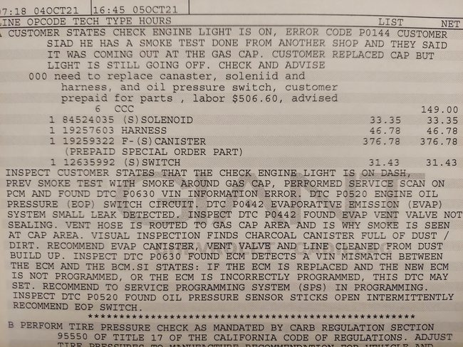

Thank you for responding. I have an appointment with a Chevrolet dealership to have the system completely checked. I will let you know what they say.
Sep 26, 2021 at 10:07 PM
Sounds great. Yes please let us know because I am curious about this one. Thanks for the update.

To give you an update. the dealership said it's the canister, that it has dust in it and said the oil pressure switch and harness needs to be replaced.
Oct 8, 2021 at 1:40 AM
Okay. Thanks for the update. The oil pressure switch and harness sound like a different issue.
However, the canister sounds like it has fuel in it, or the vent is leaking. If there is fuel in it then we need to check the purge as well as that could be sticking, or it is going to stick. Fuel breaks down the charcoal and causes it to get the purge to stick.

Latest update. The dealership told me that the charcoal canister and purge valve solenoid needed to be replaced. So, after spending over a $1,000.00 and only driving 113 miles the check engine light came back on with the same code. I'm very upset after spending this amount of money. after all being a dealership, they should know what they are doing. so, I have two questions. isn't the charcoal canister a completely sealed part? And second what would be your next step in finding out what the problem could be?
Oct 22, 2021 at 9:57 PM

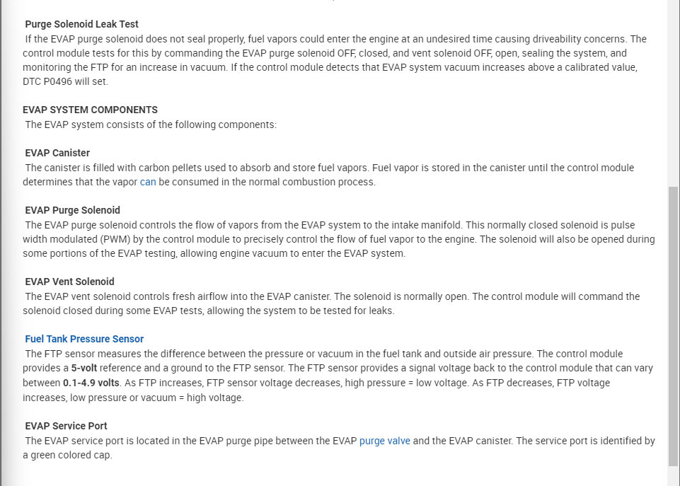

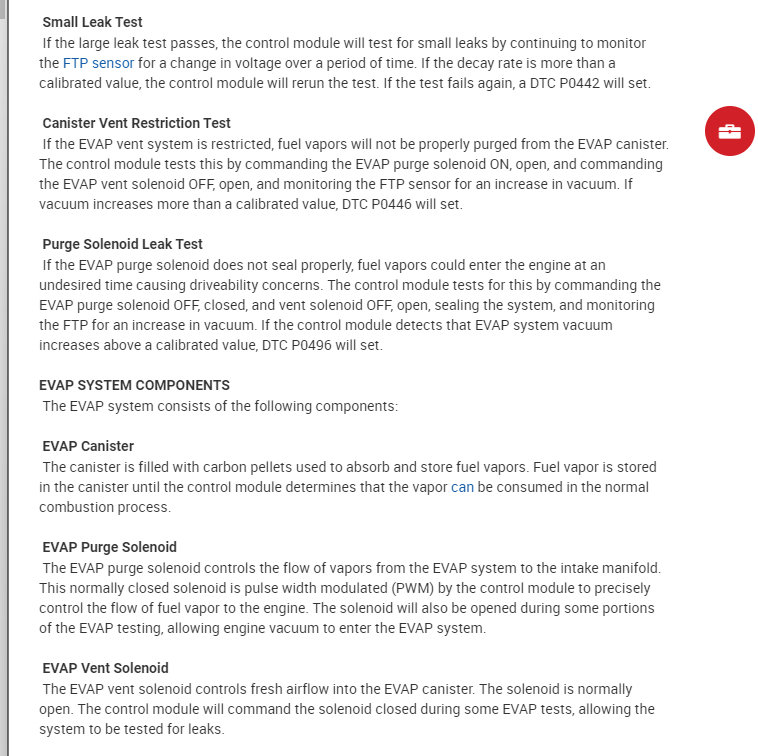

To start if you paid for this specific issue to be fixed, I would take it right back to them and tell them they did not repair it. If they try to tell you this is a different problem but the same code due to it going over 100 miles, then that is not true. This evap code, after cleared requires to fail the test a number of times before it turns the light back on. This test requires certain drive cycles and engine off time for it to meet the parameters to run the test. This can take over a hundred miles to happen, so they clearly did not fix it.
The canister is completely sealed from allowing vapor to the atmosphere but when the purge valve opens, it allows this vapor into the engine so that it can burn it and reduce emissions.
Please review the documents I attached prior for more info on this.

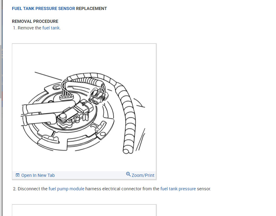

These evap issues are hard to find but I am attaching below the tests for each part of this system.
The only way to find this is to run through all these tests.

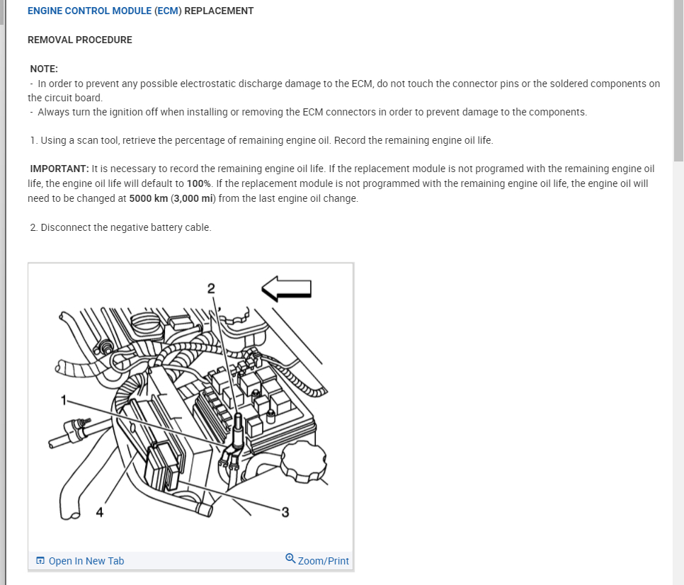

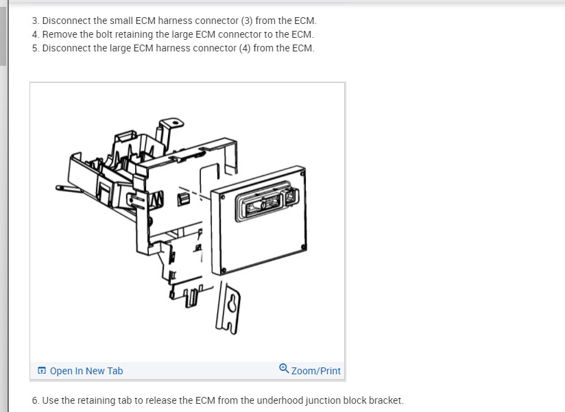

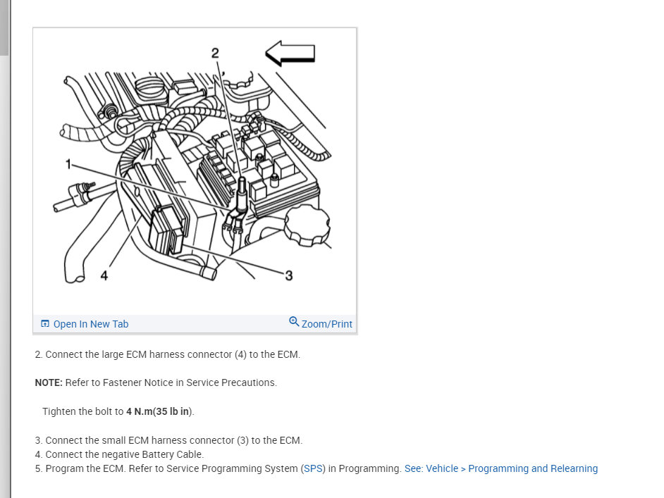

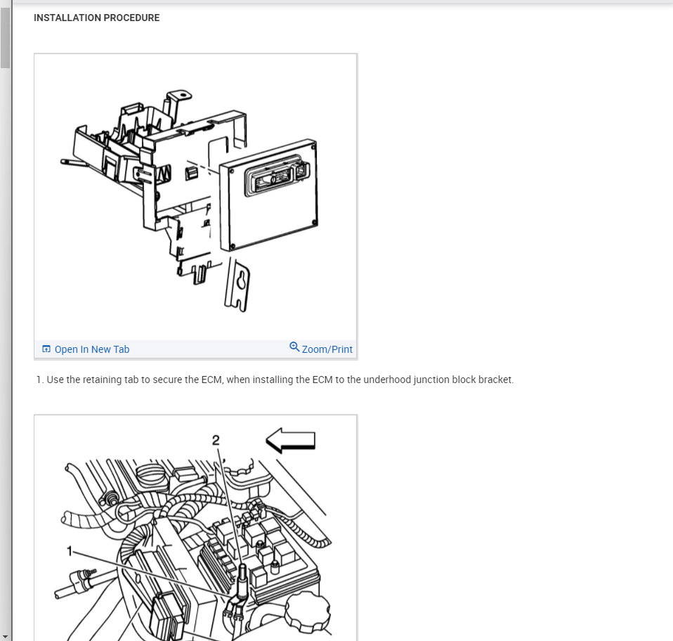

It keeps mentioning the control module. Which one is it talking about?
Oct 23, 2021 at 4:52 AM
This is talking about the engine control module (ECM). It is possible that this is the issue, but it is the least likely cause.
Just from experience and knowing that these are difficult issues to fix, I suspect they missed something and did not find the fault.

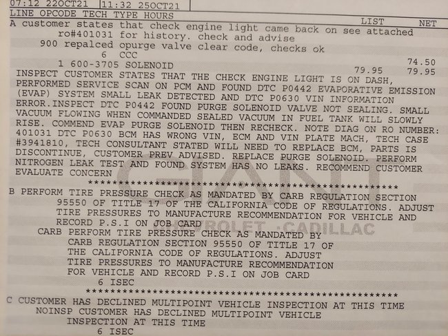

Just to give you an update. The dealership this time said it was the purge valve, after making sure that the new parts were working that the tech noticed that there was pressure building so, they replaced the purge valve. So, I will let you know if that fixes the problem.
Oct 25, 2021 at 6:46 AM

Another update: The dealership replaced the purge valve and this time at 72 miles the light came back on. I am so frustrated with all this. they have replaced the charcoal canister, the purge valve solenoid, and the purge valve. What else is there to replace or look for? I asked if there was a fuse that could be causing the light to keep coming back on and they said no. so far, I have spent over $1,400.00. Any more ideas?
Oct 27, 2021 at 12:27 AM
It sounds like they are guessing at it and just clearing the code. As I said before this will take about 100 miles to run through the system test to determine if it fails.
If it were me, I would be calling the manager and tell them what is happening.

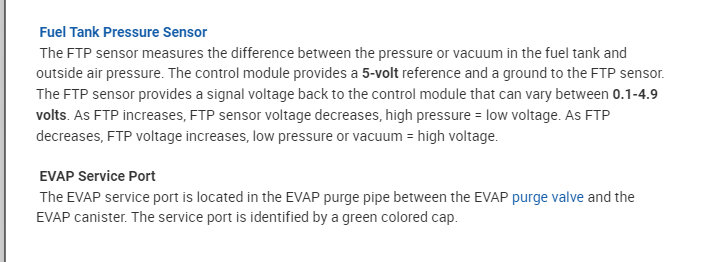

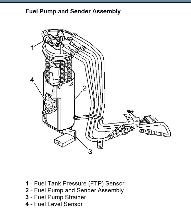

These are difficult issues to find but they need to find what the fuel tank pressure sensor is doing.
Basically, the way this small leak test works is on every time the engine runs and then shuts off, it checks for a large leak. If the large leak passes, then it continues to check the fuel tank pressure over time while the engine is off.
If there are no leaks, then the ECM expects to see a certain pressure in the fuel tank after a certain amount of time. If this pressure is lower than it expects to see, then the ECM assumes there is a leak in the system.
This means, the purge or vent solenoid could be leaking. The fuel pressure sensor is not accurate. Or the ECM could the issue.
Unfortunately, they only way to know this is to test the system as I am attaching below.
What I suspect is happening is the mechanic that is working on it, doesn't fully understand the system and how it works. Clearly this is based off only what is in this post but from my experience with mechanics, this is a complicated system to understand but once you do, it is pretty simple.
If they already replaced the canister, purge solenoid and the solenoid again, then they have to test the other components as shown below.

If this turns out to be a fuel tank pressure sensor then you paid thousands for a $50.00 part.
The fact that they are recommending a tank and fuel pump (that most likely comes with the pressure sensor) just is further proof they have no clue. See the picture below.
This code is telling you that over a certain period of time with the engine off, the fuel tank pressure is not correct. Normally it is too low which means there is a leak or the PCM thinks there is a leak. The system could be fine and just have a faulty sensor giving the incorrect reading.
Based on all this, if they are going to guess, why have they not guessed with the cheapest of all the parts in this system which is the fuel tank pressure sensor?
To answer your question, in theory if something can hold pressure then it can hold a vacuum. However, this system is not meant to be pulled into a vacuum. I have actually seen fuel tanks get collapsed in on themselves when the vents are clogged, and the pump pulls fuel out and it doesn't all air in to equalize the pressure when the engine is running.

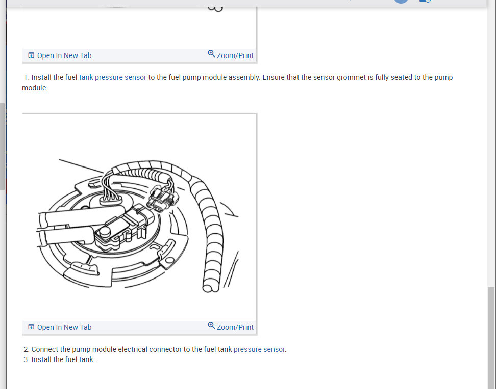

They need to monitor the pressure in the fuel tank and then monitor the fuel pressure tank sensor using a scan tool. These two should be reading the same thing.
If they replaced the pump, then they need to confirm it came with a fuel tank pressure sensor as it is mounted on the top.
However, I don't think they are going to fix this thing, at least I don't have high confidence that they will.

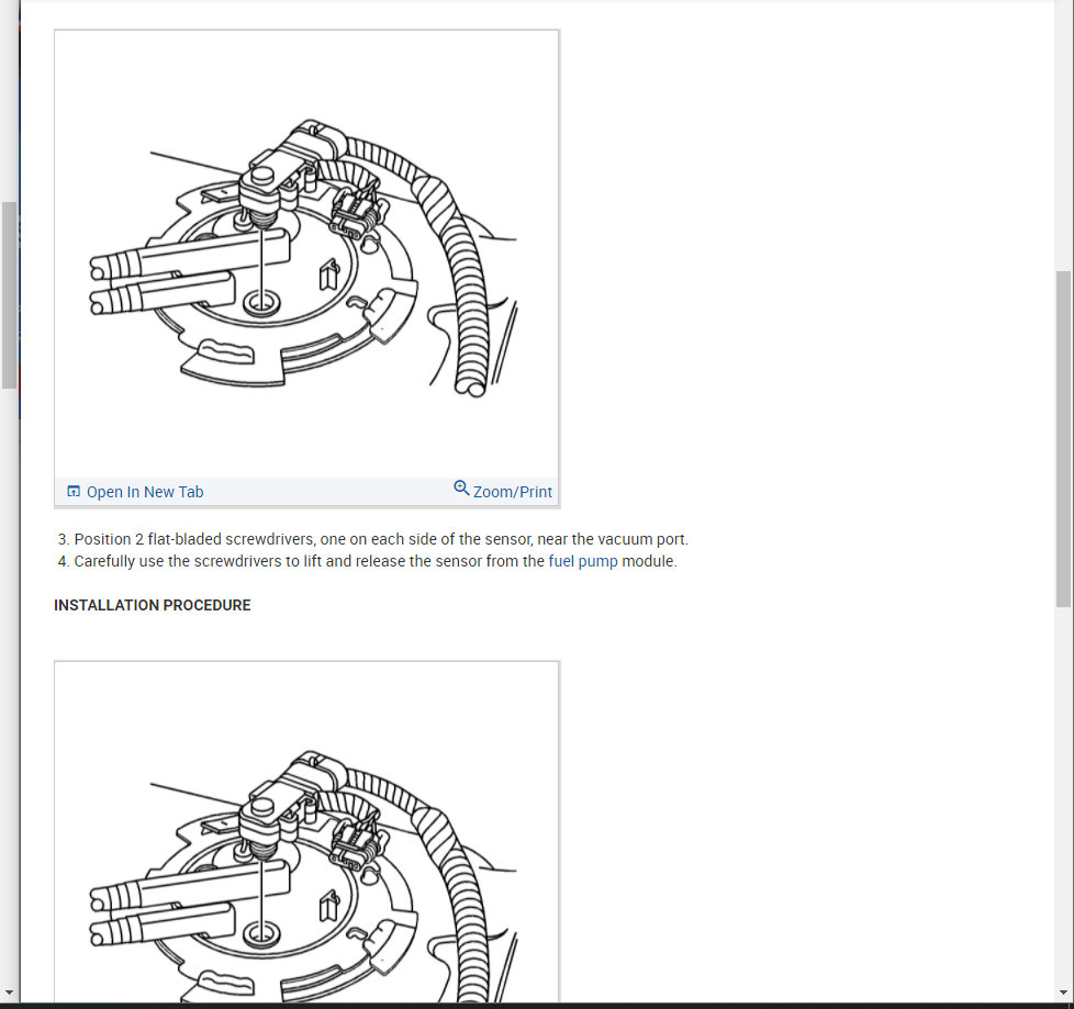

If there is an issue with the fuel tank pressure sensor, then that will not show up with a smoke test because it is not leaking externally.
If there is a "programming" issue, then that would be found using a scan tool as I suggested above.

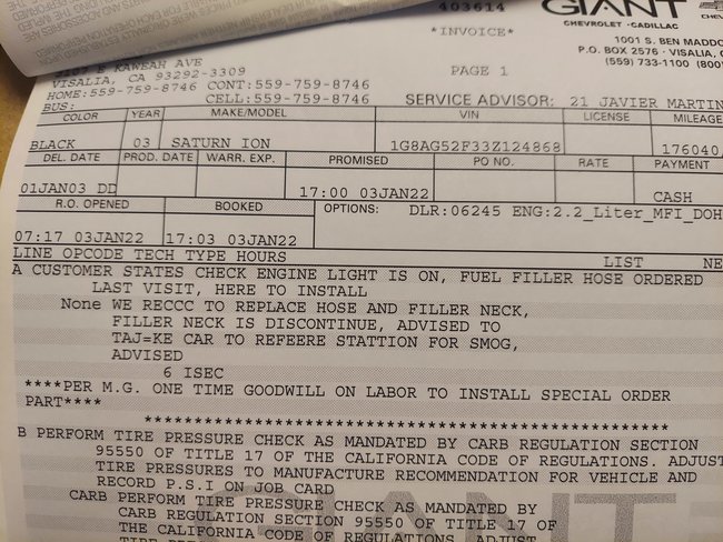

I am sending attachments of the tech's notes. Each one is in order of the work done. This is number 1.
Jan 4, 2022 at 9:14 AM
BLAIN BABB
  • 20 POSTS
This is number 2.
Jan 4, 2022 at 9:15 AM

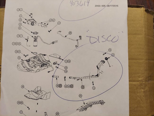

This is the diagram they gave me and telling this is what is needed. The long hose part they have but the fuel filler tube has been discontinued and if I get a replacement that isn't gm factory, they can't install it. They first said they would install the part they do have but later on they called me and said they weren't. And that there nothing else they can do.
Jan 4, 2022 at 9:21 AM

They told me to call the smog referee and explain what the dealership said. I have called the smog ref and was told that my car had to fail smog. spend $650.00 to try and fix it...and if it failed smog a second time that they could give me a waiver on the smog. And that all the money I have already spent does not count.
Jan 4, 2022 at 9:24 AM
