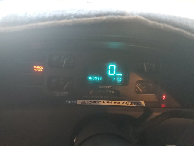

Hi Danny. yes I was able to find a cheap GM reader and it did nothing and I used the paper clip jump wire method and still no flashing light of any kind... when I put the reader in the port or the jumper wire and turn on the key the Safety seat belt is on and the check gauge light is on and that's it.. no flashing of any kind.. let me add a while back the temperature gauge quit working so I replaced the sending unit but it did not fix the problem so I just keep a close eye on my coolant... I have included a pic of the Vin # to my car.. is there any kind of sensor that will allow the car to start when the weather is warmer and not start when the weather is much cooler..

Danny.. I also forgot to mention that when I plugged in the GM reader and or the paperclip the only thing that happened was my electric fans came on...

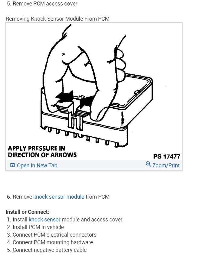

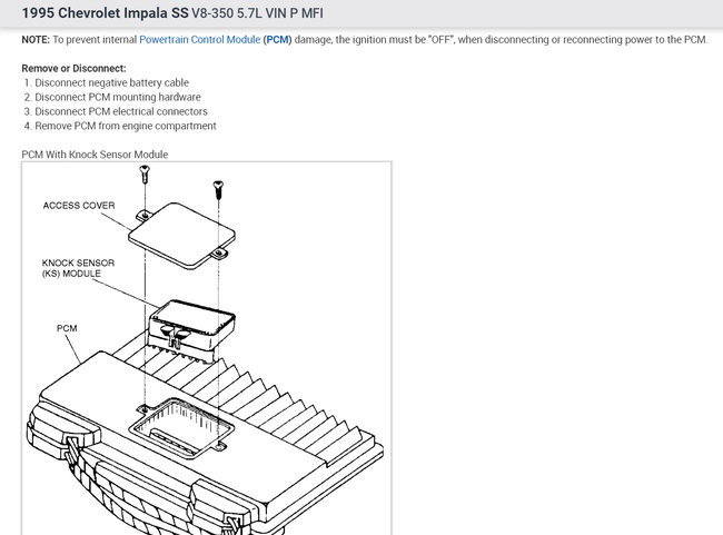

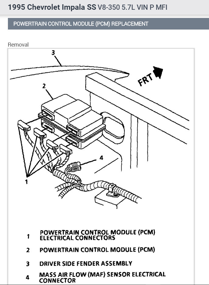

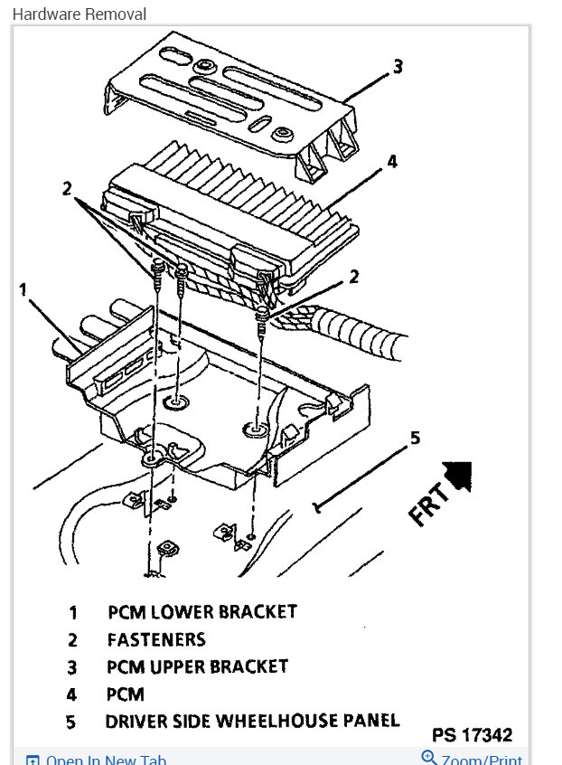

If the grounds and power feeds are good. I have seen this problem before and had to replace the PCM. here is the location try to find a used/rebuilt unit. Check out the diagrams (below). Please let us know what happens.
