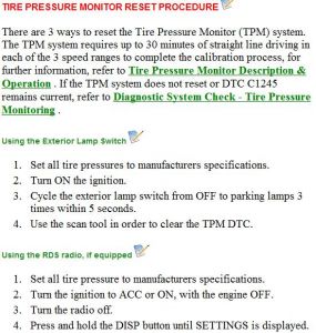

I just had a flat tire and it was repaired but they didn't know how to reset the sensor. I know it is through the radio but can't remember what to do.
Sunday, March 22nd, 2009 AT 1:49 PM
2 Replies
  • 109,885 POSTS
There are three ways it can be done. Here is the list with directions.
https://www.2carpros.com/forum/automotive_pictures/249084_light_1.jpg
Let me know if this helps.

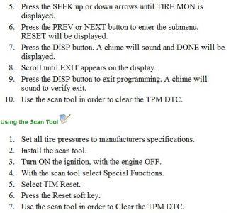

Sorry, it only downloaded part of the process. Here is the part that is missing.
https://www.2carpros.com/forum/automotive_pictures/249084_light_222_1.jpg
Sorry about that. Let me know if this helps.
