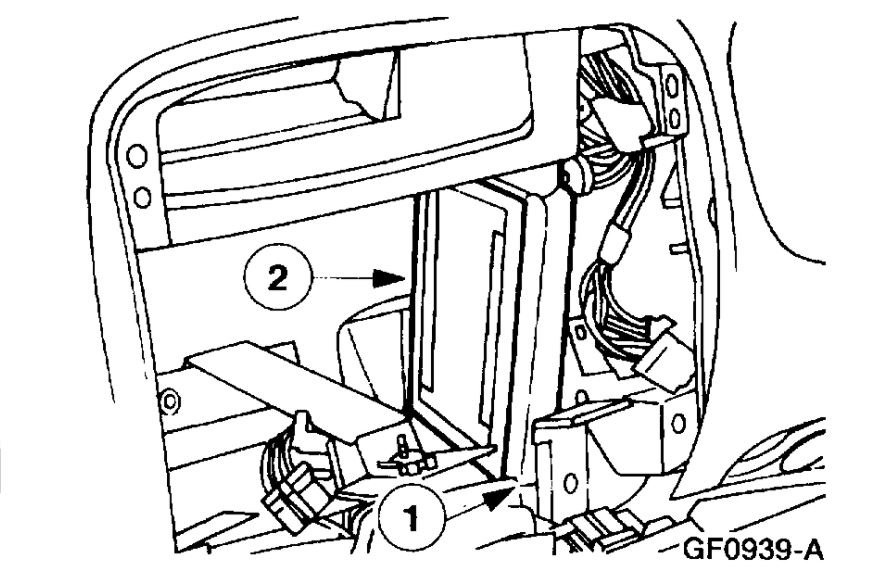

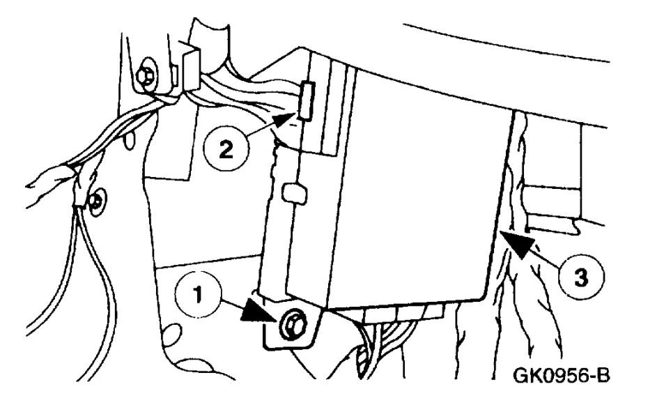

Both Gem and air suspension modules are located behind the radio in the dashboard. Pictures attached.
Yes, you need the Gem module.

Which is which in the drawings? I see the location of the module in the second drawing in relation to the radio opening, where is the module shown in the first drawing in relation to the radio opening?
Which is the GEM and which is the air suspension modules?

First one on the left is GEM, the other is the air suspension.
Both are behind the radio and close to each other.

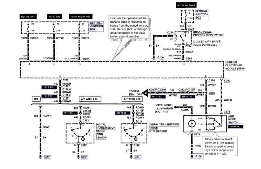

What does the GEM module control that the chassis needs?

GEM module controls the 4 wheel drive. The actuator and the switch. It is definitely needed for your project.

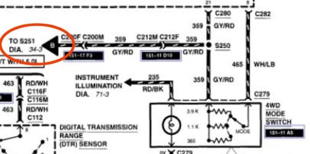

Thank you - I saved that image so I will know how the wiring to the GEM needs to be reconnected, and it looks like I will need to take the BPP too ... and what is the DTR (where is it located and what does it look like)?
Also, what/where does arrow B (S251) go to?
- I can connect up a 'Hot in Start', 'Hot In Run', and a 'Hot In ACC Or Run' as shown at the top left of the drawing, so no issues there.
- I can connect up a 'Hot At All Times' as shown at the top right of the drawing, so no issues there.
- I have the 4WD Mode Switch that I can connect back in, so no issues there other than what is that 'B' arrow showing to S251?
- Mine is A/T with 4.0L, so I can connect up the DTR ... if I knew what it was and where it was located ... so that is an issue I need to solve.
- And if I do the above ... then I don't need to try to remove the wiring harness which goes to the GEM, correct?

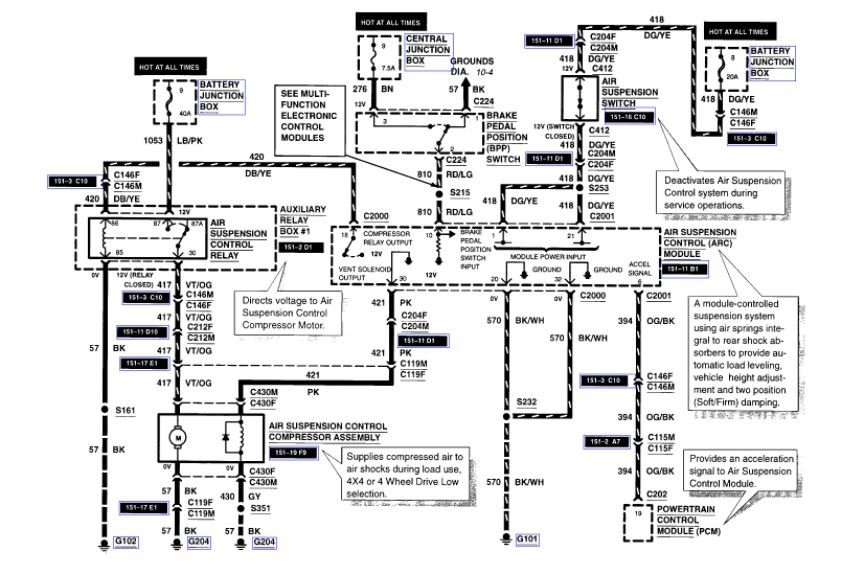

Do you have a similar drawing for the air suspension module showing what needs to be connected where? I may be able to save removing the wiring harness if I know what connects to what and I can create the wiring shown in the drawings - that would be great if you have that.
Thank you - this went from simply removing the modules to much more complex in trying to get the wiring harness, to maybe not needing the wiring harness if I can make my own to connect what needs to be connected (if I removed the wiring harness, I would remove all unnecessary-for-my-use wiring anyway).

DTR is on the side of the trans. it is the range sensor.
I still think you need the harness for it to work.
I will get the diagram for the air suspension
Jan 13, 2018 at 10:17 PM
diagram

The DTR is likely in the wiring harness which goes from the transmission toward the engine, possibly to the PCM or around about to the connection to the fuse box and to the firewall connections (one of the two large wiring harness connections at the firewall which are then run inside the body to wherever/whatever the various wiring runs to.
Do you know where this goes in the drawing:
TO S251
DIA. 34-3
I suspect that is referencing location 'S251' on 'Diagram 34-3'?
Jan 13, 2018 at 11:09 PM
there is no indication or wiring routing in my system.it is part of the main engine harness as well as the interior harness as well.

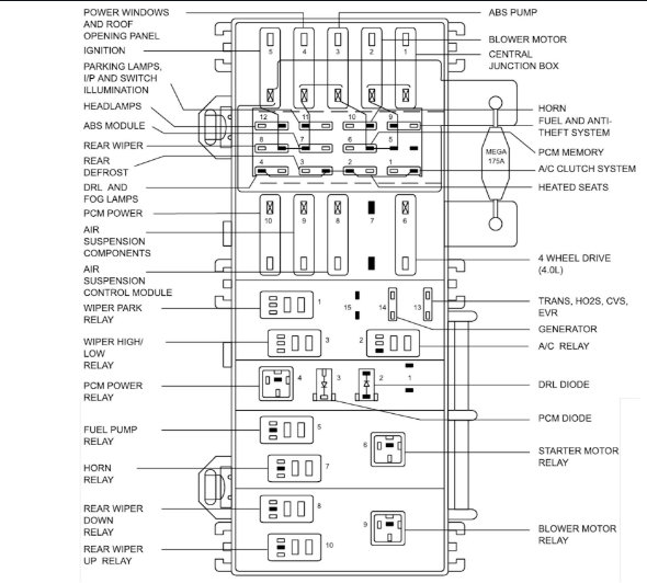

The above work getting the wiring harness has lead to another question: I traced 4 (maybe 5) of the wires in one of the harnesses which came up from the chassis through the floor under the driver's seat, over to the harness which runs along the driver's side from front to rear, and all the wires in those harnesses went towards the front ... except for those 4 or 5 wires ... which went to the back to what I can best describe as a 'relay block' (versus a 'fuse block').
Question 1: Being as those wires came from the transfer case/fuel pump/sending unit/air suspension (I don't know which yet - but the connections on the chassis lead to those items) ... do I need to take that relay block, and, if so, what would it be for?
- The relay block was next to the module which has the keyless entry code on it, and is basically in the jack compartment where the air suspension on/off switch is located.
Question 2: I followed the green with yellow tracer wires from the air suspension on/off switch and they go up to the rear seat, cross over to the passenger side, then go up to the 'A' pillar wiring, and up to the air suspension module. That indicates that I can just connect those two wires to the air suspension on/off switch and locate that on/off switch any place which is convenient for me to use to turn the air suspension off when I go to service/jack up the vehicle, correct?
Jan 16, 2018 at 8:54 AM
Ok.
Question 2 is correct.
Question 1. take the relay block doe your project
Jan 16, 2018 at 6:19 PM
JERRY PECK
  • 15 POSTS
That shows the horn relay, the horn relay is in the power fuse box / relay box in the engine compartment - I already have the complete wiring harness and associated stuff connections and things.

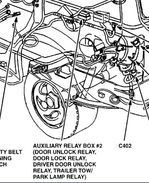

The relay box in question is mounted back by the jack - does it also have a horn relay (and PCM, starter, fuel pump, etc) relays?
Thank you
Jan 16, 2018 at 9:07 PM
Let me see if I can find it
Jan 16, 2018 at 9:09 PM
picture attached
Jan 16, 2018 at 9:11 PM
JERRY PECK
  • 15 POSTS
Looks like those wires may be trailer tow, which I don't need.
That's the only relays I see in there which would likely go to the chassis.
Do you see any others?
Jan 16, 2018 at 9:28 PM
nope, no other relay boxes anywhere.

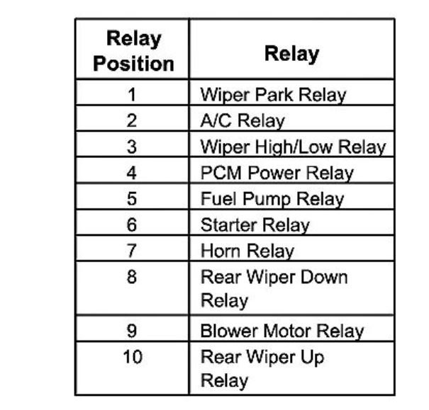

I was laying the engine compartment and dash area wiring harnesses out and found two more relay boxes: one which mounts to the support for the air cleaner; and one which was in the dash between/near the two modules I needed.
The wiring harness in the engine compartment, the end which goes to the right side by the air cleaner and where the blower was, the only connections I think I would need would be for the right front brake (anti-lock system?) and the cruise control unit (which I will be removing and will not need) - do you have a layout of the relays in the relay box which mounts to the air cleaner support mount, and do you have a diagram schematic for showing what goes to what for the engine compartment wiring harness?
Do you have a relay box drawing which shows what the relays are for in the relay box in the dash wiring harness, and what the connections go to for the dash wiring harness?
I am trying to eliminate what I do not need, and make sure that I do not eliminate what I do need (I am slowly laying out the wiring harnesses and trying to figure out the connections as to what goes to what and eliminate the ones I don't need).

found one under the hood
Jan 19, 2018 at 10:52 AM
JERRY PECK
  • 15 POSTS
That's the power fuse box / relay box at the left fender near the master cylinder. The one I'm inquiring about is on the right side and mounted below / on the air cleaner support plate.
