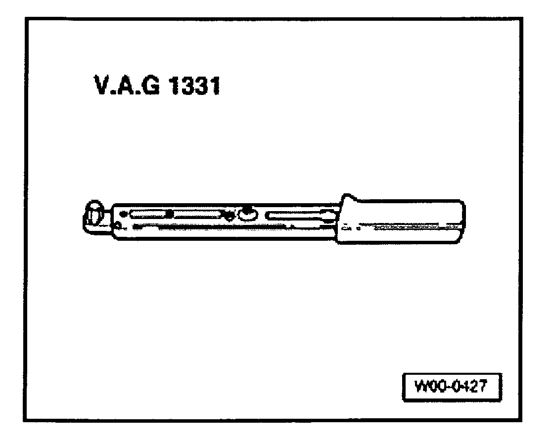

Special tools, testers and auxiliary items needed
pic 1
- VAG 1331 Torque wrench (or equivalent 5 - 50 Nm)

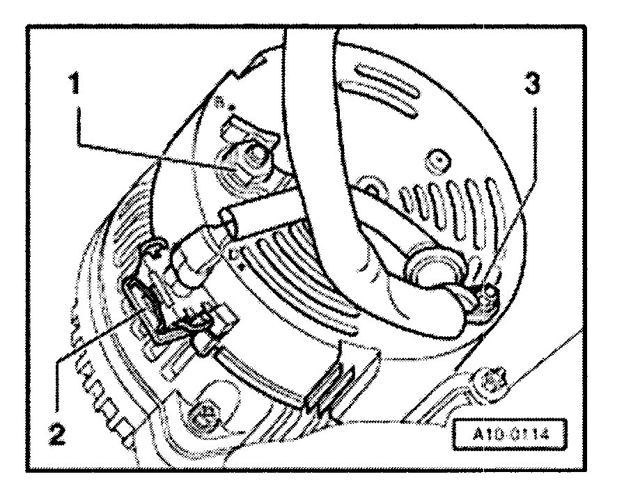

pic 2
4. Remove nut from terminal 30/B+ connection
Tightening torque .................... 15 Nm ± 1 Nm
5. Disconnect electrical connector -2-.
6. Remove harness retainer -3-.

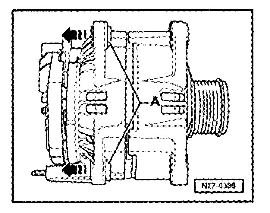

pic 3
- Where applicable, drive threaded sleeves -A- approx. 4 mm in direction of -arrow.

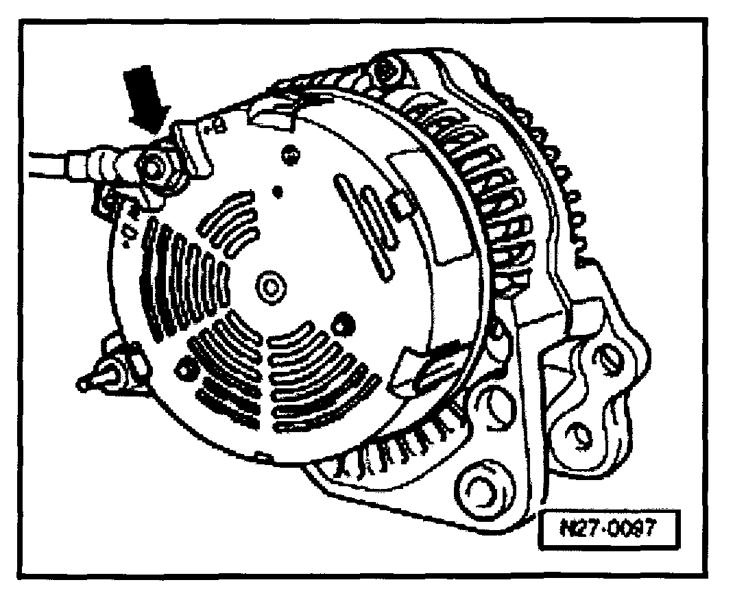

I have been doing more research on your vehicle and came across this. It indicates the importance of the torque of the wire you are having trouble with.
Take a look through this and the attached pic.
___________________
2002 Volkswagen New Beetle GL (1C1) L4-2.0L (AVH)
Mechanical (including Torque)
Vehicle Starting and Charging Charging System Alternator Specifications Mechanical (including Torque)
MECHANICAL (INCLUDING TORQUE)
Generator, B+ connection
pic 1
Securing B+ wire to generator
CAUTION!
If the B+ wire terminal nut is not torqued as specified, the following may result:
- Battery will not be completely charged
- Vehicle electrical system malfunctions
- Danger of sparking
- Damage to electronic components and control modules due to voltage spikes
The tightening torque for the B+ wire (arrow) securing nut is 15 Nm (11 ft lb).
Let me know if this helps.

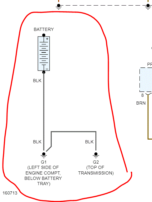

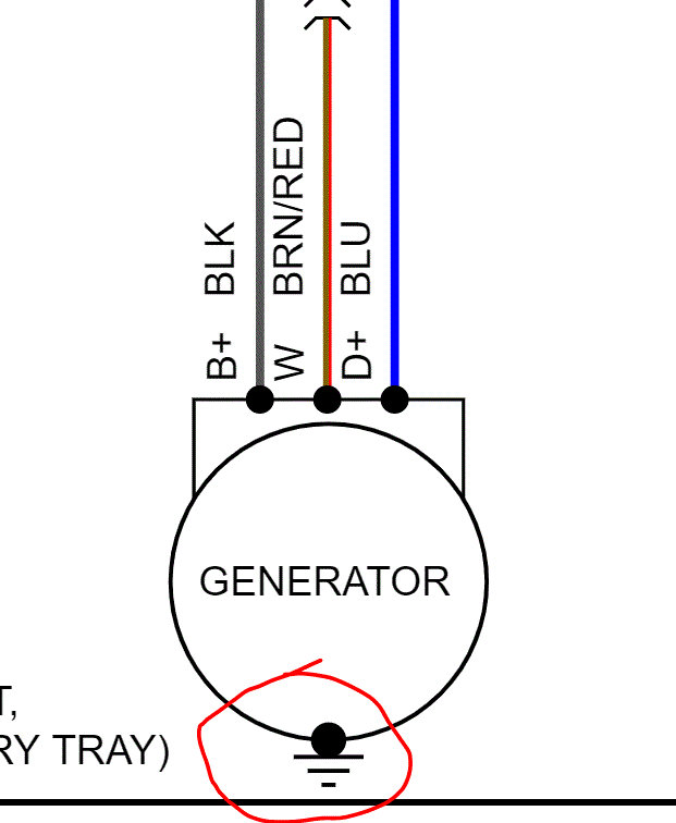

Do you know where all the ground straps are? I was told it could be a shorted out ground.
Feb 25, 2020 at 7:57 PM
  • 110,244 POSTS
See pic 1 for the two primary from the battery. Pic 2 shows that the alternator is grounded through its mount to the engine.
Let me know if this is what you needed.
