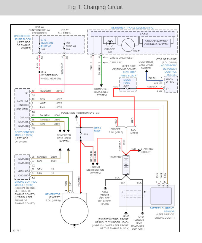

All the lights (headlights, dash, dome, tail, etc.) on my SUV have been dimming a lot lately and I am not sure why. The charging system light comes on from time to time but it does not stay on. Just recently replaced the belt, tension-er, and idler pulley but it continues. Removed and cleaned the ground connections, cleaned the battery terminals, and removed the alternator and cleaned its connectors and the problem persists?

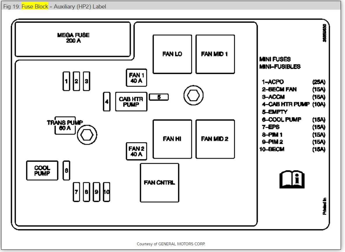

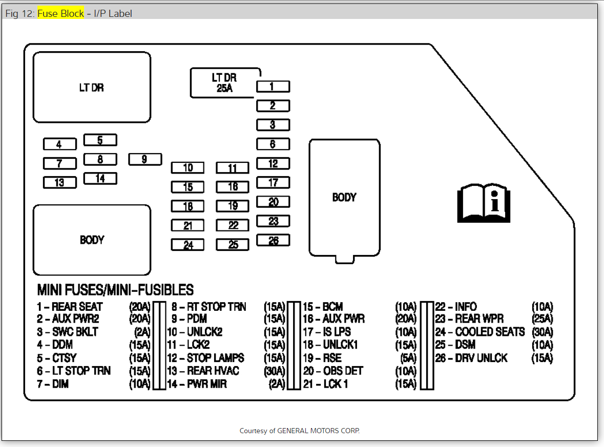

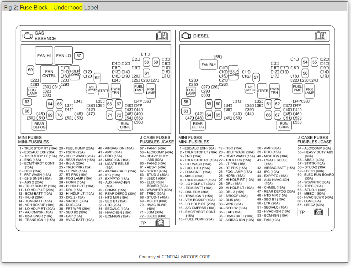

The alternator is controlled by the PCM and BCM but we should check the fuses (IGN #48 and IPC # 46) and test the alternator first. These guides will help us get started and I have giving you the fuse locations as well as the alternator wiring diagrams so you can see how the charging system works. It could be the alternator has gone out but to be sure lets run down this guide to help you find the problem. Also I have included the wiring diagrams so you can see how the system works.

This guide can walk you through the steps of th alternator replacement with diagrams below to show you how on your car:
