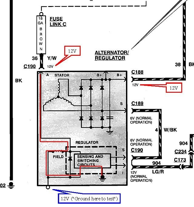

Replaced alternator,checked wiring have 12 volts to main on alternator and 12 volts to yellow/white on a-terminal and nothing to green/red wire to I terminal on alternator. traced this wire to instrument cluster and have continuity from plug on cluster to i terminal on alternator. checked bulb on cluster and is good. am I supposed to have voltage on this wire? Is it possible the ristorante on back of cluster is bad.
Oct 22, 2019 at 9:12 AM
CARADIODOC
  • 34,367 POSTS
I can't find any reference to a 7.9L engine, so I went with a 7.5L. If you have a diesel engine, I'll need to look for a different diagram.

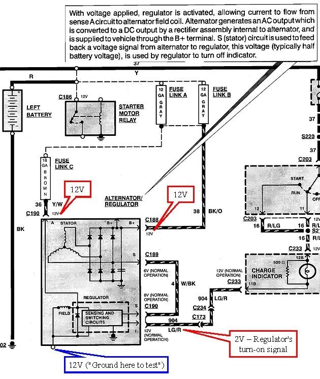

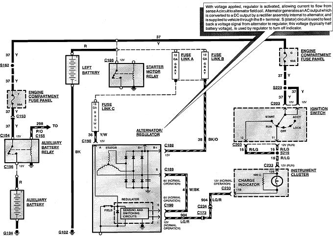

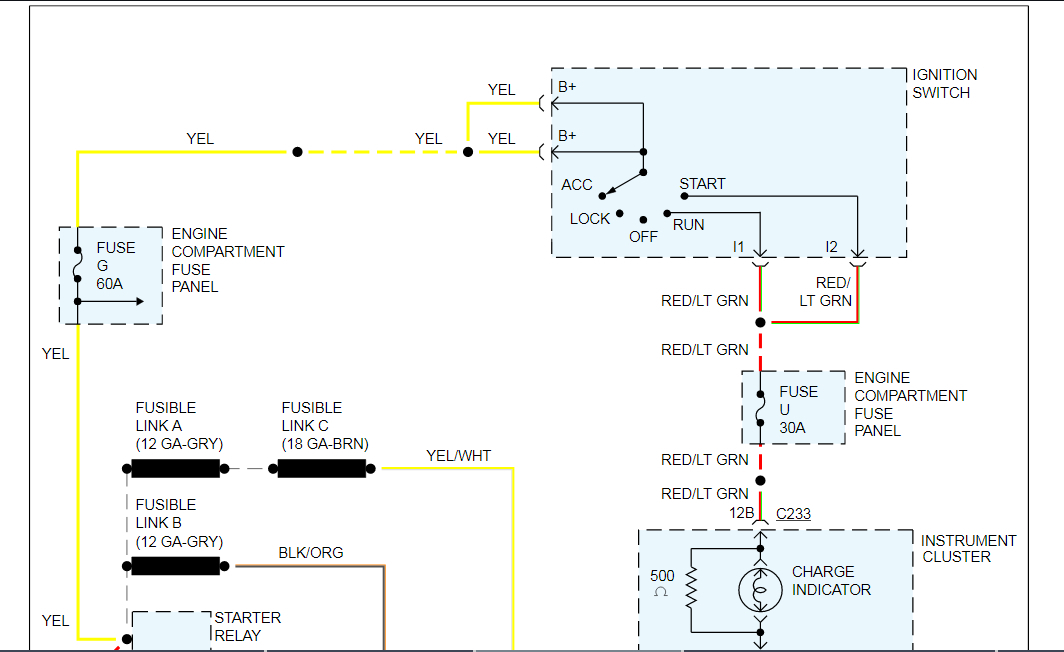

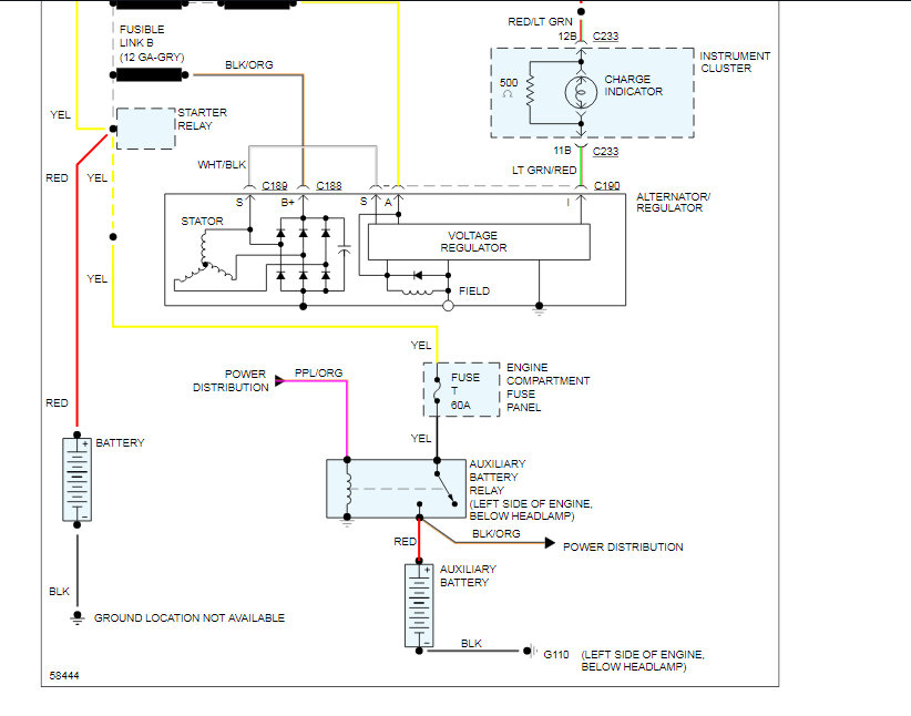

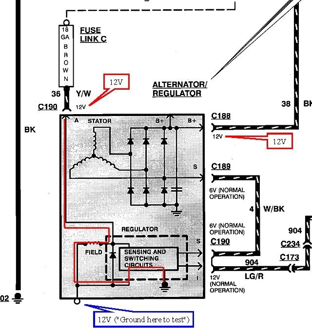

The first diagram shows the entire charging system. The next two are just the same thing, but enlarged. The first step is to check for full battery voltage on the large output wire and the yellow field terminal. Those should be there all the time, as you found.

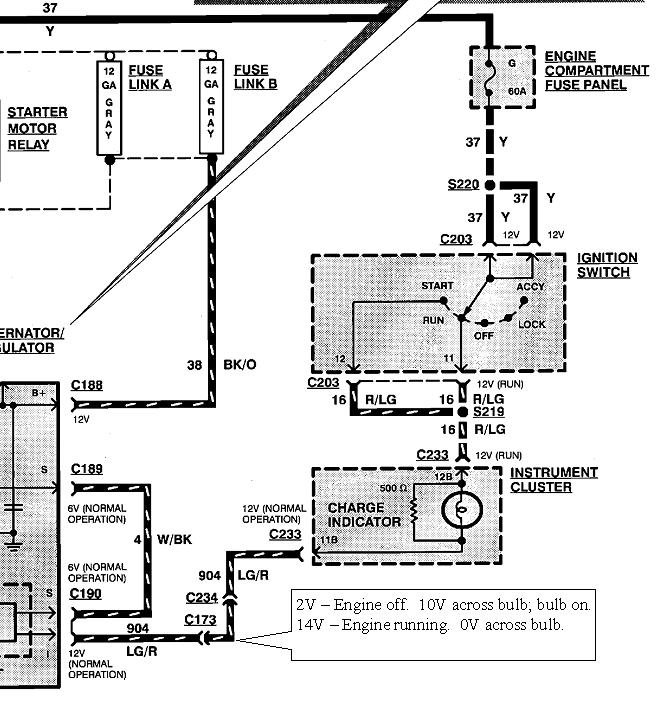

The secret to this system is the light green / red wire where you found 0 volts. With the ignition switch in the "run" position, current flows through the dash warning bulb, through that wire, then to the voltage regulator inside the generator. Roughly 10 volts is dropped across the bulb, so it turns on. That leaves about 2 volts on the light green / red wire, which you're missing. That is the regulator's turn-on signal, then it starts allowing current to flow through the yellow / white wire, then through the path shown in the fourth diagram. As it flows through the field winding, an electromagnetic field is set up around it.
You need three things to generate a current mechanically, that is a piece of wire, (a coil is more efficient; that's the stator windings), a magnet, in this case the field winding, and most importantly, movement between the two. That's why we have to spin the field winding with a belt.
At its maximum, which is rarely reached, the field circuit will draw 3 amps. Think of the regulator as a variable resistor that limits current flow through the field winding. The regulator senses system voltage on the yellow / white wire, then it causes the regulator to be as high a resistance as necessary to weaken the magnetic field, thereby reducing output voltage and current to the desired values.
Once the engine is running and the generator has started producing output current, a sample is fed back to the regulator on the short white / black wire. Now it knows the system is working, so it switches full charging voltage, 13.75 to 14.75 volts, onto the light green / red wire. With full voltage on that wire, and the same voltage on the other side of the warning light bulb through the ignition switch, the net difference is 0 volts, so the warning light turns off.
The best clue comes from watching that warning light. If it doesn't turn on when you turn the ignition switch to "run", there is a break in that light green / red circuit. It could be the bulb is burned out, but the resistor you asked about provides an alternate path for that start-up signal. Those resistors are typically a lot higher in resistance compared to that of the bulb, but sufficient current can still get through to tell the regulator to turn on. In this case the only symptom would be the warning light never turns on. You can verify the rest of the charging system is working by just measuring the battery voltage. With the engine running, you must find between 13.75 and 14.75 volts.
Another more time-consuming way to see if the charging system is working is to measure the voltage on the white / black wire the regulator uses for that purpose. With the engine running and the charging system operating properly, you'll find very close to half of battery voltage on the white / black wire, or around 7 volts.
My suspicion is there is a break in the light green / red wire. The only other possibility is a break in the red / light green wire between the ignition switch and the bulb. That would be very unusual. That circuit feeds other things, so you'd have more symptoms than a dead charging system. A better suspect would be a crack on the copper trace on the back of the instrument cluster.
A continuity test on the light green / red wire is not a good test for this type of problem. All you need is one tiny strand of wire remaining intact to get a good reading, but that won't allow enough current to flow. That 2 volts we expect to see at the regulator will be dropped across the bad spot in that wire. leaving you with essentially 0 volts on the turn-on circuit. Voltage readings are much more valuable.

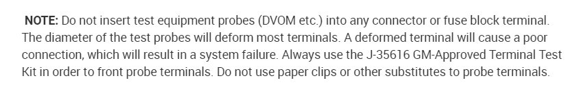

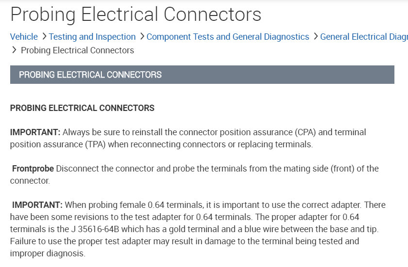

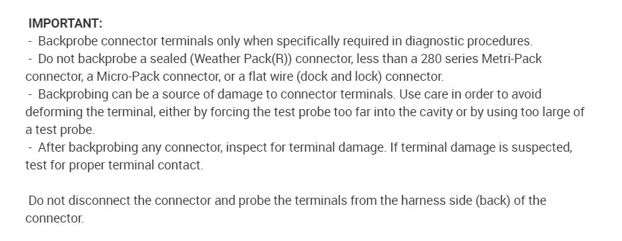

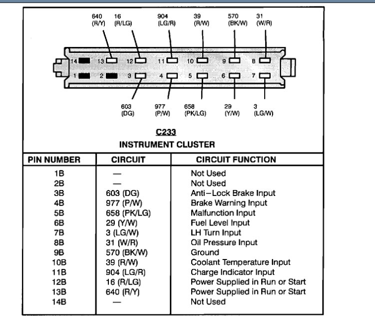

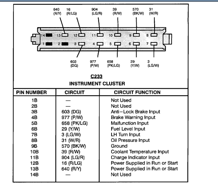

If you have battery voltage at the instrument cluster connector C233 Pin 11B then you should have battery voltage at Pin 12B as well. If not then the instrument panel is bead and need to be replaced. In the diagrams down below I have included a wiring diagram of the charging system on your vehicle as well as a diagram of Connect C233 as well as a callout for it also. I have also included a guide explaining the proper way to check for voltage at electrical connectors as well. Please get back to us with what you are able to find out and we will go from there.

Just want to say thank you very much. great information from both replies.So with that being said,I took instrument cluster completely out and checked what you suggested. I put back together and charging I got 14.5v on battery.I did call around junk yards for cluster and found one out of state for $45.00. I think I’ll get and install. what are your thoughts?

We kind of jumped ahead by not actually diagnosing this yet. The first thing to do is to unplug the three-wire connector at the generator, turn the ignition switch to "run", then check for 12 volts on the light green / red wire. You found 0 volts on there originally, but I'm betting that was with the plug connected. If you find 12 volts now, use a paper clip and / or jumper wire and ground that wire. Doing so should make the "Battery" light turn on. If it does, that entire circuit is okay, and the suspects are that terminal is stretched in the plug so it's not making contact with the mating terminal in the regulator's plug, or the regulator is defective. There are other tests we can do on the regulator and internal brushes, but that would be the plan of attack if you had found 2 volts on the light green / red wire. We'll know more once you check for voltage with plug disconnected.
If the "Battery" light doesn't turn on when you ground the light green / red wire, see if you can figure out which is the red / light green wire feeding that bulb from the ignition switch, then check that one for 12 volts. If it's missing there, a good suspect would be the connector at the base of the steering column. Those terminals often get hot and degraded. There's only a small fraction of an amp flowing through the light bulb. That by itself isn't enough to overheat a terminal, but that circuit coming from the ignition switch is feeding other things that could be drawing high current.
It only takes one tiny strand of wire, or a carbon track around a burned pair of mating terminals to pass enough current for a digital voltmeter to detect 12 volts, but you won't get enough current to turn on the voltage regulator. This often makes digital voltmeters give false readings. If you use a test light instead, they work by using current from the circuit under test, so they will be more accurate for this type of problem. If you can't get enough current to turn on the regulator, the test light won't light up either. The disadvantage of the test light is it doesn't show the exact voltage, but that's not important here. We just need to know if we have something or nothing.
