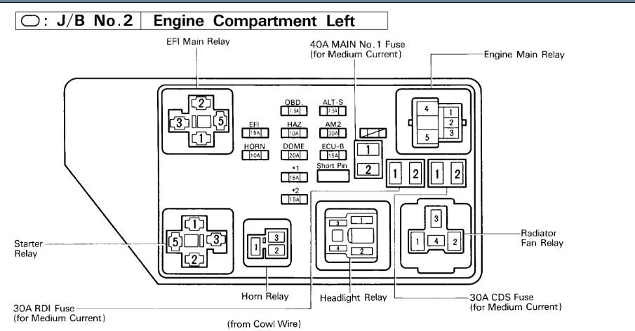

Replaced battery and alternator and car won’t keep a charge longer than a couple of days. please help

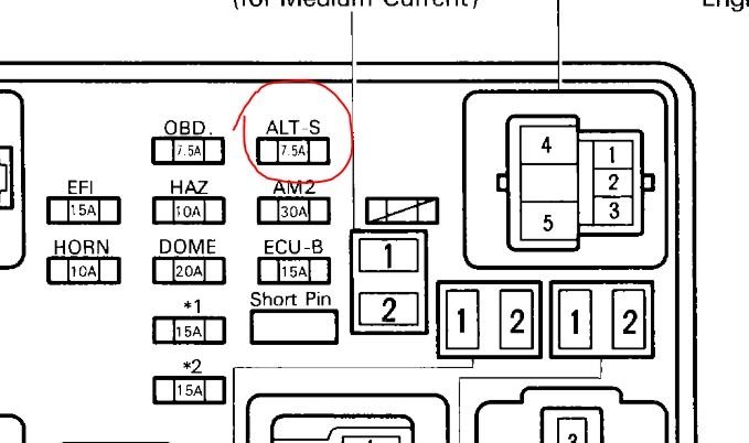

Next, confirm the alt s fuse is good in the under hood fuse box. See pictures 1 and 2. Picture 1 shows the entire fuse box and in picture 2 I circled the fuse. Here are a few links you may find helpful:

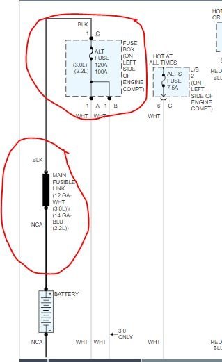

I also need you to test for power for the main alternator fuse in the same box. If you look at picture 3, it shows power goes through a fusible link. It looks like a wire, but it functions as a fuse. Check that fuse as well as you need to confirm that link hasn't failed. You should have power at the fuse if the link is good.
Either we have something drawing power all the time or the alternator isn't able to do its job. There are specific wires called fusible links that can fail and not allow the alt to charge the battery, so let me know the results of the above tests and I will direct you as to what needs done next.
