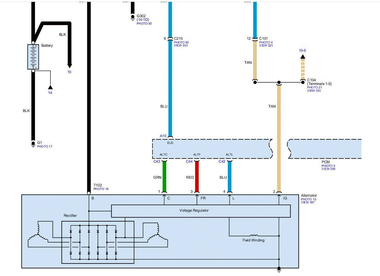

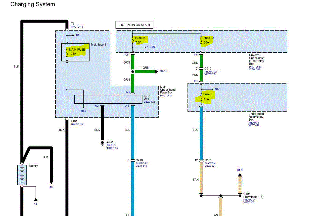

Is the present battery producing any voltage? Also, with the engine running, you should see around 14v at the battery, so 11 is certainly an issue. I'm not sure how it was tested, but here is a link that explains how it's done. See if this is different than what you did.
If the belt is loose, it may not be spinning the alternator fast enough, but I would think you would hear a squealing sound. Is that present?
If you look below, I attached the charging system wiring schematic. Note there are a few different fuses that should be checked. I highlighted them.
When checking the fuses, in addition to checking the fuse condition, confirm there is power to and from them. Here is a link you may find helpful:
Let me know what you find.

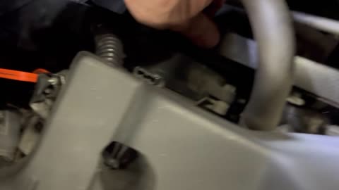

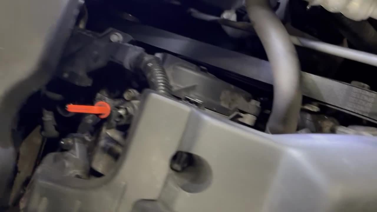

If i press with my fingers on the harness connector of the alternator voltage changes to 14.2v. Not sure if alternator or connector are bad.
Apr 28, 2022 at 5:45 AM
DIVIDES
  • 903 POSTS
I did it several times. Is the regulator in the back of the alternator? I don't see a thing wrong with the connector.

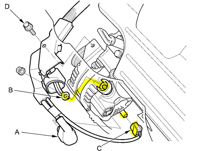

  • 110,240 POSTS
The idea that you identified voltage changes when pushing on the wiring, which is likely where the problem is.
There will be a heavy gauge wire from the battery which has 12v at all times. Make sure it is tight and not corroded and the wire is not damaged in any way. (Letter B in pic 1)
If that checks good, disconnect the two connectors (letters A and C in pic 1) and inspect for pin damage where the connectors come together, inspect the wiring for any damage, or corrosion, and make certain one of the pins isn't loose in a connector.
Since there are three different connections, see if you can identify if there is one that causes the issue. That will help you narrow it down.
Also, it sounds like the alternator isn't the issue. However, it could have an internal wiring issue right off the connectors.
Please keep in mind that there is always power to the alternator. I would recommend disconnecting the negative battery terminal prior to checking connections.
Apr 28, 2022 at 11:33 AM
DIVIDES
  • 903 POSTS
Yes, the heavy gauge wire at the alternator is tight and there is no corrosion. I tried to move it to see if there are any changes in voltage but none. A and C are one connection. A is just the rubber piece on the top of the connector. I will recheck for any pin damage. There is a bit of play coming from the alternator not the connector itself that is why I am suspecting an internal alternator damage.
