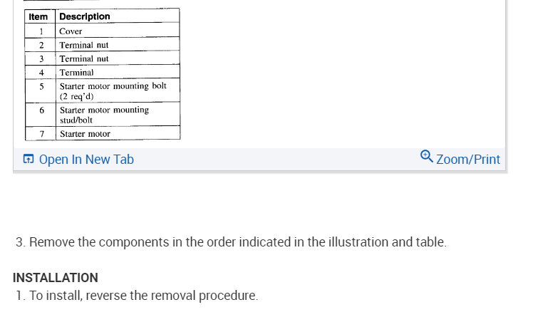

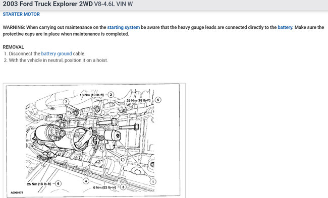

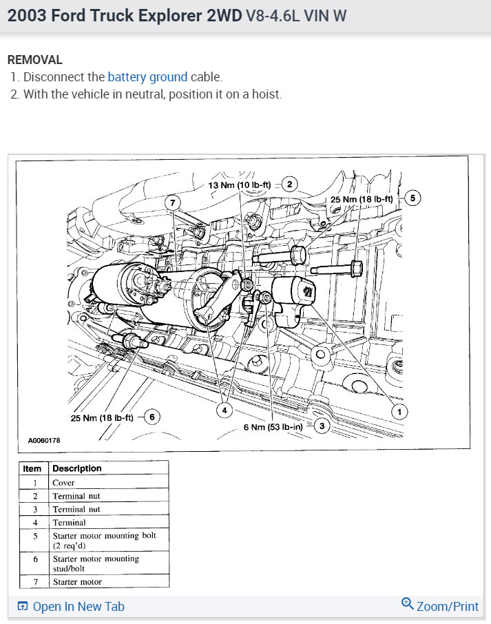

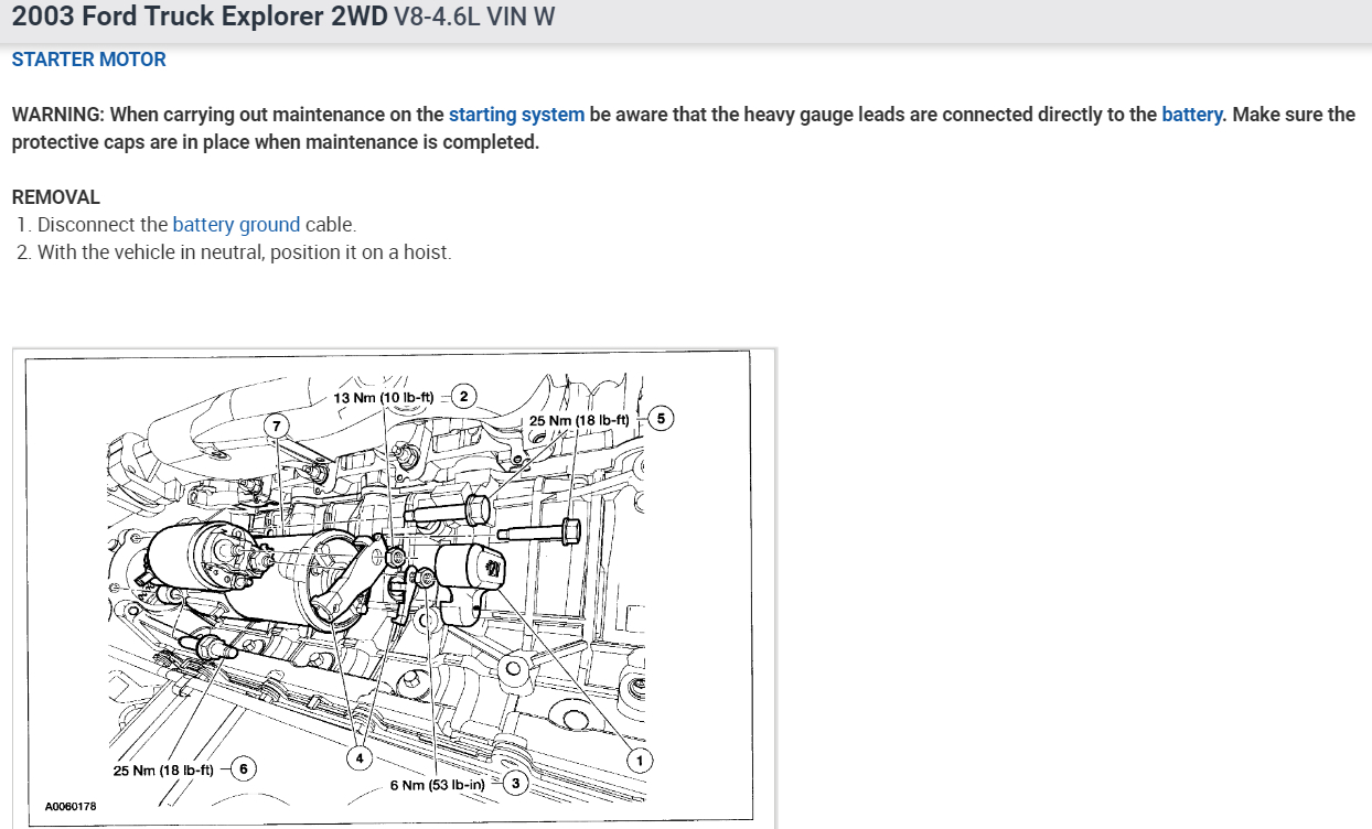

I am in a quandary about changing my starter. I bought a new Ford Starter from FordPartsGiant and I bought it by using the VIN. I am on the fence about changing the starter. The starter on my Ford uses a two-bolt connection to the housing and the new starter I got from Ford has a three-bolt connection. So, the question is, will the new starter fit? Are they interchangeable or do I need to find a two bolt Ford starter? Thanks.
Nov 12, 2023 at 10:03 PM
  • 55,433 POSTS
The starter for your engine has 3 bolt holes, here are the instructions on how to change it out. I have also included a starter replacement guide this will show you the extension you need to do the job as well:
Check out the images (below). Please upload pictures or videos of the problem so we can see what's going on.
