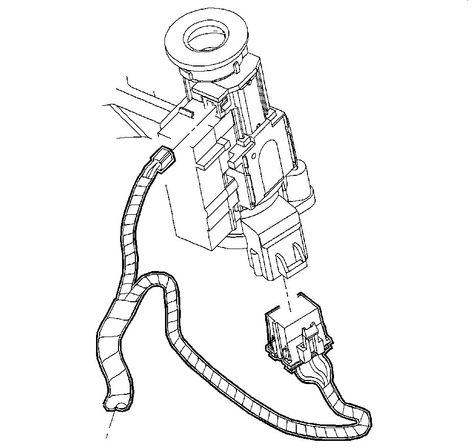

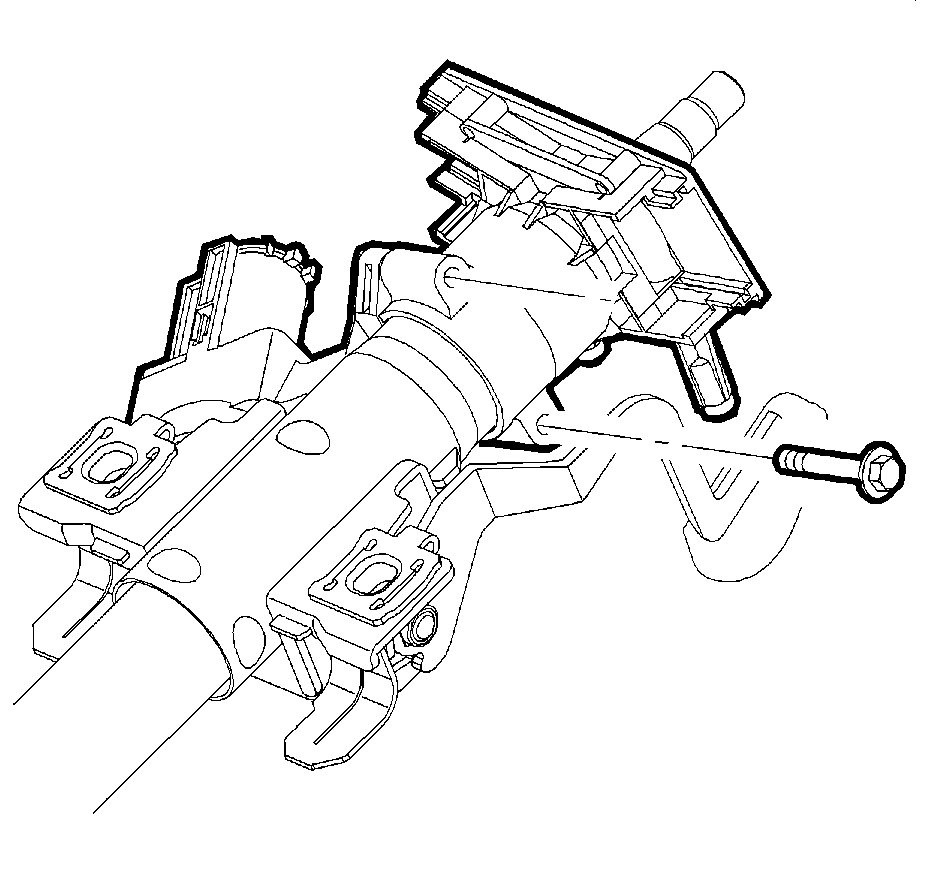

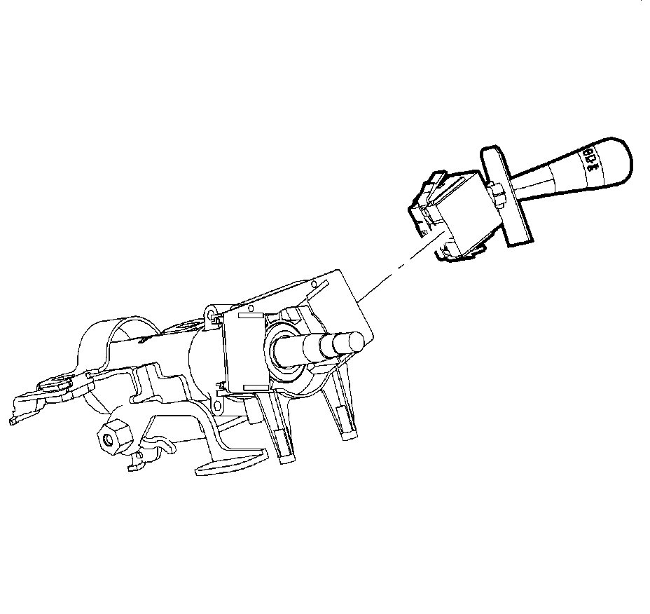

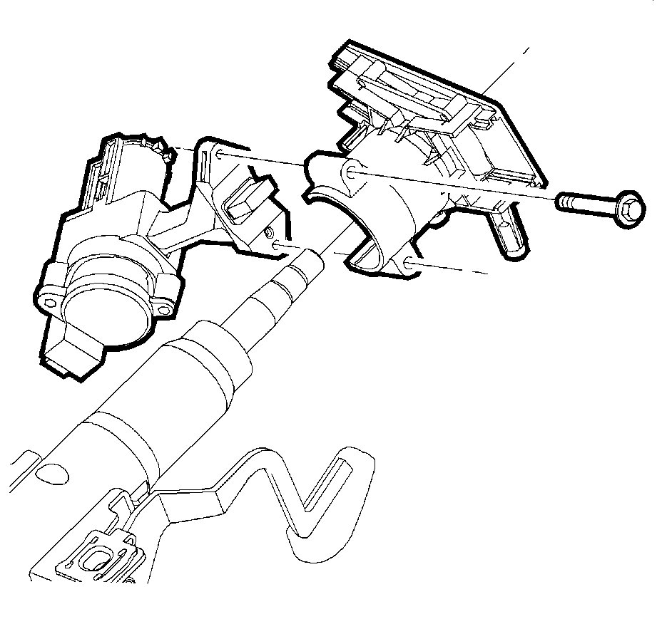

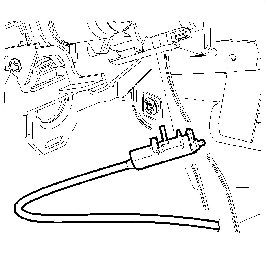

I'm trying to change my ignition cylinder housing but now I hooked it back up and my key won't turn. my will want to stay I was wondering if there's a pain or both that goes from the steering wheel column to the ignition housing?

pic 1
5. Disconnect the housing electrical connectors.
pic 2
6. Disengage the retaining tabs and remove the park lock cable assembly from the housing.
7. Remove the lock housing bolts.
8. Turn the ignition key to the ACC position.
pic 3
9. Separate the lock housing (lock cylinder case) from the multifunction lever bracket. Slide the bracket from the column.
10. Remove the ignition switch screws.
11. Remove the ignition switch.

2. Notice: Position the ignition switch to housing and install the screws and tighten.
^ Tighten the screws to 2.5 Nm (22 inch lbs.).
pic 4

pic 5
8. Snap the ignition lock cable onto the ignition module.
pic 6

The ignition switch did not properly align with the key . You can drop the switch back down and move the cog wheel to the correct position to match the key , reinstall .
May 16, 2026 at 6:29 AM
  • 55,433 POSTS
Yep, that is how to do it which is a common problem when replacing the ignition switch.
