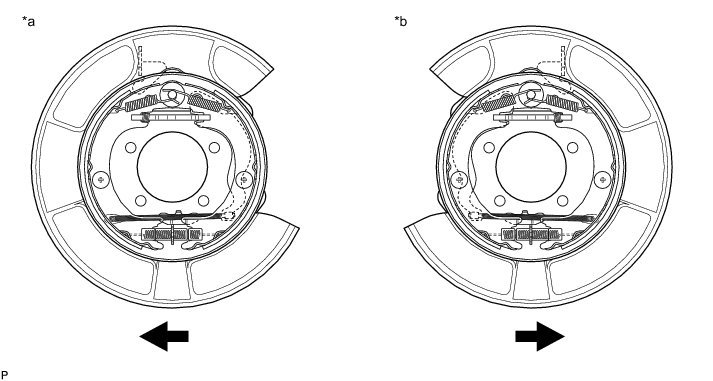

Changed rear rotors and brakes and now wheel won't spin in reverse. Parking brake is engaged in reverse. Replaced all springs/hardware on parking brakes and used PBBlaster to make sure the cable wasn't getting hung up. Tried to drive the car several times and parking brake is definitely on in reverse. Adjusted the adjustment wheel so that the brakes are compacted as much as can be and the hub spins fine forward but stops immediately when spun in reverse. I even put the old rotors back on thinking that would solve it however still acts the same. In the end, by taking out the adjustment wheel spreader the car works, however I have no parking brake and it will not pass state inspection this month without it. I'm at a loss and feel as if I've tried everything.

Are you sure when you installed the park brake shoe lever to the parking brake shoe, there was a spacer there and it had proper clearance? That can cause the brake to not fully release. Also, make sure the hold down pins are installed correctly and holding. Make sure the backing plate that the shoes sit on were properly greased. See directions.

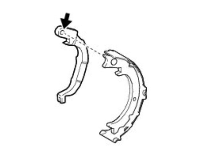

4. INSTALL PARKING BRAKE SHOE LEVER
(a)Apply high temperature grease to the areas of the parking brake shoe lever which make contact with the No. 2 parking brake shoe assembly.
pic 5
(b)Install the parking brake shoe lever and shim to the No. 2 parking brake shoe assembly with a new C-washer as shown in the illustration.
pic 6

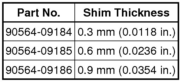

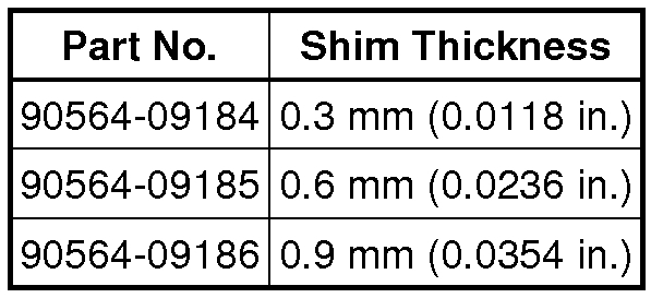

(c)Using a feeler gauge, measure the clearance between the No. 2 parking brake shoe assembly and parking brake shoe lever.
pic 7
Text in Illustration
pic 8
Standard clearance:
Less than 0.35 mm (0.0138 in.)
If the clearance is not as specified, replace the shim with one of the appropriate size.

I had it all right but missed the grease on the backside of the shoes as instructed in 4(a). Added the grease to all spots where brake touches metal and the issue was resolved!
