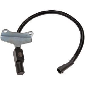

If it does nothing but crank you may have lost spark and fuel. A common failure item on that vintage Jeep is the crankshaft position sensor, it will cause the same symptom, crank but no start.

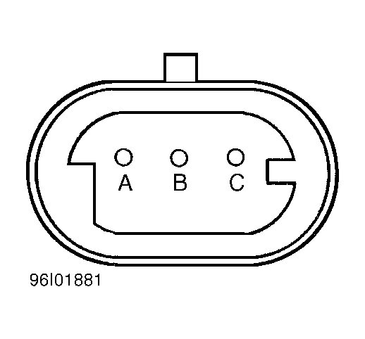

Okay, Take a plug wire off and connect a spark tester to it and see if you have spark. If no spark, which is very likely. Disconnect the crankshaft position sensor and test it for resistance with a meter. You want to find zero resistance between pins B and C in the connector. The CKP is located on the transmission bell-housing at the top rear of the engine. It can be a bear to get at.
