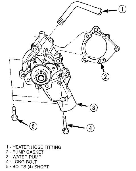

I need to replace my water pump on my Jeep GCL 6 cylinder 4 litre how do I get the water pump off, I tried some Auto parts stores for a spanner wrench they did not have, thank you Declan.

drain cooling system but not when hot remove fan and fan shroud at same time. shorud has 4 bolts holding it in. after shroud/fan removal disconnect hoses remove 5 bolts holding pump .note on eis longer than the rest . remove heater pipe after pump removal and mark location reverse for install
