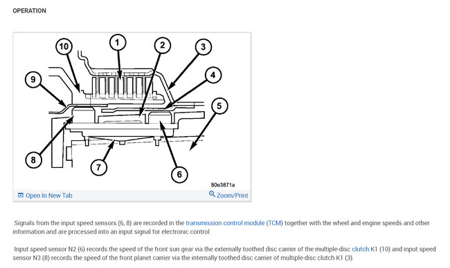

Change speed sensor going to the transmission. Trying to locate and replace the speed sensor.
Oct 29, 2022 at 6:17 AM
  • 55,423 POSTS

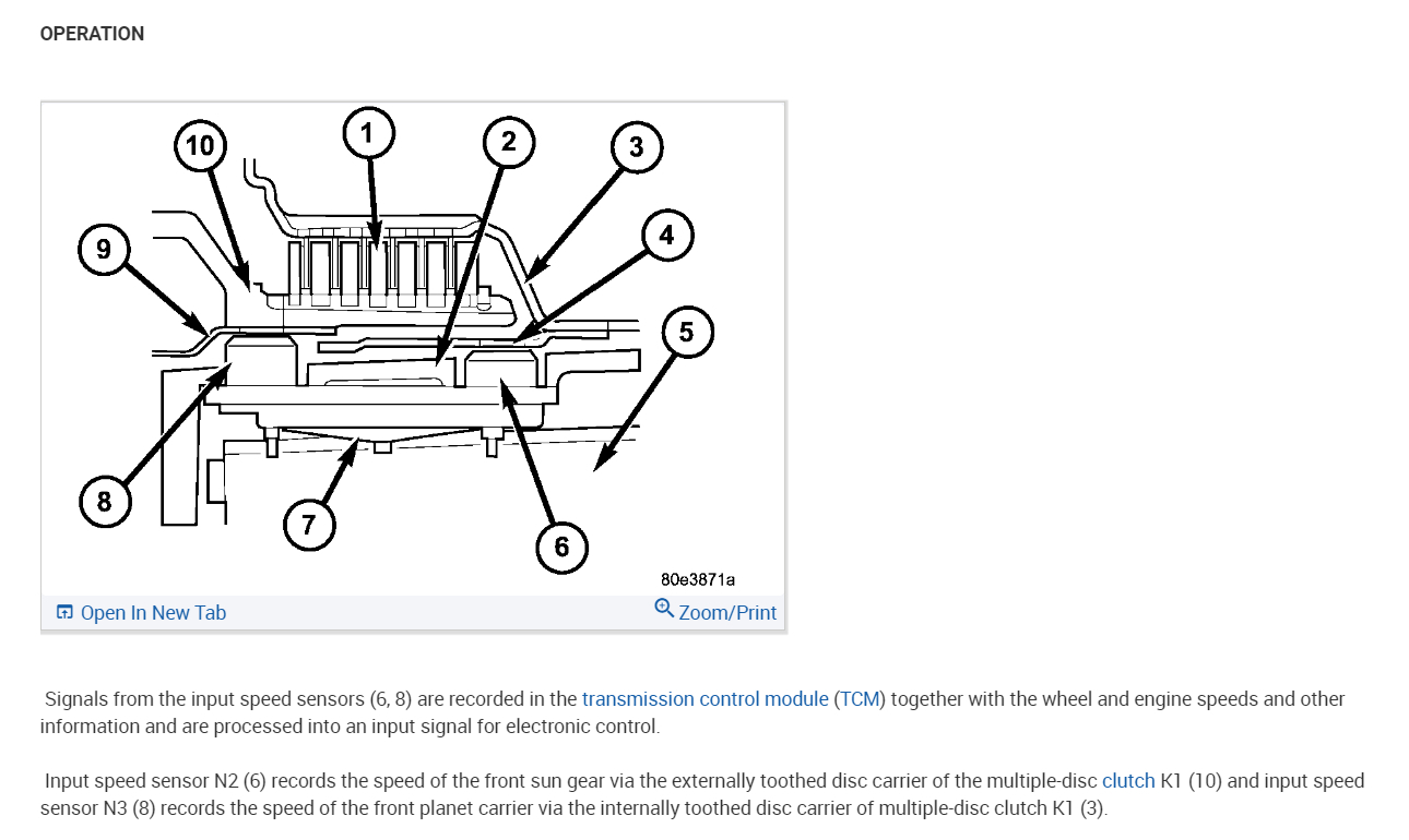

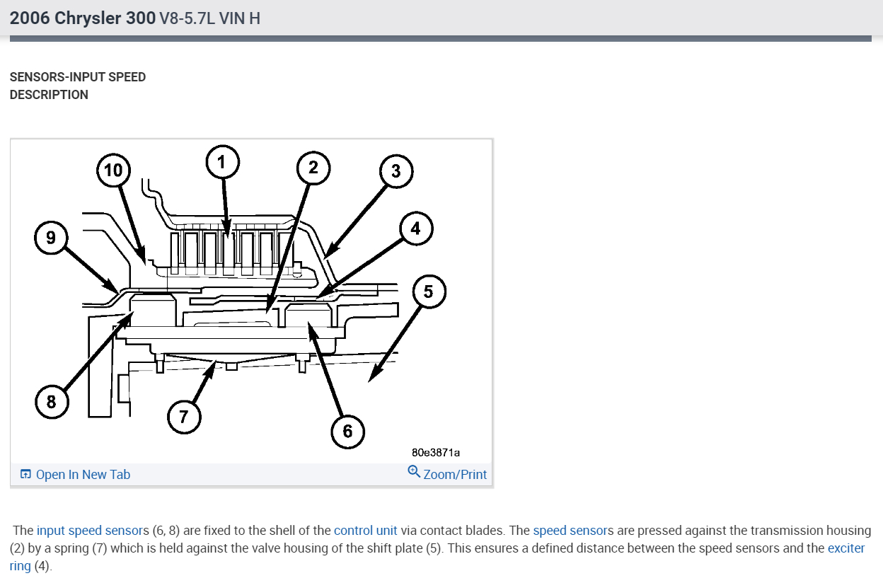

The input speed sensors (6, 8) are fixed to the shell of the control unit via contact blades. The speed sensors are pressed against the transmission housing (2) by a spring (7) which is held against the valve housing of the shift plate (5). This ensures a defined distance between the speed sensors and the exciter ring (4). Check out the images (below). Please let us know if you need anything else to get the problem fixed.
