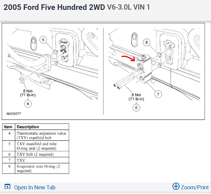

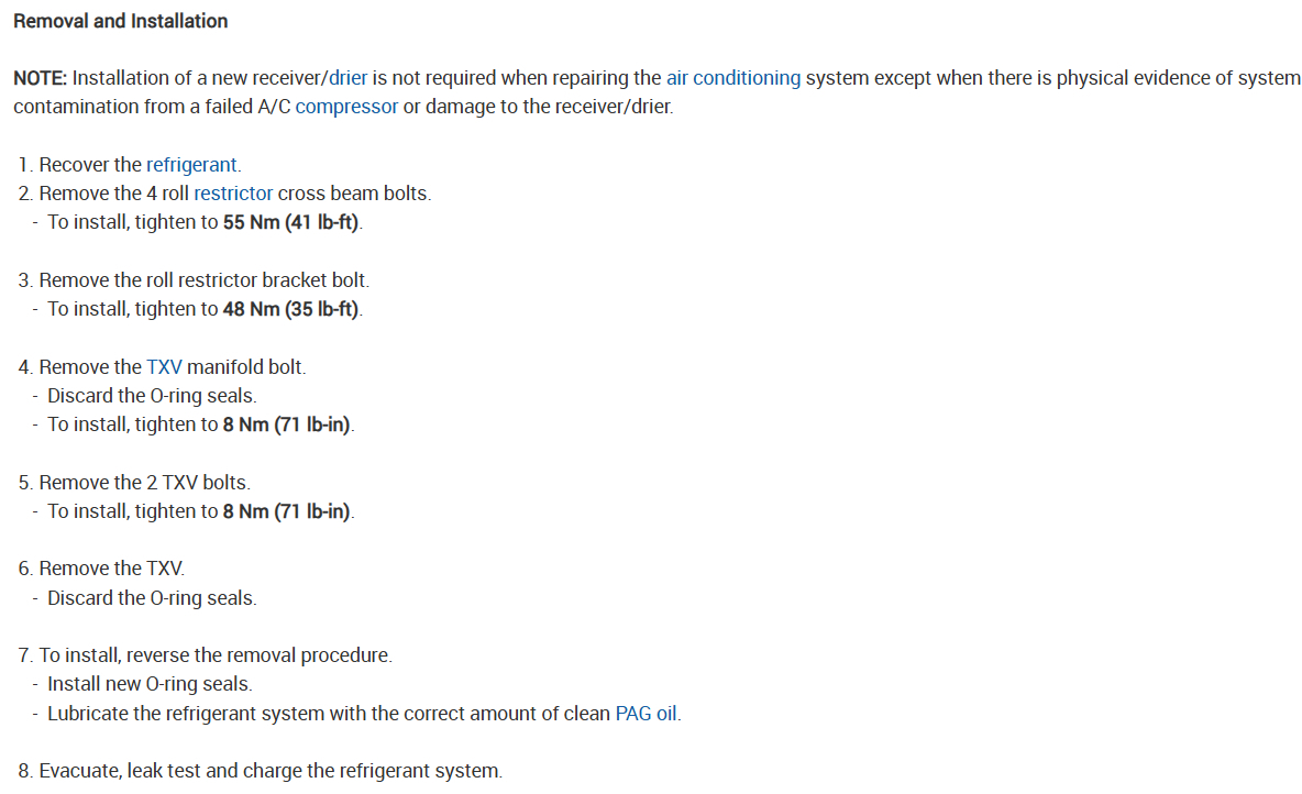

Sure, the expansion valve is bolted to the evaporator inside the car, but the expansion valve sits at the firewall. Here is how to change it out and this video can help vacuum down and recharge the system.
https://www.youtube.com/watch?v=4EqdrBVb0sY&t
Check out the images (below). Let us know if you need anything else.

When replacing the expansion valve no PAG oil is needed. You should be able to see a slight amount of oil inside the refrigerant tubes and valve.

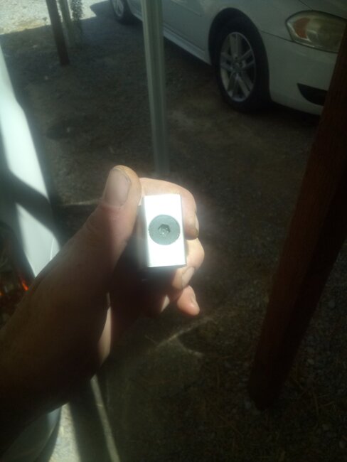

Okay, will take apart and take pics. The weird spot on the bottom doesn't do anything right? It's a weird but shaped hole with rubber on it will include pic of the old one when get back home. Thanks

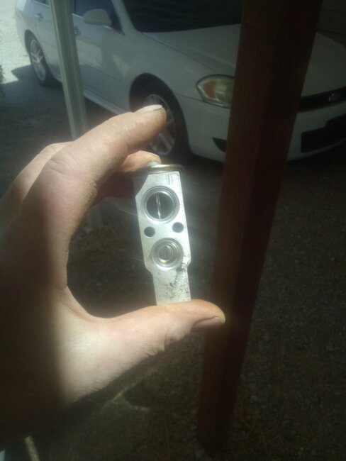

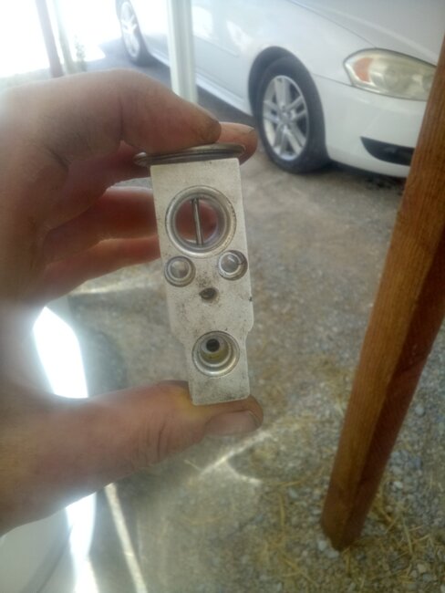

Here's the bottom thing.
Jun 20, 2025 at 11:58 AM
DAVENOOB
  • 333 POSTS
Here's old expansion valve. First pic is the front so line with ring goes into top hole and bottom hole line goes into with ring. Middle hole holds the lines in place and two side holes are for bolts. Most bolts for ac say don't overtighten. Do I tighten these more? I'll open the system and take pics of the current set up as well. thanks.

So I've noticed the new txv had new gaskets on it, but the old one didn't. I'm guessing I might have left old gasket, no o-ring, on the evaporator. Hopefully that's it. Waiting for neighbor to get home so I can get t27 socket and will update once opened thanks.
Jun 21, 2025 at 4:37 PM
  • 54,837 POSTS
Yep, it looks okay, don't worry about the plug in the bottom of the valve, make sure the surfaces are clean and you have new gaskets/seal and you should be okay. Do not over tighten over you will break the evaporator core. Let me know how it goes.
