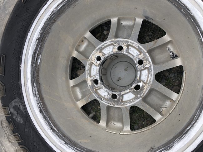

I’m currently in Kyrgyzstan and driving a rental Nissan Patrol 4WD (lots of dirt roads). Our left front tire broke off during a drive in remote mountains. After a lot of trouble we managed to get the car back to a city close by (Naryn). The rental agency says it should be enough to change the bolts. But the bolt holes in the rim seem damaged, see pictures. Is this still a problem when we change the bolts for new ones (what the rental agency wants to do), or should we get new tires?

Definitely needs a new wheel, or put the spare on. Two things can cause this. When the studs snap off, it is typically because the nuts were over-tightened. That stresses the studs, and the friction surfaces between the wheel and nuts gets chewed up. Those surfaces have to be perfectly smooth and matched because it's the friction between them that keeps the nuts tight.
Insufficient tightness can also cause the nuts to slide around and tear up the holes. It looks like that is what happened here. With deformed holes, there is no way to expect the new nuts to remain tight.
