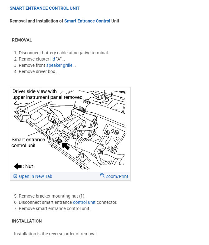

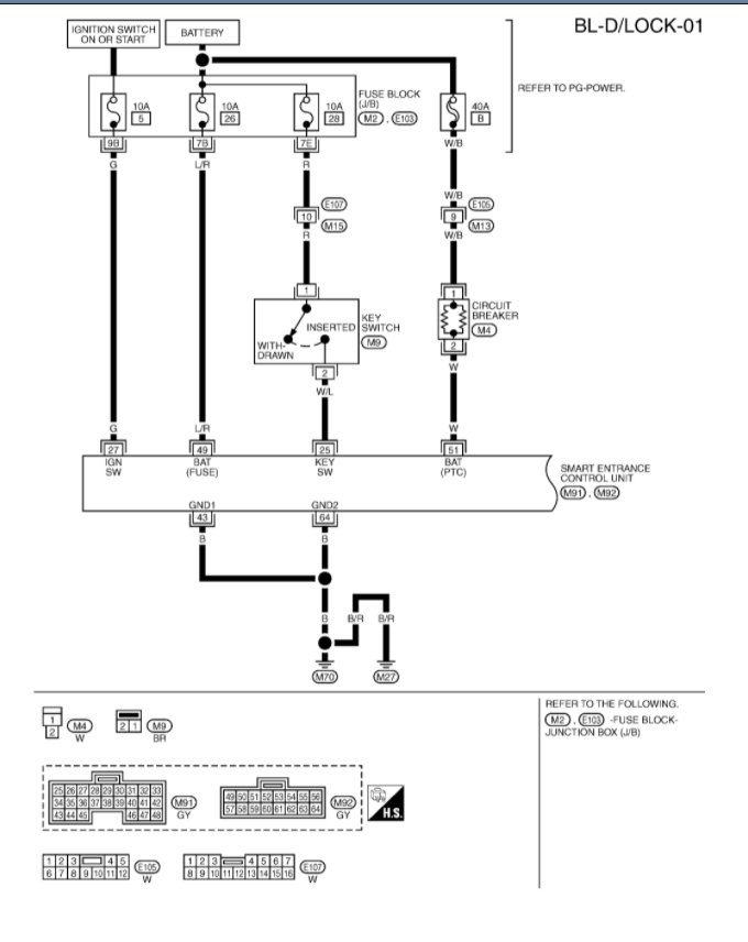

Basically, the smart entrance control unit is what controls the locks, so I suspect the part that you are installing doesn't play well with this module which is what we need to figure out.
I am attaching the info below on this unit and the wiring diagram that we will need to figure out what is missing with this replacement unit installed.
However, let's start with getting the part information so that we can figure out if it may just be the wrong part for this vehicle.

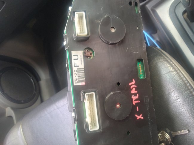

The only number i see is EQ320.

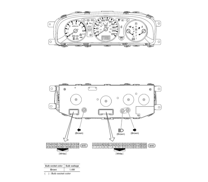

Okay. Unfortunately, that is not going to be enough. Was this clock part of the cluster shown below?
We are just going to need to try and identify the part that you replaced so we can make sure it is the proper one for this vehicle. If it is then I suspect it is just faulty if the old one doesn't cause the issue.

Trying to send picture.
Nov 21, 2021 at 4:41 AM
ALLAN TAKUDZWA NHOWE
I hope you see it replaced the cluster.
Nov 21, 2021 at 4:43 AM
Okay. It looks like that was out of a salvage yard. If so, then that is the issue, and I would return it.
It is hard to see the numbers, but I can see them enough to know that this is not the OEM part numbers. Those are supplier numbers and not the part number that will allow us to confirm what vehicle it came out of.
However, no matter what, it is not going to allow the locks to work so we need to return it. It is either out of a vehicle that does not have power locks, or there is an issue with it that is causing the locks to not work. So again, no matter which issue this is, it is clearly the issue and needs to be replaced.
