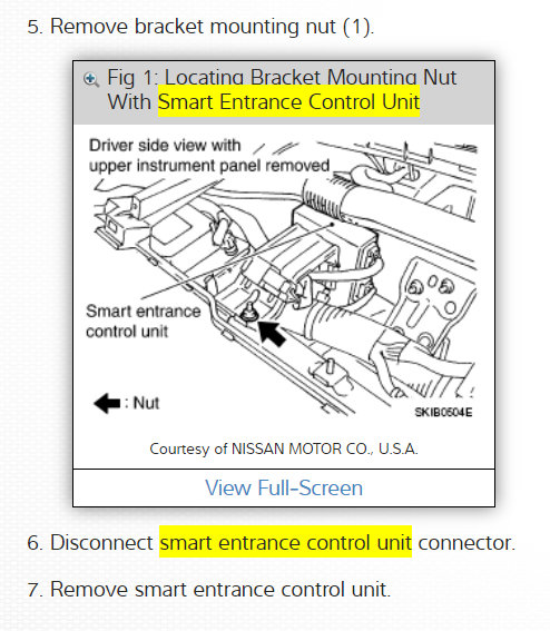

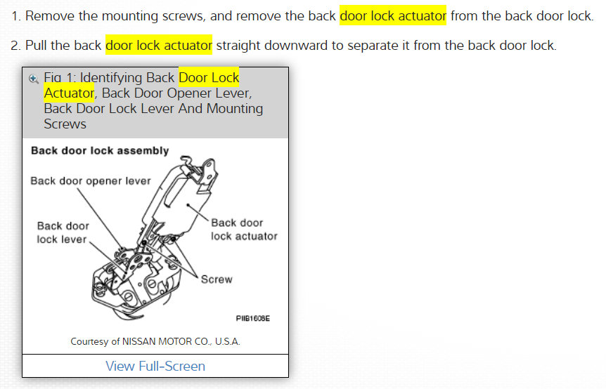

Hello!
As described in the subject line, the problem is the tailgate actuator not responding. However, when i picked it out and tested it with current directly onto the upper contact, the actuator worked just fine.. i have checked all the connections i can find in the rear door, and they all seems to be ok for dirt and corrotion. It is a complete mystery to me -does the rear tailgate actuator have its own fuse?
Furthermore i cannot find any fuse for the centrallocking system at all.
What can the problem be?
Feb 15, 2014 at 11:14 PM
KHLOW2008
  • 41,814 POSTS
It sound like the smart entry control module is not working. Here is its location I would check the electrical connectors for corrosion and make sure the unit does not have water damage. The module is behind the instrument cluster and can get rain from the windshield on it.
Cheers
Feb 16, 2014 at 12:21 AM
