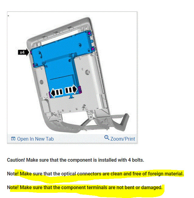

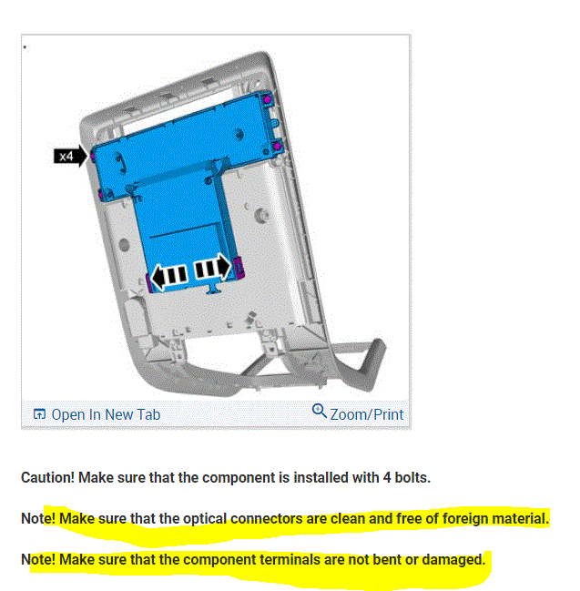

When you installed the new display, were you sure the optic connections were clean, tight, and not bent?
As far as the issue, this unit receives signals via the can-bus. CAN stands for controller area network. Basically, all the computers/modules are tied together via a few wires. If everything is properly attached and in good condition, I recommend having the can-bus scanned for codes. If there is a code stored, it will identify it regardless of the module.
Here is a quick video showing it being done:
https://youtu.be/u-4syLc-ifQ
By scanning the system, it should point us in the right direction. If it isn't done, then it becomes a guessing game. That usually leads to money and time lost.
If you take a look at the attached pic below, it identifies possible concerns.
See pic below.

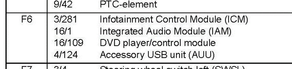

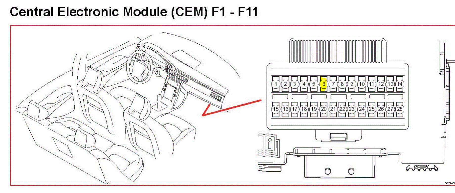

With the key on, does anything related to the display work? Also, when you checked fuse 6 in the central control module (see pic 1), did you confirm there is power to and from it?
Let me know. I'm trying to look through schematics, but everything is asking for a production date. If possible, let me know when it was produced. That way, I can focus on the specifics.

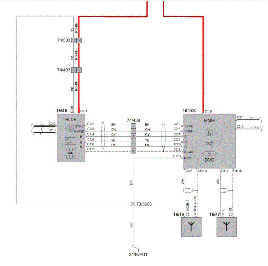

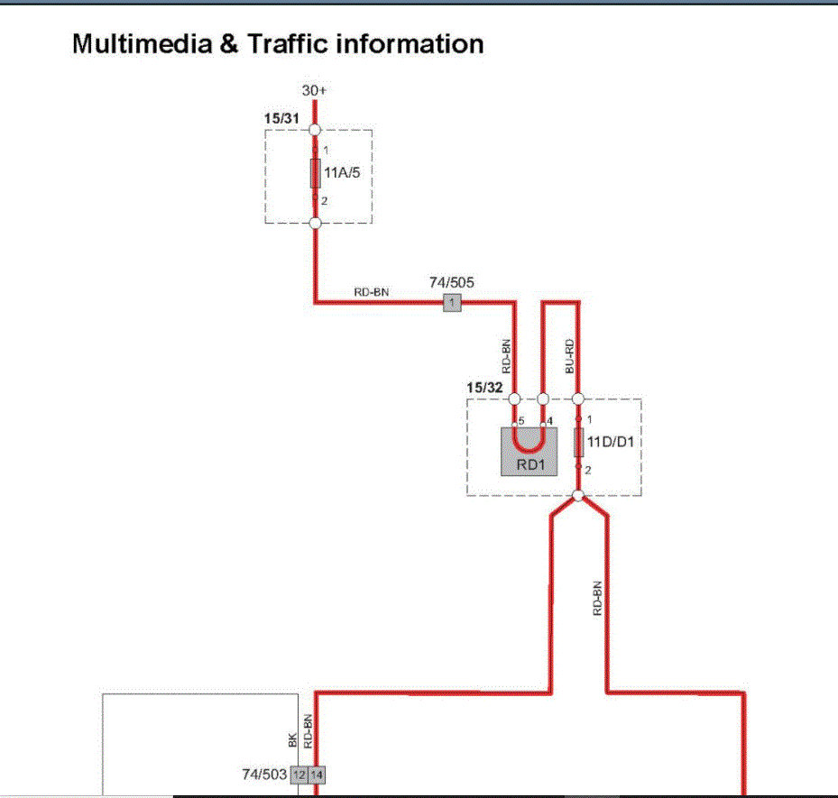

If everything is getting power, signal, and ground, it should be working if you know the unit is good.
Take a look at the attached two pics. It is a schematic of the unit. See if anything stands out to you that could have been missed.
Also, is your scan tool able to read the entire can-bus system?
See pics below. Note: I had to cut the schematic in half to make it readable. I did overlap it so you can follow from one to the next.
