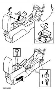

I'd like to take apart the center console to change the dead light bulbs that indicate gear placement. I've checked the fuses..they're fine. I've done a little exploritory and have successfully removed the panel directly under the handbrake and the panel around the rear of the console that reveals two screws.
Before I go any further and muck things up...I feel there's a sequence to removing the center console to get at those indicator lights or light for the shifter peg and I'd like to know the proper moves...could you please help?

Hi John Parcak, Hope the diagram helps.
https://images.2carpros.com/forum/automotive_pictures/192750_CtrConsole01Volvo_1.jpg
