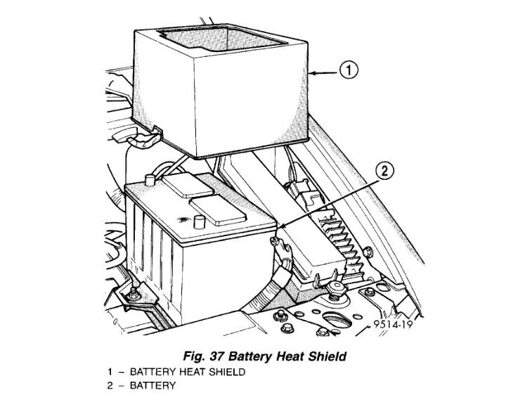

My minivan runs great when cold and even warmed up. intermittently just out of the blue it runs lean and the check engine light comes on. after warmed up some times when warmed up runs normal. when the check engine light is on it only is on when the engine is running, not just the battery. i took it to AutoZone and Advance when the light is on an no codes appeared. i am hesitant to taking to a pro mechanic due to my fear of trial and error. after i start the cold engine after driving 20-25 miles the check engine light shuts off until next time.

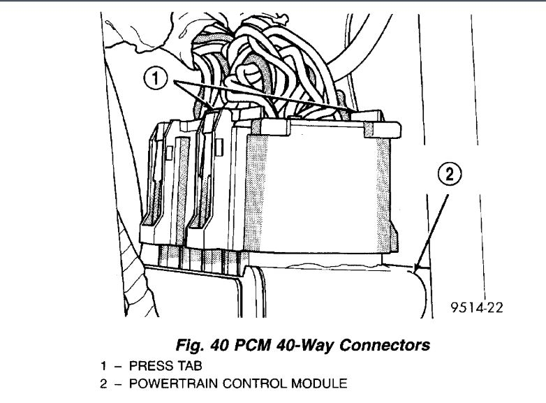

Okay, then there is an issue with the PCM if it is not going into diagnostic mode.
You need to get it checked to be sure but it looks like you need a PCM or the computer.

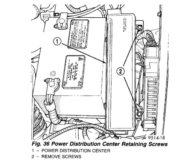

Fig. 36 Power Distribution Center Retaining Screws
2. Remove 2 screws holding Power Distribution Center (PDC) to bracket.
Fig. 37 Battery Heat Shield
3. Remove heat shield from battery.

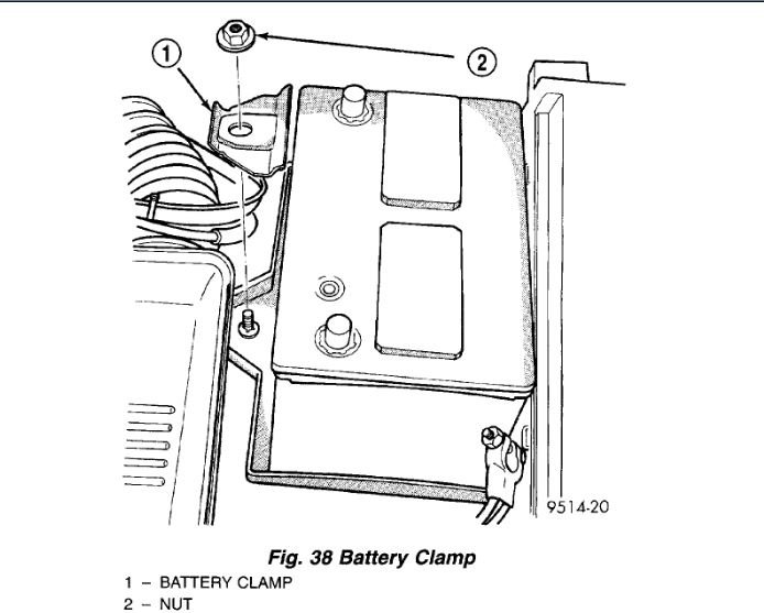

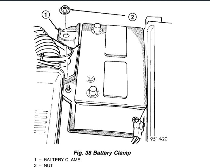

Fig. 38 Battery Clamp
4. Remove nut and clamp holding battery to battery tray.
5. Remove battery from vehicle.

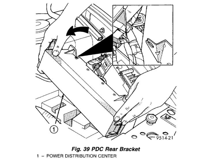

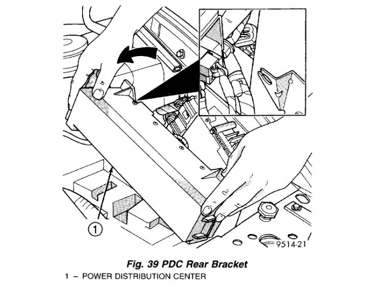

Fig. 39 PDC Rear Bracket
6. Rotate PDC toward center of vehicle to remove from rear bracket.
7. Pull PDC rearward to remove from front bracket. Lay PDC aside to allow access to Powertrain Control Module (PCM).

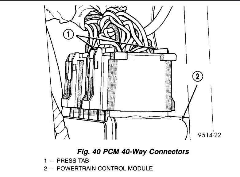

Fig. 40 PCM 40-Way Connectors
8. Squeeze tabs on 40-way connector. Pull connector rearward to remove from PCM. Remove both way connectors.

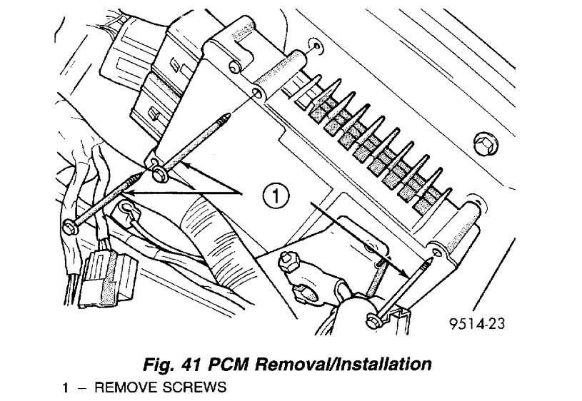

Fig. 41 PCM Removal/Installation
9. Remove 3 screws holding PCM to fende.
10.Remove PCM from vehicle.
