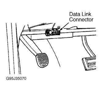

My check engine light has come on but when I check the codes on the digital odometer, the only code that displays is 55 which according to manufacturer is "End of Codes"

Connect an OBDII reader and check for codes and code history check engine light on you have codes
https://images.2carpros.com/forum/automotive_pictures/99387_Graphic1_586.jpg

I have had the same problem but it developed into whether it would run or not. It would turn off on the highway and in town. The light would turn on but as you say it had "No Code". Anyways, something that you should check should be the cam and crackshaft sensors. These are the two main sensors to go bad on those types of vans. They are very easy to get to and signs of problems are such as: the wires have shorts or bad places, bad connection, the sensor has physical damage.
