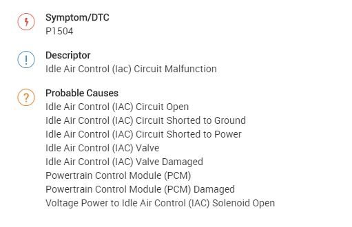

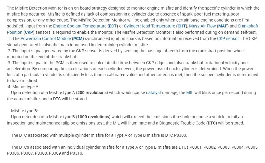

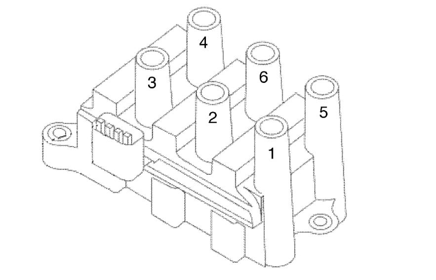

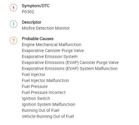

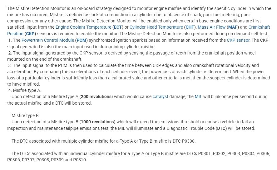

The 302 is a misfire for cylinder 2. I would check the compression to be sure there is nothing wrong with the cylinder.

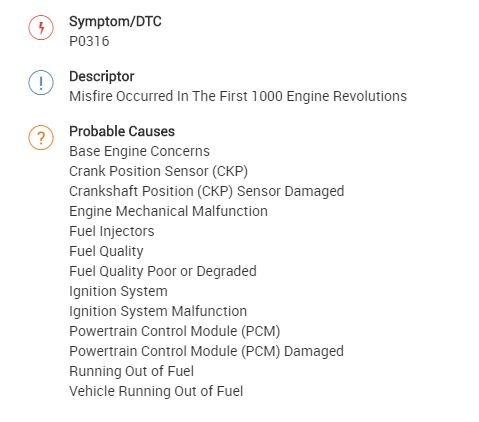

The 316 is a misfire in the first 1,000 RPM's when it started It indicates a bad ignition coil.

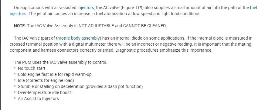

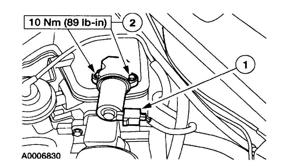

1504 is for idle air control. A common failure for the idle air control valve.

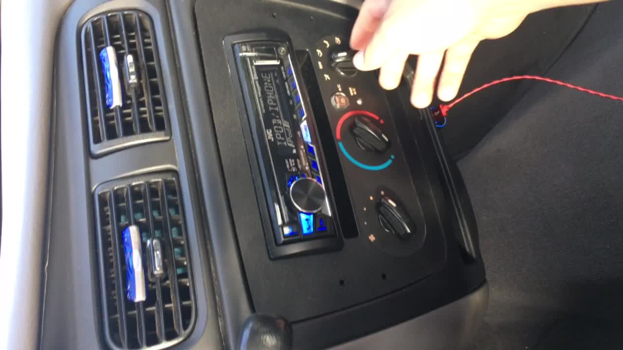

JGONZO2398
  • 374 POSTS

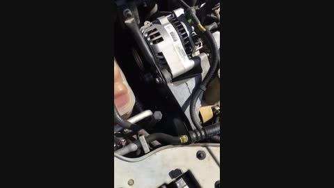

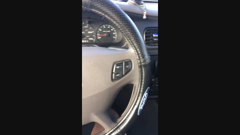

This is all I could get, turning on the ac and having the car jerk and stutter right after, I don’t know if you can notice

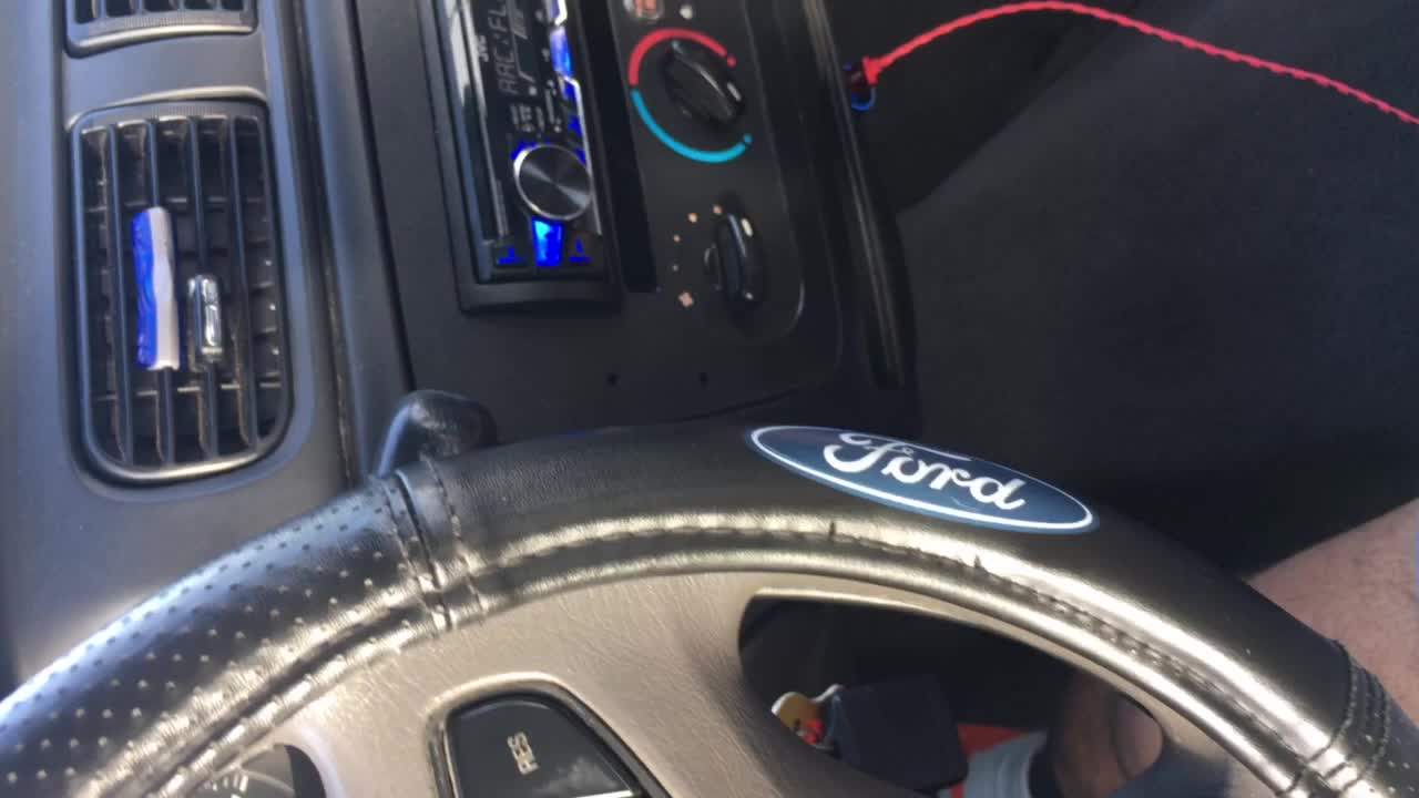

JGONZO2398
  • 374 POSTS

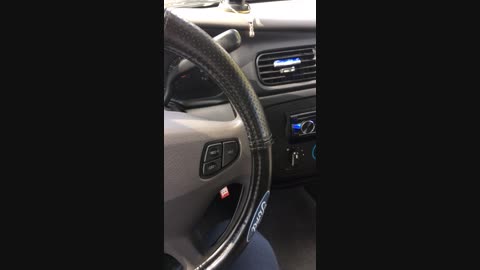

Here is this one with the AC at max:

  • 55,721 POSTS
Thats for the videos, It think the AC system might be low on charge causing the compressor to start and stop causing the idle fluctuation. Can you lift the hood and see if this is the case. This guide will show the compressor clutch you will be looking at.
Jan 16, 2021 at 1:26 AM (Merged)

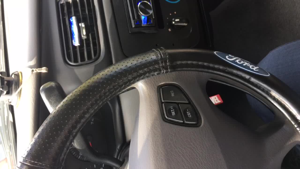

JGONZO2398
  • 374 POSTS
This is another video I took, this was on park, it kept jerking and it sounded like the AC clicked.

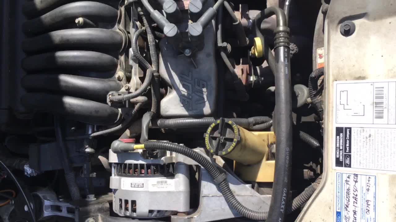

JGONZO2398
  • 374 POSTS
This is one of the engine with AC on MAX.
  • 55,721 POSTS
I cannot see it having a problem. can you get a video of the actual problem? I need to see whats going on.
JGONZO2398
  • 374 POSTS
Turns out it was the spark plug cables, easy fix. Wow

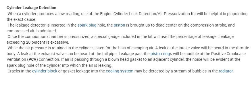

I have a 2002 Ford Taurus with the 3.0L OHV engine. I have been experiencing a missfire ever since purchasing the car. I have replaced so many components I'm down to a valvetrain issue. I just did a running compression on two of my cylinders and both were not even reaching 30 psi. When I revved the engine the compression dropped way down to barely being registered on the gauge. Is this evidence of weak valve springs or no? Also, the CEL is not being illuminated but the Mode6 data from my PCM indicates a small misfire on all cylinders (the last time I checked it).
Jan 16, 2021 at 1:28 AM (Merged)
BMRFIXIT
  • 19,053 POSTS
dry and then wet compression test should be done 1st ,compare reading
running compression test not so sure
JABRUNN
  • 12 POSTS
I did a dry compression test several months ago and everything checked out. All cylinders were within 15 psi of each other. The running of the vehicle hasn't changed since then I just decided to finally take a stab at checking the running compression. I can do a wet compression but it would be this weekend before I could do it.
