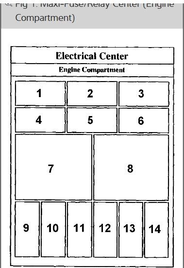

Where is the fuse for the CD player and my passenger climate control blows heat but ever where else blows cold and I bought the car there is no fuse box cover wonder the hood and I don't know what fuse is what please help

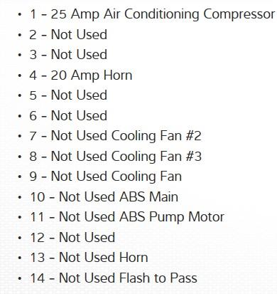

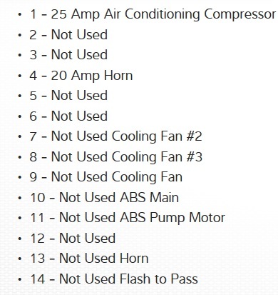

The picture is for your underhood fuse box.
As far as your cd player, 1p2 fuse--10 amp, right rear junction block. At the cd player, the orange wire is voltage and the black wire is ground. Check for voltage and ground. Your radio uses the same fuse circuit and ground, so if the radio works and the cd player doesn't, could be faulty cd player. It's a good idea to check voltage and ground, anyway.
