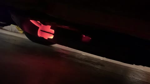

Can’t figure out why my catalytic converters are glowing causing exhaust manifold to glow. also changed spark plugs thinking it was misfiring, but no codes.

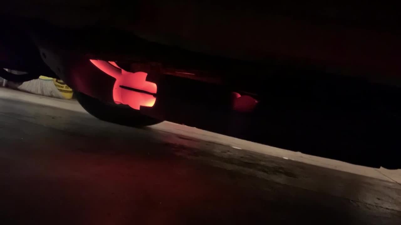

Lastly, is it possible to get a picture or quick video of the catalytic converter glowing? Maybe at night so we can get an idea as to how severe it is.

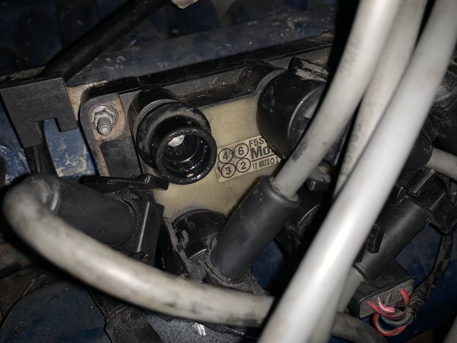

Yes and in Buffalo so pretty cold now. could be because of not changing spark plug wires or the ignition coil pack?

Exhaust manifold glows and the catalytic converter glows, all the way once it keeps running the whole thing. just figured not let it get to that much and also have a video sounds like it’s knocking or pinging if can hear it.

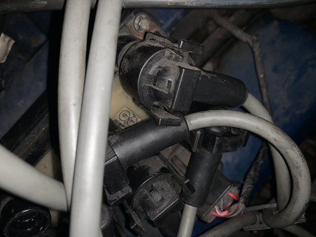

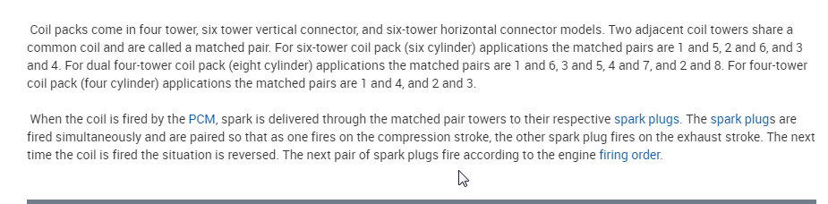

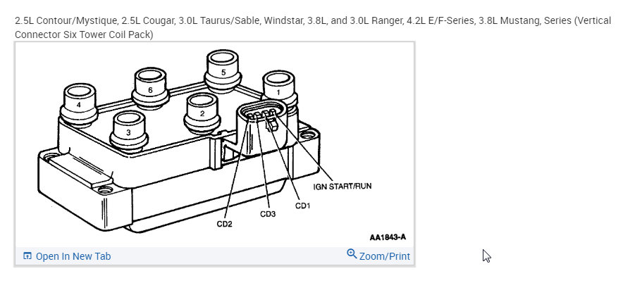

And also the coil pack; do you hook up spark plugs according to numbering on it? because that’s how I have it now.
Feb 1, 2020 at 7:40 PM
Could be. The coils on these vehicles have been known to fail. How long does it have to run before the converter starts glowing?

Sorry just posted this and then saw the videos. That thing is running pretty rough and that thing is red hot so you weren't exaggerating. I am surprised there are no codes.
However, now that I have seen that, your issue could be one of a couple things. First is a misfire so we need to suspect that coil.
Next, the converter could be clogged. Are you able to measure the back pressure? This is where you remove the o2 sensor and install a gauge made for this. If you don't have one don't buy one. Try removing the upstream o2 on that side and see if the engine smooths out. It is going to be loud but a clogged converter can glow and cause rough running. If you want to an exhaust shop can measure back pressure and it is pretty cheap. Cheaper then guessing at replacing the converter.
After that, we have to suspect internal engine issues as valve issues or piston ring issues.
Clearly with that glowing that red, it is a safety issue. That can catch the surrounding components on fire so be careful.

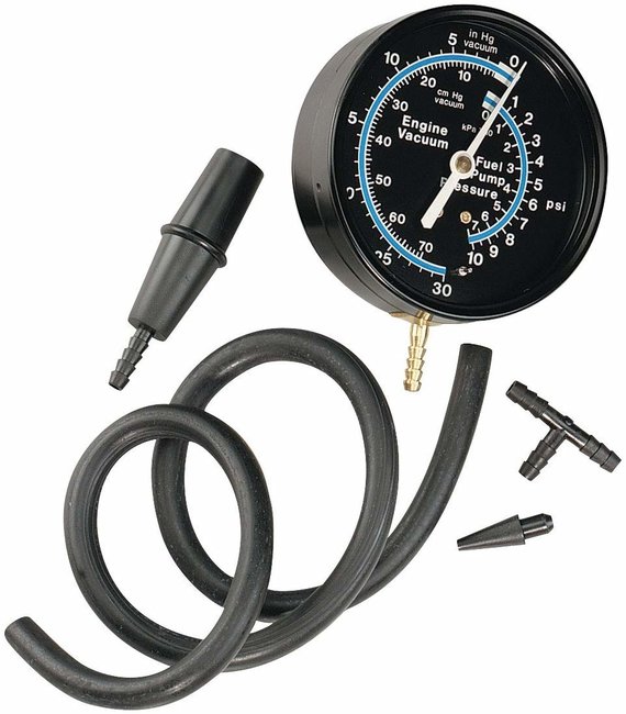

What do I use to test for pressure and could it be the EGR valve maybe?
Feb 2, 2020 at 5:55 PM
STEVE W.
  • 15,200 POSTS
The pressure testing uses nothing special, just a simple fuel pressure vacuum test gauge.
