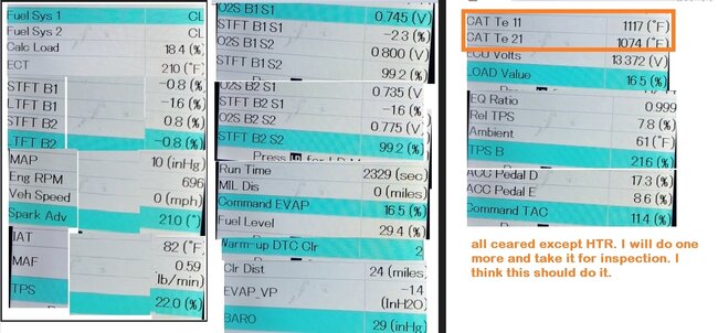

20 warm up drive cycles and Cat monitor still not ready. no codes, nothing wrong (battery was disconnected and bad; replaced it and performed drive cycle multiple times but still not clearing). I just cleared the DTC thinking it might reset itself. Now, I will be starting all over again. I was wondering if there is anything I can do to speed up the process.

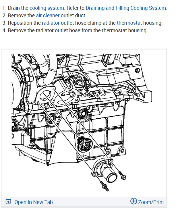

Can I ask if the engine warms up to operating temperature? If the engine stays cold because of a stuck thermostat open it will take forever for the monitors to set. Please go over this guide which can help us:
https://www.2carpros.com/articles/how-to-reset-an-engine-computer-monitor-program

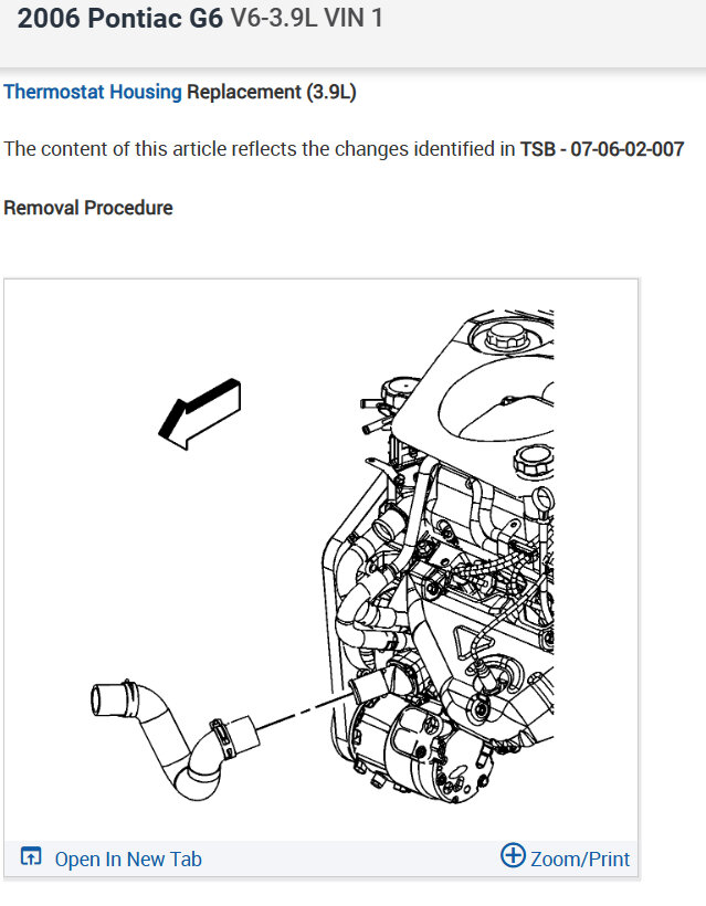

Here is how to change the thermostat out in case you see that the engine is not heating up correctly. Check out the images (below). Please let us know what happens.

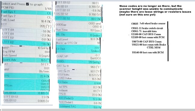

that is similar to what i usually do: idle 5 minutes, idle with 1000 rpm steady for 1 minute, 5 minutes at 35 mph, 5 minutes at 45 mph, 3 minutes at 55 mph, decelerate to 20 mph without braking, back up to 60 mph for 5 minutes, back to city traffic and stop and go, then idle for 3 minutes and off. from cold repeated for 20 cycles. today, did the same, tried to hook up the Innova lat + with live data scanner: it gave me error KW 2000 unable to communicate bus can. Previously there were similar codes (but not recently) those were see image below.

I forgot to mention although the CAT did clear, the HTR is not clearing now. The reset allowed me to clear the CAT but I'm sure why the HTR is not clearing. What are the specific HTR drive cycle components? What part of the drive cycle is essential for this step?

Well, Ken, it cleared as well and got it to pass. I did some more research, and I found out what part of the cycle clears the H.T.R. To all ow the E.C.M to calculate the data for the O2 heater sensor, the exhaust must not get too hot (something that is needed to monitor the Catalytic convertors (the opposite applies here). The engine needs to be cold (within 11 degrees F of ambient temperature). The idle must be about 2 to 3 minutes (no throttling should be done here. In other words, the RPM should remain steady). The car then can be driven gently for about 5 minutes at 25 to 45 mph (the lower the speed, the better). Shutting off the engine and removing the key (must not restart or turn the ignition on for at least 15 minutes after the gentle drive I mentioned). This will allow the E.C.M to calculate the data from the heater sensor. It is important not to turn on any heating or air conditioning, lights or radio in order to keep the load to a minimum (again this is not the case with other monitors). So, in summary, different monitors require different drive cycle procedures. That is why most people get frustrated when they follow the drive cycle procedure but don't clear everything. What cleared the Catalytic converter was getting the exhaust hot enough for the E.C.M to calculate the Data from both Catalysts. Thank you again.
