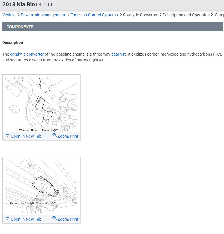

How many are on this car and location?
Feb 24, 2022 at 12:06 PM
SQM
  • 6,383 POSTS

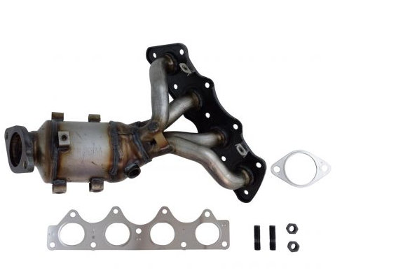

This vehicle is equipped with two catalytic converters.
One is part of the exhaust manifold, and the second one is under the vehicle in line with the exhaust.

I suspect a clogged cat because I have no pedal response, which of the cats are more likely to be the cause of this? I am hoping it’s not the one on manifold.
Feb 28, 2022 at 1:20 PM
SQM
  • 6,383 POSTS
It is tricky to guess which one. I have seen it happen on both the primary and secondary catalytic converters.
Here is one thing you can try, that can help you determine which one.
Use an infrared thermometer and measure the exhaust temperature. Measure the temperature just before and after the converter. If either of the converters is clogged, the one with the clog will have significant temperature difference between the inlet and outlet, due to restriction of air flow.
