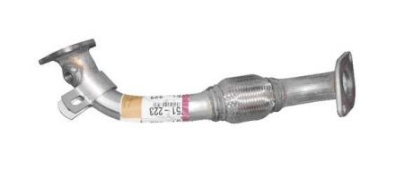

You need to find out what is leaking on the exhaust to really put a price on it.
I would suspect the flex portion has come apart and you need this pipe:
https://www.2carpros.com/forum/automotive_pictures/30961_827791_1.jpg
I would think this will run around $250 installed.
