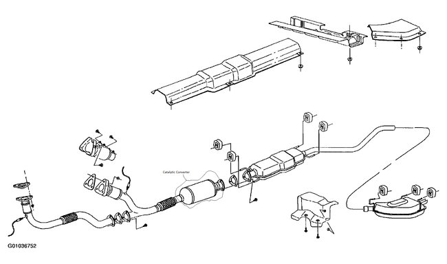

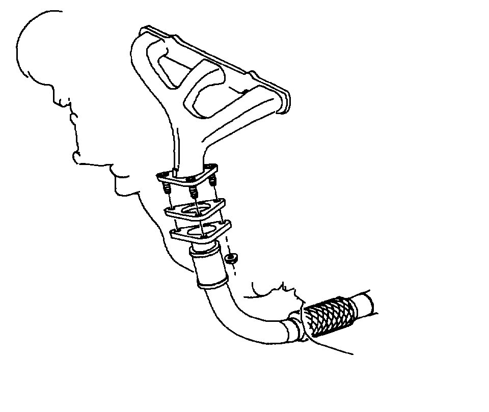

How many catalytic converters on the 3.0l engine, and where are they located? I found one, but need to locate the other. Can you send me a diagram? Need to know how to remove the upper Catalytic converter (or Catalytic converters?).
Jan 27, 2019 at 11:26 AM
HARRY P
  • 2,292 POSTS
Hello and thanks for using 2CarPros. I've looked up your car and it only has the one catalytic converter. I'm attaching a diagram of your car's exhaust system, provided by GM. Since GM didn't actually label the diagram for some reason, I've labeled the catalytic converter for you. Looks like removal will require cutting the exhaust pipe on the upstream side of the converter (the side nearest the engine) and installation will require welding. Kind of a dumb design if you ask me, but this is actually fairly common for some reason. Hope this information helps and let us know how it goes for you.
PS. if you buy your parts at the GM dealership, you can probably avoid the cutting and welding because they'll sell you the while converter with the Y pipe, new flange/donut gaskets, and a new resonator (the little thingy to the left of the converter in the attached image). But it'll probably be ridiculously expensive to buy the parts there.
Jan 27, 2019 at 12:20 PM
JONSOLOW13
  • 133 POSTS
Heyman:
Thank you so much for your timely response!
May I take more of your time to discuss our issue?
Jon
Jan 27, 2019 at 12:25 PM
  • 110,244 POSTS

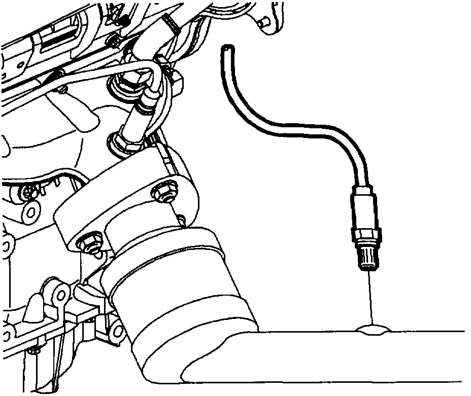

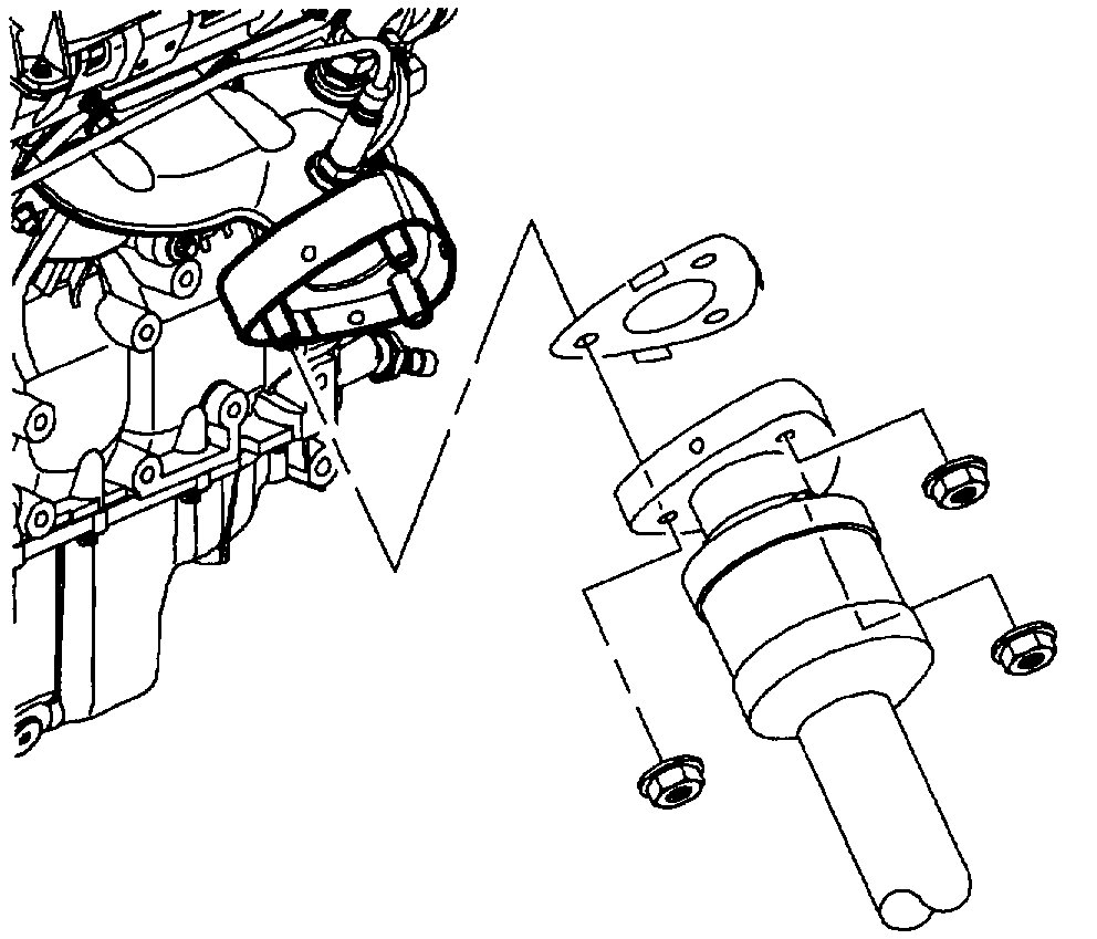

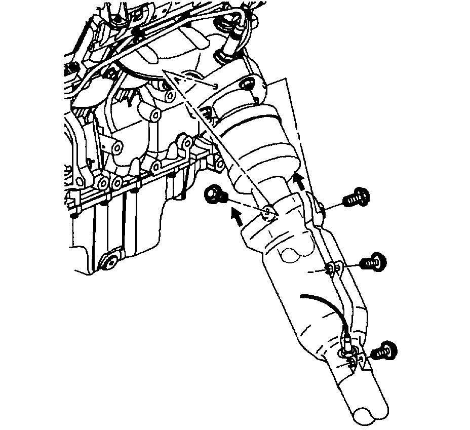

There are two pre catalytic converters on your vehicle and one three way. On the down pipe from the exhaust manifolds are the catalytic converters. The two pipes join together and then exhaust runs through the three way converter.
As far as the upper catalytic converters (pre catalytic converters) they bolt directly to the exhaust manifold. I will provide directions. I am going to start with the front. All attached pictures correlate with these directions.
FRONT EXHAUST MANIFOLD PIPE
REMOVAL
NOTICE: Do not apply grease or silicon products to the heated oxygen sensor. Do not alter the wiring in any way. The wires carry air reference to the sensor.
Picture 1
1. Remove the heated oxygen sensor electrical connector
CAUTION: MAKE SURE VEHICLE IS PROPERLY SUPPORTED AND SQUARELY POSITIONED ON HOIST.
2. Raise vehicle on hoist
3. Remove heated oxygen sensor.
Picture 2
4. Remove exhaust manifold pipe to exhaust manifold nuts.
Picture 3
5. Remove front exhaust manifold pipe to rear exhaust manifold pipe attachment bolts.
INSTALLATION
Picture 4
1. Position gasket on exhaust manifold pipe.
2. Position front exhaust manifold pipe into vehicle.
NOTICE: Do not tighten fasteners.
3. Install exhaust manifold pipe to exhaust manifold nuts.
Picture 5
4. Position gasket between front and rear exhaust manifold pipes
5. Install front exhaust manifold pipe to rear exhaust manifold pipe bolts and tighten
Torque:
Exhaust Manifold Pipe Bolts: 20 Nm (15 ft. lbs.)
6. Tighten exhaust manifold pipe to exhaust manifold nuts
Torque:
Exhaust Manifold Pipe-to-Exhaust Manifold Nuts: 30 Nm (25 ft. lbs.)
Picture 6
NOTICE: Always use a pickle-based anti-seized compound (Saturn P/N 21485279 or equivalent) on the threads of the oxygen sensor If the oxygen sensor is replaced, do not apply anti-seize to the new sensor. New sensors have anti-seize pre-applied. Never use silicon product; silicon products will cause damage to oxygen sensor.
7. Install the heated oxygen sensor
Torque:
Oxygen Sensors (Lower Exhaust Pipe): 45 Nm (33 ft. lbs.)
8. Connect heated oxygen sensor harness connector
9. Lower vehicle from hoist
10. Start engine and check for exhaust leaks

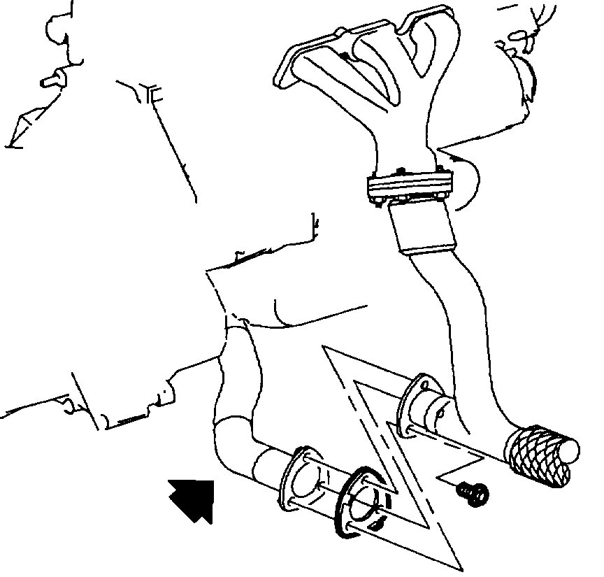

_____________________________________
Here are the directions for the rear pre cat
REAR EXHAUST MANIFOLD PIPE
Picture 7
1. Remove exhaust manifold pipe heat shield.
Picture 8
2. Remove heated oxygen sensor electrical connector.
4. Raise vehicle on hoist.
Picture 9
5. Remove rear exhaust manifold pipe to exhaust manifold nuts
Picture 10
6. Remove rear exhaust manifold pipe to front exhaust manifold pipe attachment bolts.
Picture 11
7. Remove rear exhaust manifold pipe to resonator bolts.
8. Remove rear exhaust manifold pipe from vehicle.

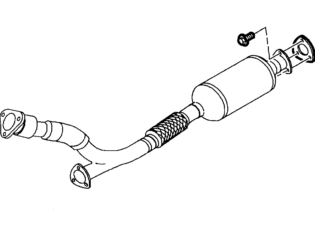

INSTALLATION
NOTICE: Do not tighten fasteners at this time.
Picture 12
1. Install exhaust manifold pipe to exhaust manifold gasket, position pipe into vehicle.
2. Install rear exhaust manifold pipe to exhaust manifold nuts.
Picture 13
3. Position gasket and install front exhaust manifold pipe to rear exhaust manifold pipe bolts.
Picture 14
4. Position gasket and install exhaust manifold pipe to resonator bolts and tighten
Torque:
5. Tighten exhaust manifold pipe to exhaust manifold nuts
Torque:
6. Tighten rear exhaust manifold pipe to front exhaust manifold pipe bolts
Torque:
Picture 15
7. Lower vehicle from hoist
NOTICE: Always use a pickle-based anti-seized compound Saturn PIN 21485279 (or equivalent) on the threads of the oxygen sensor. If the oxygen sensor is replaced, do not apply anti-seize to the new sensor. New sensors have anti-seize pre-applied. Never use silicon product; silicon products will cause damage to oxygen sensor.
8. Install heated oxygen sensor
Torque:
9. Connect heated oxygen sensor harness connector
Picture 16
10. Install exhaust manifold pipe heat shield
Torque:
Exhaust Manifold Pipe Heat Shield Bolts: 8 Nm (71 inch lbs.)
11. Start engine and check for exhaust leaks

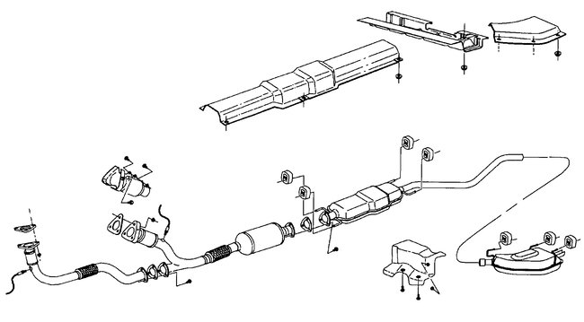

I hope this helps. The last picture shows the entire system. Let me know if you have other questions or need additional help.

One last question, since the engine is in the car, and the car is up on jack stands, can one get to the exhaust manifold directly to remove the upper pre catalytic converter?
By the way, this is an amazing website. How can I show my appreciation?
Jon
Jan 27, 2019 at 12:46 PM
  • 110,244 POSTS
Hi Jon:
Thanks for the kind words. Your appreciation can be shown by telling others about the site and coming back yourself.
As far as your question, yes. You can access them if the car is lifted. Most likely you will need to remove a heat shield. Before you do it, however, I would spray them down with a good penetrating oil and allow them to sit for awhile.
You will see that the two down pipes that have the pre catalytic converter,s connect right behind the engine. Basically, they make a Y pipe. At that point, I believe there is a flex pipe that attaches the rest of the system and the three way.
Let us know what you find or if you have other questions.
