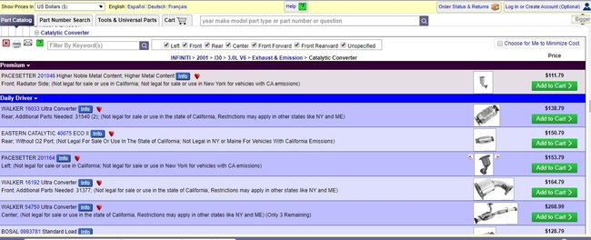

A total of 3. One for the left bank, one for the right bank and a warm up converter.
I attached the parts list for from Rock auto. It shows all 3 converters.

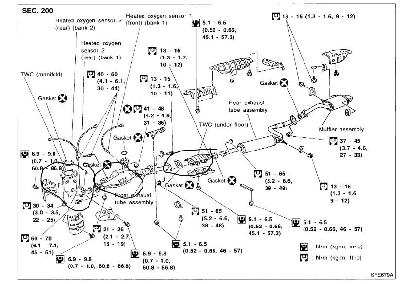

MADELINE MASTERSON
No cut and weld to fix just unbolt and replace? Is there a picture of there location like a diagram of some kind?
Nov 13, 2019 at 5:16 AM

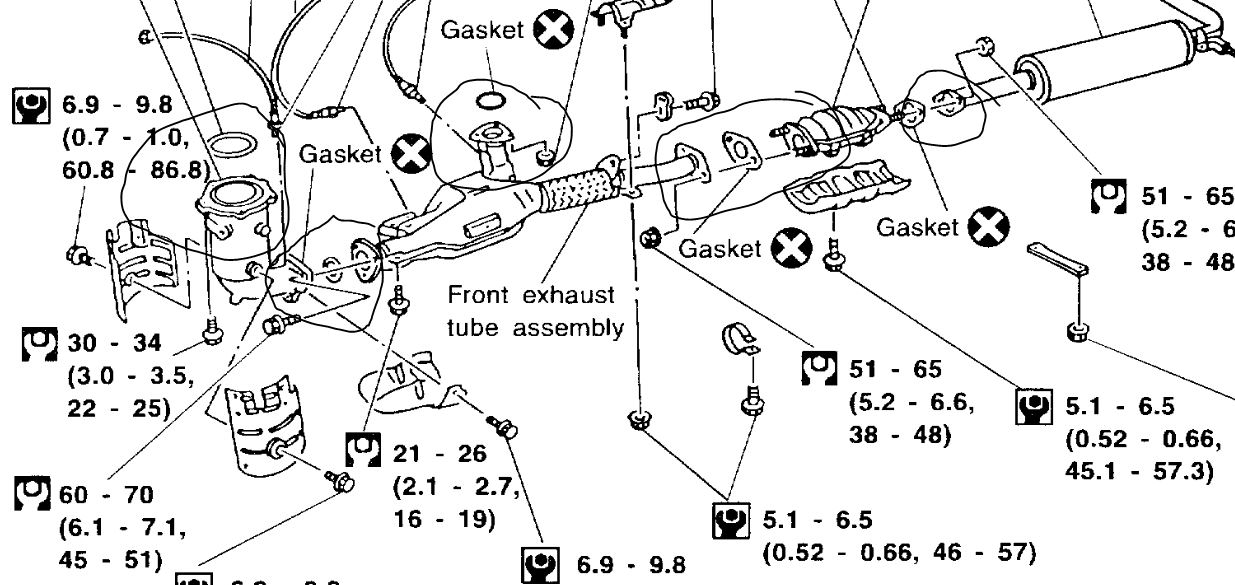

I sent you a diagram already. I attached another one for you to view. I circled the junctions for each converter.
