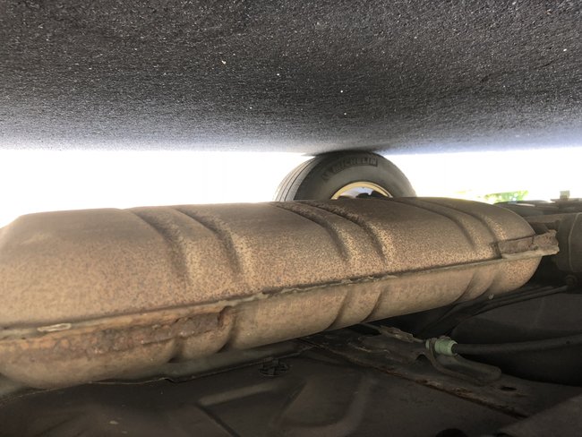

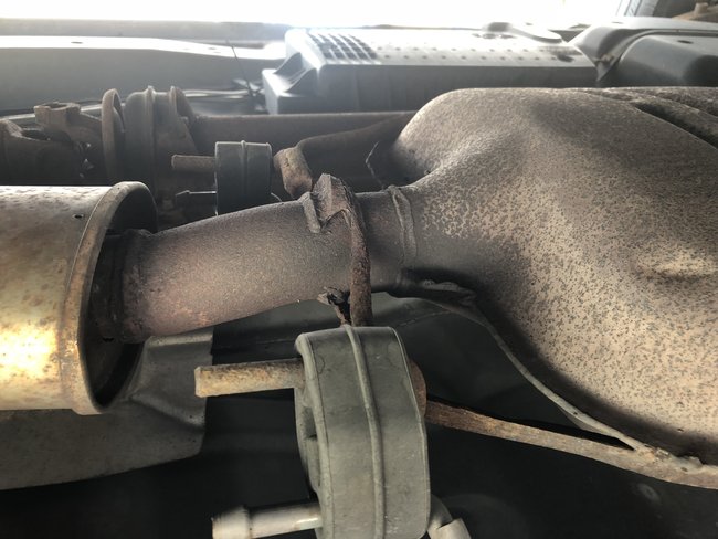

The resonator separates from the car.
As far as the rust. Can you post any pictures?
Jul 20, 2018 at 3:37 PM

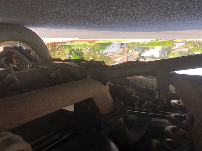

Yes I can. Here I took a bunch.

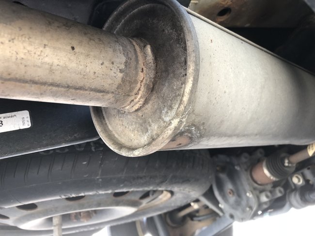

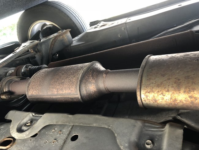

Some more including resonator .

Good pictures.
Yes, it disconnects from the catalytic converter as seen in the first picture. You need to go to another shop and you will get a much better price.
